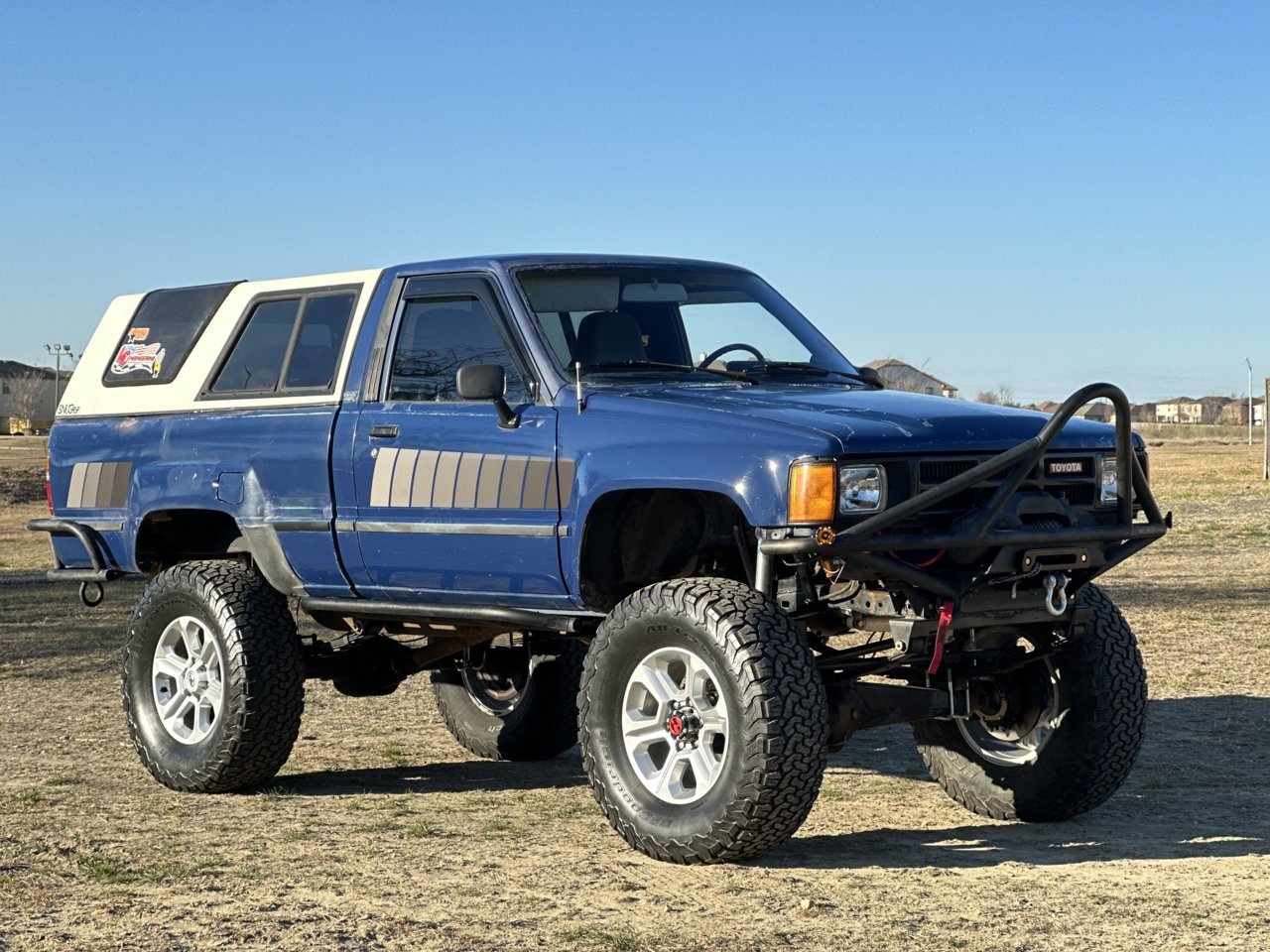

  3. Jan 25, 2023 at 7:17 PM
    ian2016
    ian2016 @shockteq
    Dec 25, 2015
    #173116
    293
    Ian
    Kyle, Tx
    2016 4x4
    Got some classic vinyl put on the other day. I’m really liking how it turned out. Gotta let it cure for a little longer than it’s off to the trails.
  4. Jan 25, 2023 at 8:52 PM
    la0d0g
    Jan 25, 2011
    #49903
    19,907
    running for the hills
    For crawling not hauling
    Love it. That was the color of my '85. Now it's primer gray :D
    ian2016[QUOTED] likes this.
