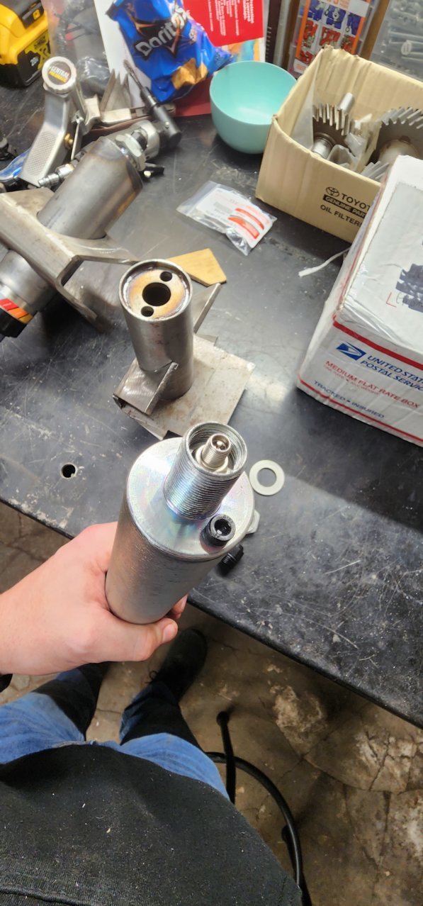

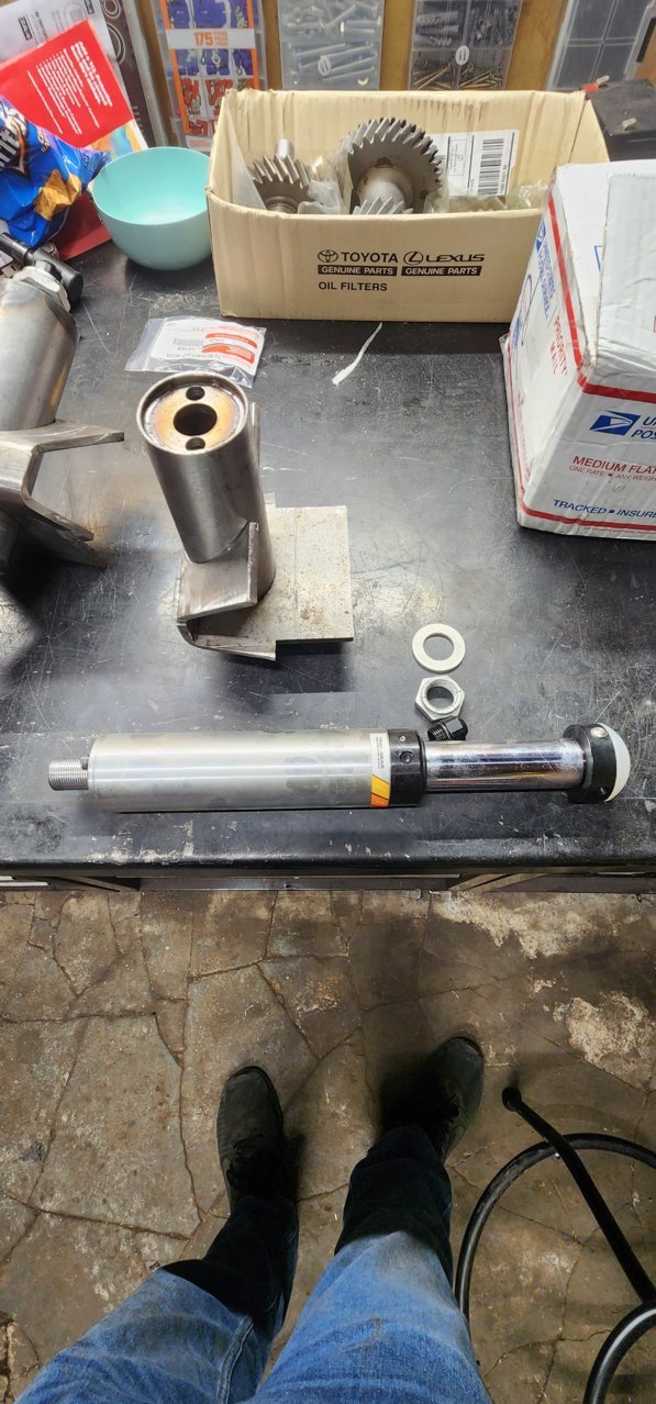

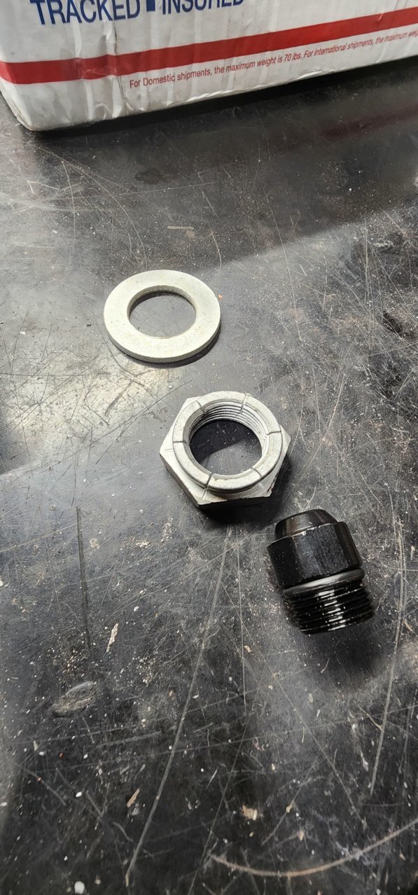

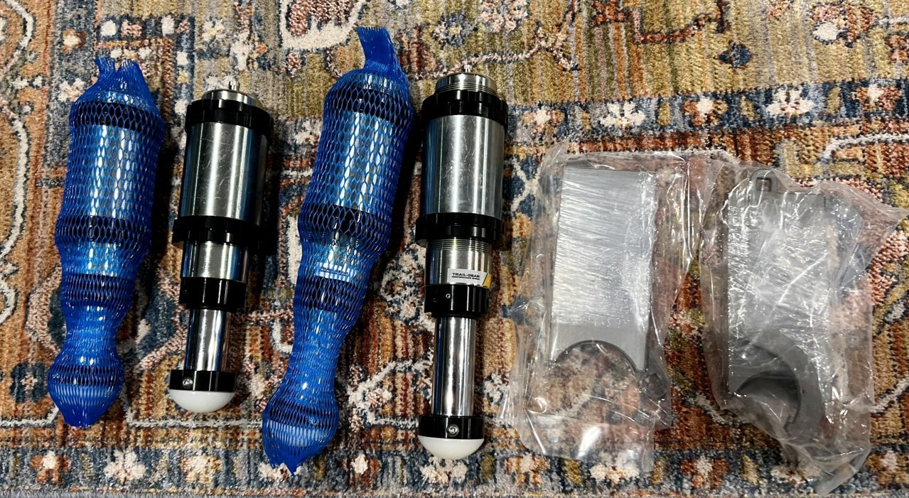

    Mine finally came in, initially pretty impressed. Came shipped quality packaging, no nics and protective sleeves.
    Machined aluminum nitrogen protector with o ring seal, solid thick locknut, came with the bump cans that are tig welded on the top and tapered to fit my retrofit mounts I'm trying to fab up.

  7. Feb 2, 2023 at 3:13 PM

    Im surprised you went 4”, I don’t remember the specifics on your truck but I was only like 4” of uptravel when I was on my 44044 leafs and I’m still only 5” bump on links lol

    Went back and forth between 2" and 4", only went 4" that way I can destroke if I need to, most likely will to 2.5-3.
    I plan on researching and really trying to tune these via nitrogen pressure/oil amount/and stroke limiting.
  9. Feb 2, 2023 at 3:43 PM
    Snowy
    Snowy Is neither here nor there
    Feb 5, 2014
    #122349
    3,455
    Connor
    Winnebago, IL
    3 linked 98 Xtra cab
    Stock-ish
    Duh! I forgot air bumps are super easy to de-stroke. I think Accutune recommends like 25% of total bump travel to be the amount of travel in the air bump

    That's good to know, early threads on these things are all over the map, some running them a hair above ride height and then some using 1" at the very last inch of the suspension cycle.

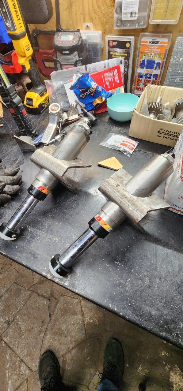

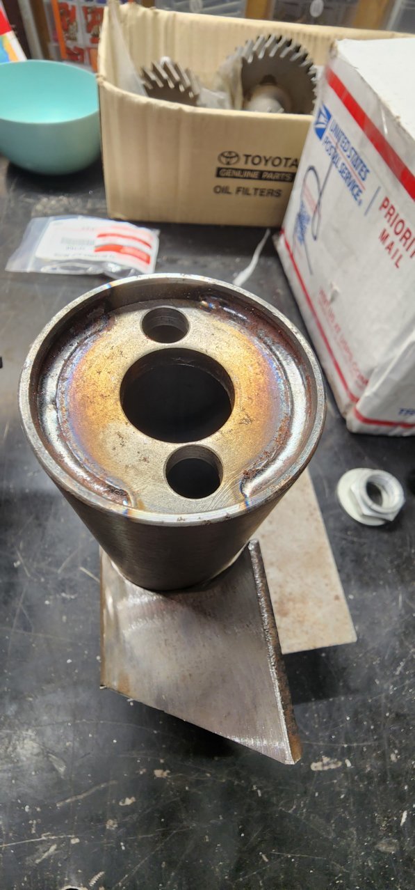

  11. Feb 2, 2023 at 3:54 PM
    Dayman Karate
    Dayman Karate Ruffling feathers and turning eagles into vultures
    Dec 18, 2017
    #238838
    4,719
    Clay
    Central Alabama
    2001 4Runner, JKU Rubicon
    https://www.tacomaworld.com/threads/daymans-karate-class-but-you-wont-learn-nothin-4-link-lt-and-previous-iterations.755134/

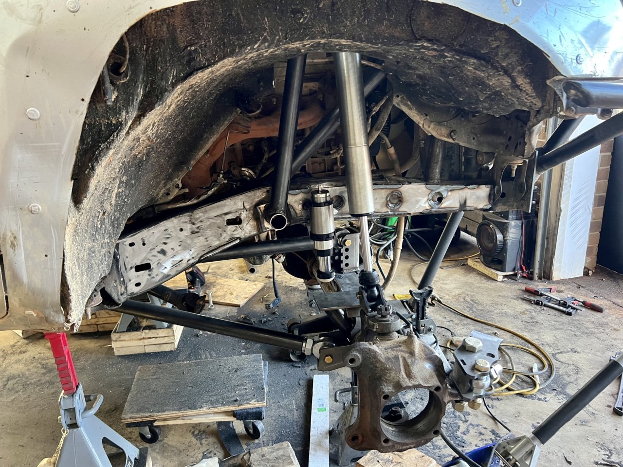

    Nice. I got the threaded body ones, but the 2” don’t have much adjustment. Luckily I don’t need much but getting 4” and limiting the stroke isn’t a bad idea. I went 3” for the rear and have a 10/6 split down/up. Just got my bumps on and pulled the axle out to finish welding and set up hydro. I don’t like the low hanging ram mount so I’m gonna hack it up and move it higher up. Debated doing the Artec ram mount for simplicity but damn that thing is huge.

    I wish these were out when I was buying hydro bumps. I like the threaded top over the slide in. Mine are miserable to pound out once the cans got welded and that was even with a slug in the tubes when I welded them

  16. Feb 2, 2023 at 6:52 PM
    ToyRyd04
    ToyRyd04 Taco Transformer
    Aug 5, 2011
    #61217
    1,861
    Greg
    Perryville, MD
    '04 PreRunner
    SAS'd PreRunner Diamond Axles Crawlbox
    I'm hoping it will package well in between the typical Toyota sas shock hoops that most including myself run. I narrowed the mounts so that it will fit centered and close enough to the frame so that the bumpstop striker will hit the ubolt plates almost straight on.

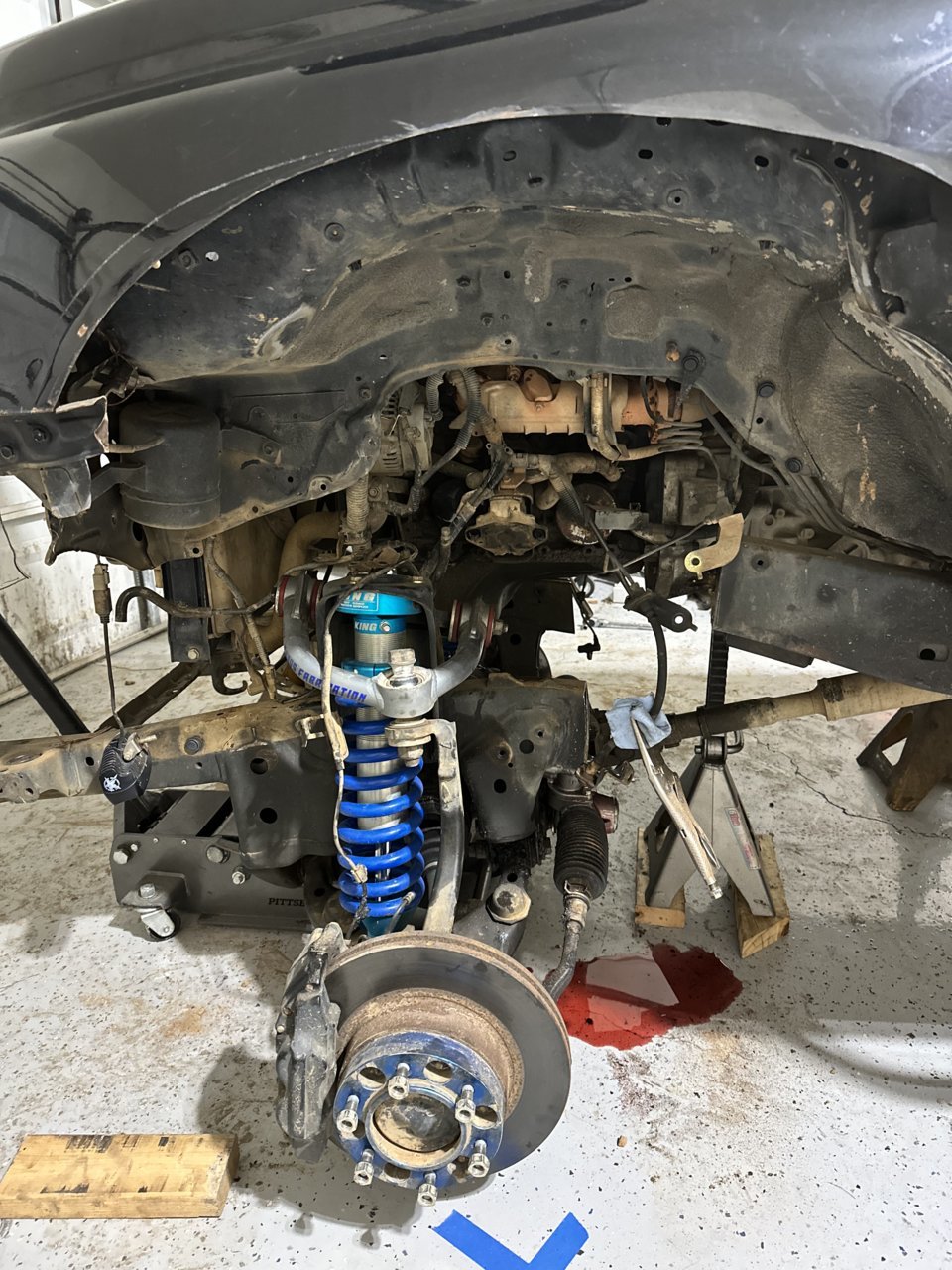

  18. Feb 6, 2023 at 2:47 PM
    J88logue
    J88logue NorthWest Member
    Jan 3, 2012
    #69877
    5,434
    Johnny
    HWY 30
    02 D.C. TRD
    Clicko BUILDo
    Sadly still trying to figure out the issue with my newly sas tacoma. Last weekend i parked it in the shop, no front driveline and went forward/reverse with all seemingly normal (auto trans). Put the trans in neutral, t case in 4 low, put trans in Reverse and the whole front end rapidly sunk/dove down quite a bit. Put trans back in neutral and truck seemed to settle, put trans in drive and the front end lifted up rapidly. I get that in low range there more torque thus exaggerating the movement. But what's causing the movement, perhaps geometry is off re. anti dive/squat?

  20. Feb 6, 2023 at 4:26 PM
    slander
    slander Honorary Crawl Boi
    May 10, 2013
    #103909
    8,964
    Hickory, NC
    02 Tacoma, fixed with curse words.
    I had a friend's jeep on radius arms that would do that, I forget what it means. Does it drive fine? If so I wouldn't worry about it.
