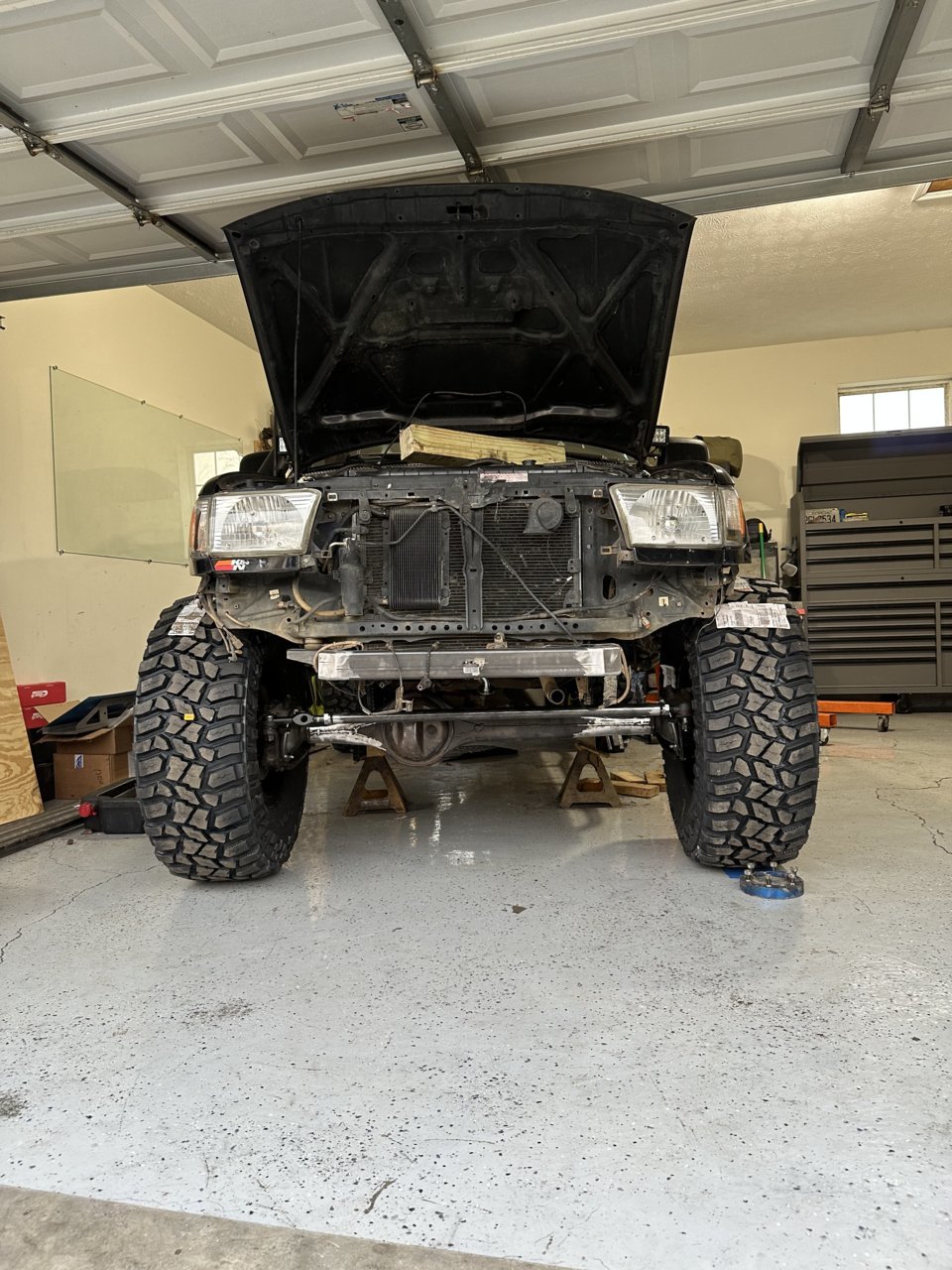

    Current plan for the crossmember is to shoot some 2x3 box across under my eco-crawler, use 1.5” box to reach forwards and backwards to my trans and tcase, and integrate my lower link mounts into / onto the 2x3.

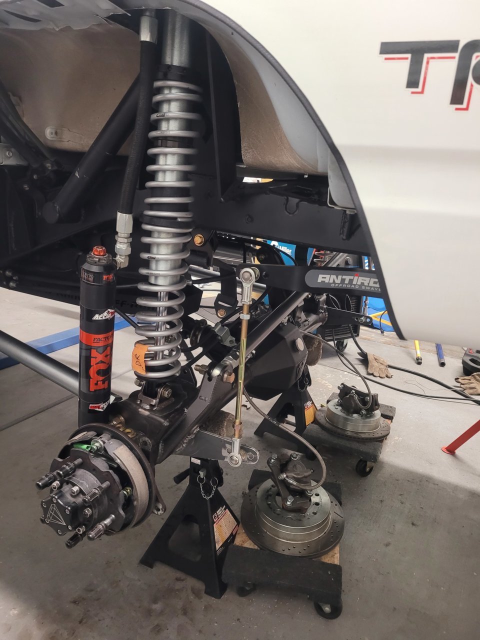

    That's a Ford Dana 60 king pin and sterling 10.25. I put some new seals in and did the disc brake conversion on the rear. Bearings seemed fine so I repacked the front and slapped the rears back in for now. 5.13 gears are also in good shape so left them alone. I'll build the axles more as I wheel it, just want to get them under the truck for now

    Several companies sell single sided rams for hydro assist. It came with the axle so it's gonna work for me. Only thing with a single sided ram is that you'll get less force in one direction.
