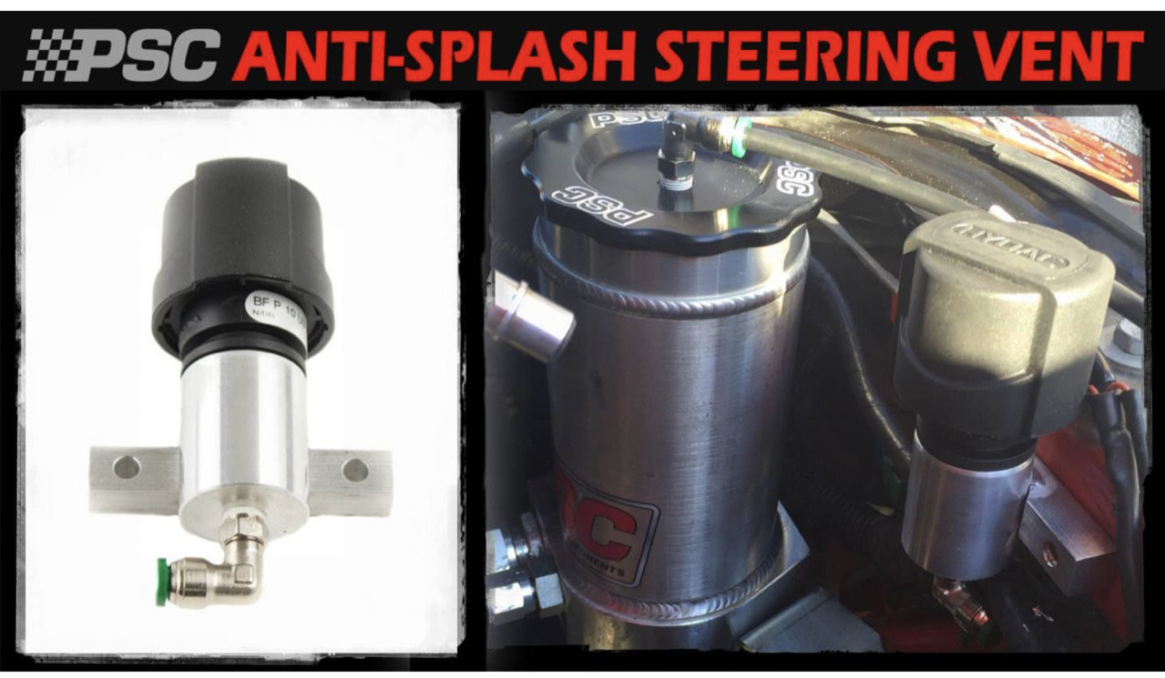

    @Snowy did you mention something about venting your PS resi a while back? My PSC came with a threaded hole in the cap and a push fitting to screw in. Not sure if their $85 vent is worth it or just throw a fuel filter or something on it.

    I run the PSC pressure check valve to reduce cavitation at high RPM. I noticed a marked improvement on my most recent trip out with it compared to venting to atmosphere

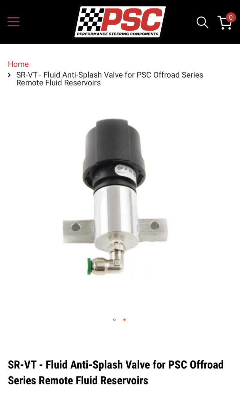

    Nice. This one? Looks like it keeps a constant pressure to keep dust out, too.

    Yep, that’s the one. There’s a Donaldson filter/check valve that works too but I wanted to hit the easy button and just have it work

    Thanks, just ordered it. Cheap insurance for all the expensive stuff.

    Got the same things, works, threads in perfectly. Just make sure that hard plastic tubing they provide to you is cut square to get a good seal on that push fitting. Dont know if it matters, but thats the highest point in my system.

    I’ll have the resi a couple inches from the hood, not sure if this needs to be higher or just right there with it. Looked like they mounted at the same height in a picture online and the tube might have even gone lower.

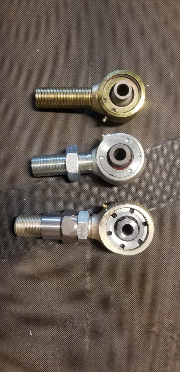

    Dayummmm. These Enduro joints are pure beeffff. Excited to start mocking things up

    Look like the Johnny Joints
