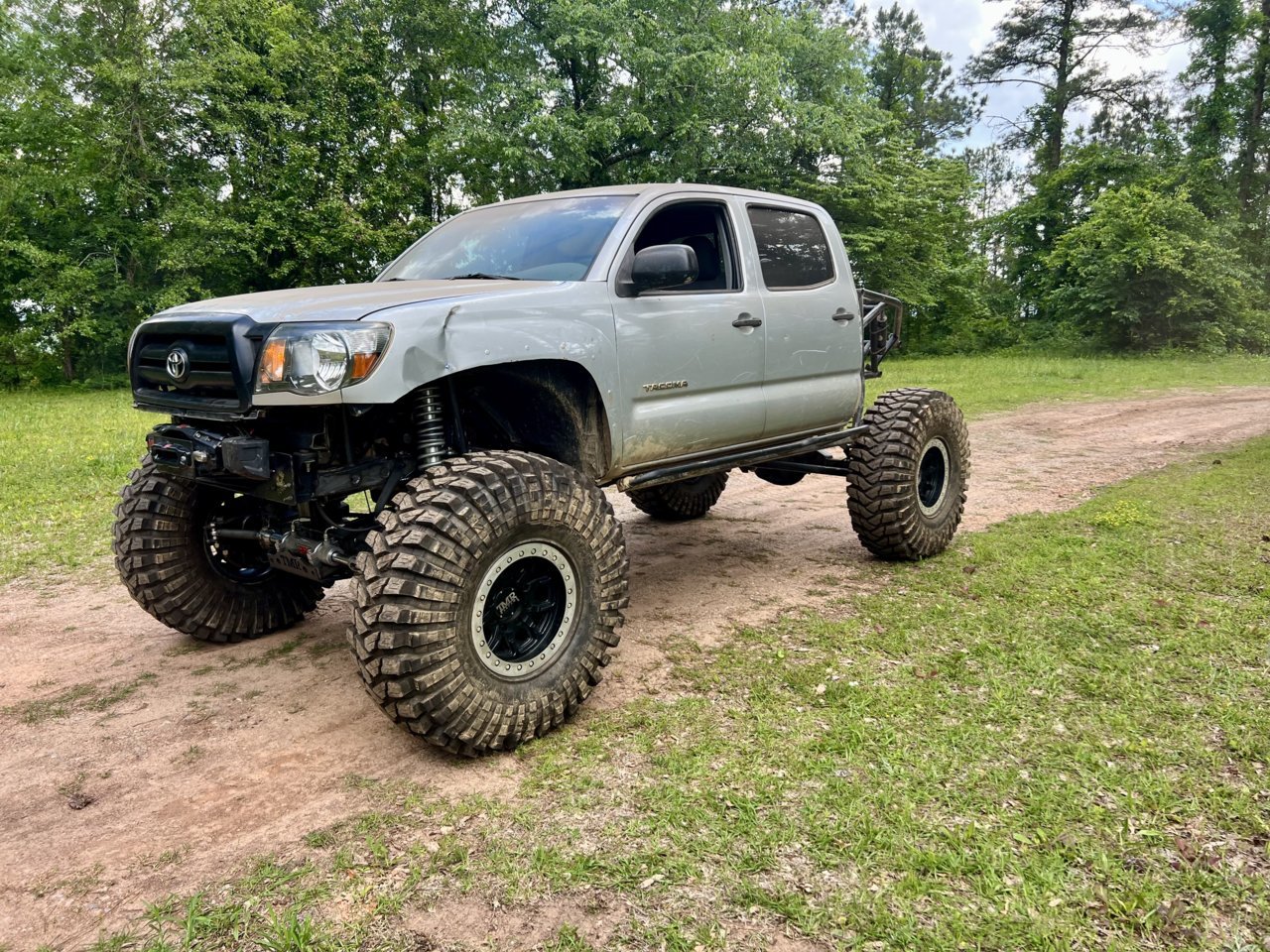

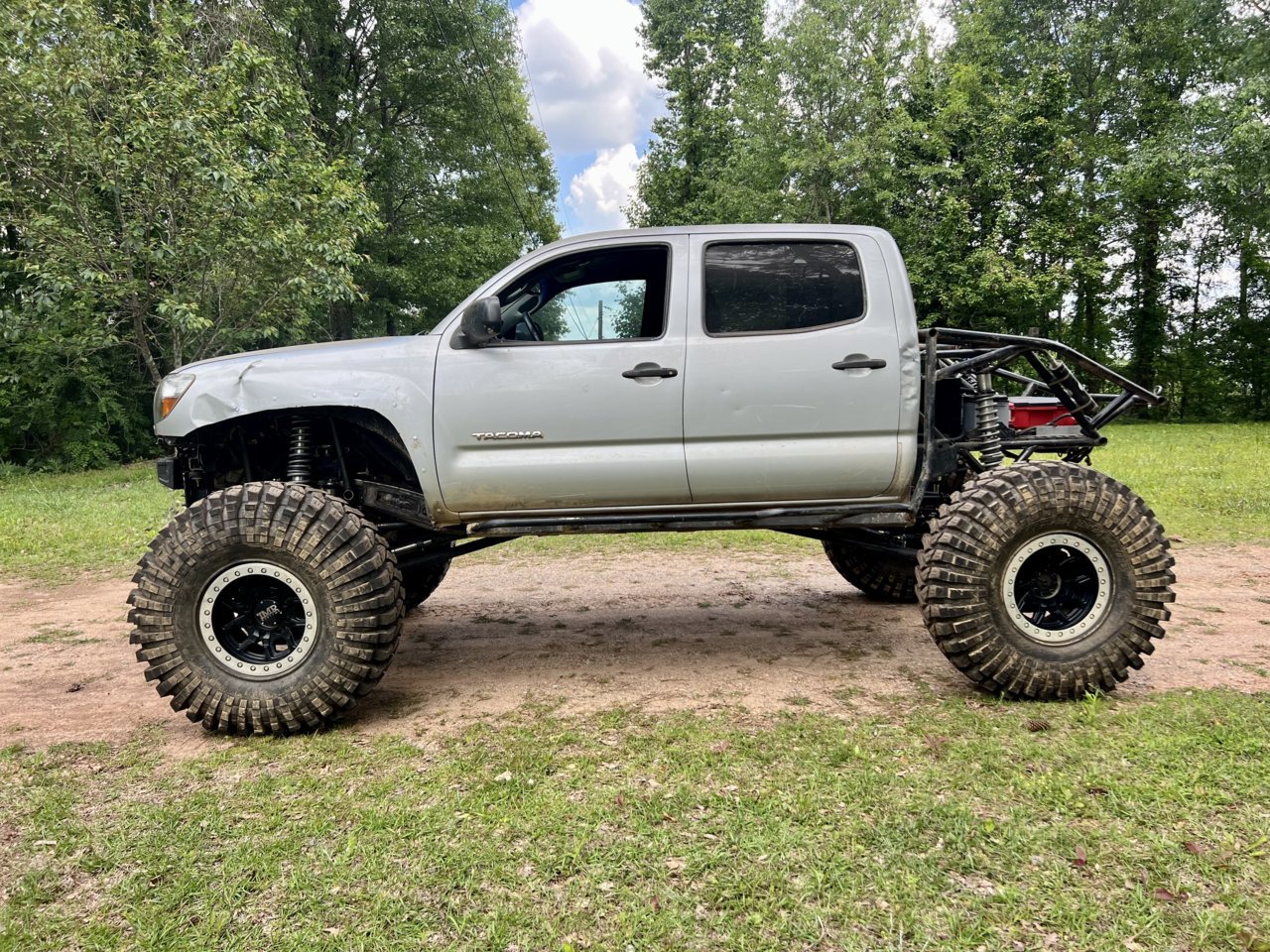

    Finally out of the garage. Took it for a short trip in the woods and walked shit I used to struggle with on 37’s. Sitting a couple inches too tall and some other piddly things left to wrap up, but so glad it drives lol

    Always a good feeling driving it out of the garage!

    Good feeling when it fit going out of the garage and stopped when I hit the brakes :rofl:

    For crawling not hauling
    Let's see some flexy sexy shots!

    No doubt! Coming soon
