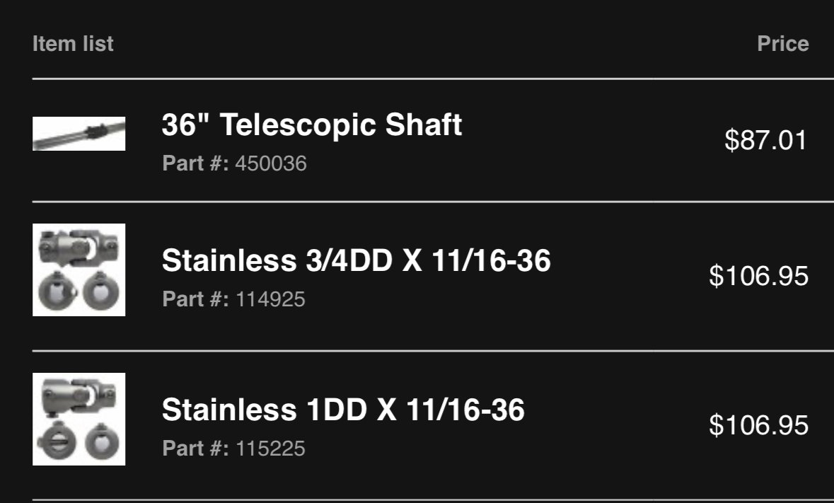

    Anyone have the borgeson part numbers? I see different part numbers all over this site.

    @Kerleyfries probably does since he just ordered his steering shaft recently.

    This is to go from OE steering column to an IFS steering box on my 98 4runner. I took about 8” out of one side of the steering shaft which put me right in the center of the travel of it. That way it has some stretch but will also collapse a bit if I wreck.

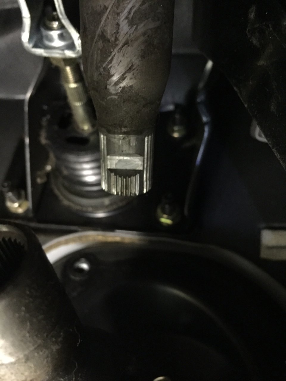

    I don't think Borgeson makes a u-joint that can fit without some kind of modification. My steering shaft (99 4Runner) on the steering wheel side is keyed, the only plug and play u-joint I can find is the one from TG. Gotta bust out the dremel I guess.

    I ground on mine a little bit and it slid right on. Taking out those two spots won’t effect anything.
