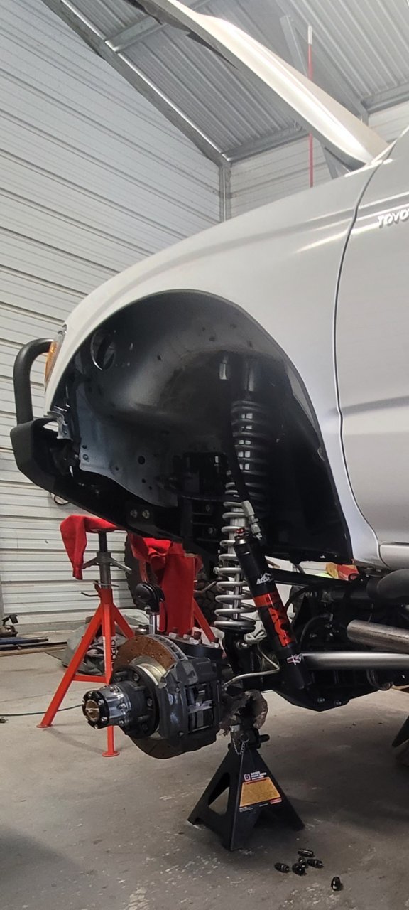

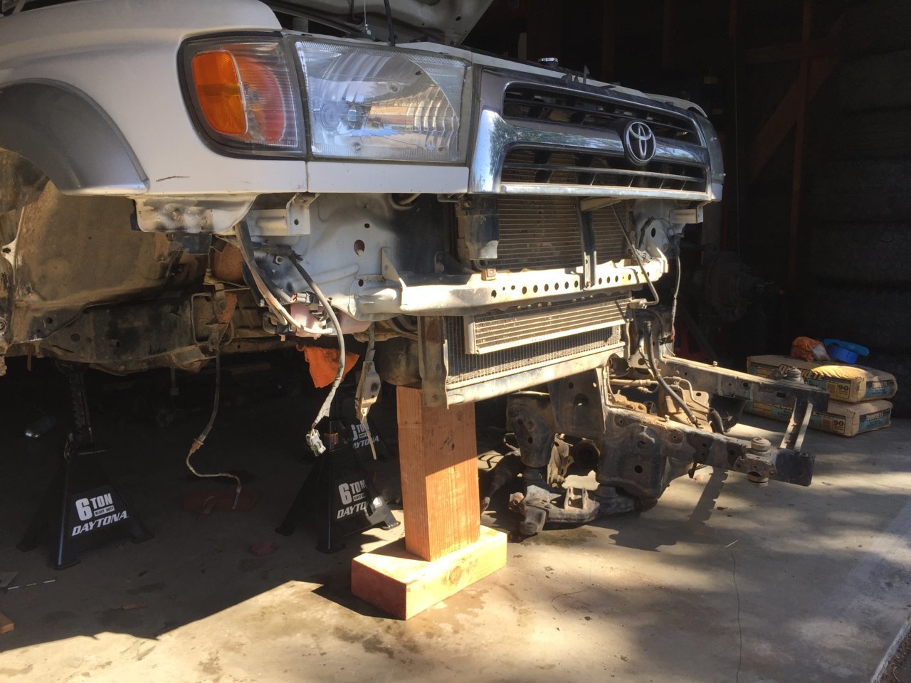

    3rd gen 4runner on 2004 Superduty axles, here's what I'm building mine to:
    24.5" frame height at ride height
    40" tires
    5" of actual up-travel (when both bumpstops bottom out, 6" of shaft showing on coilovers at ride height)
    No body lift
    No engine lift

    I want to see your progress... it's hard to keep a low profile and still get 5" of uptravel without mods to the frame or engine/oil pan

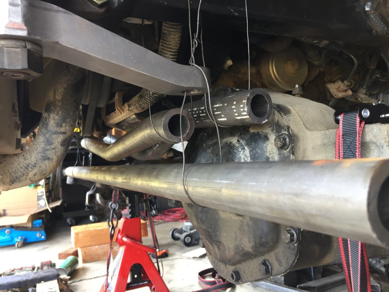

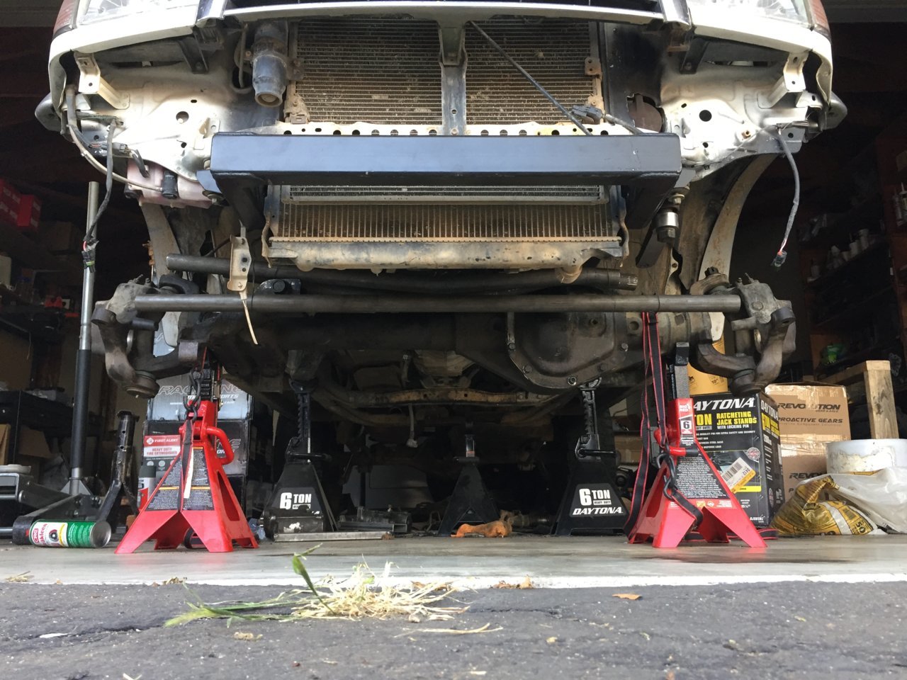

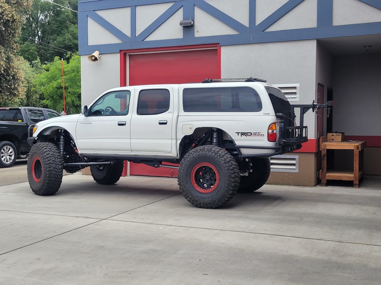

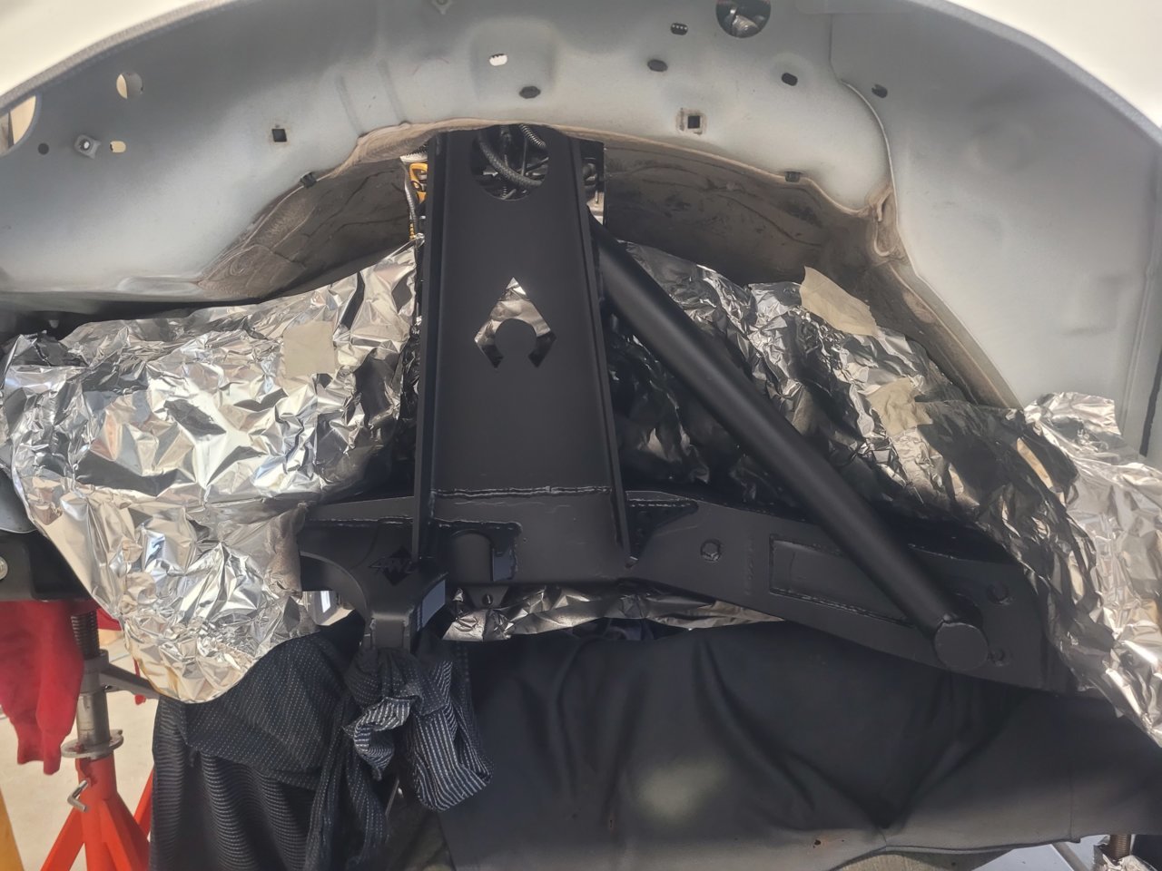

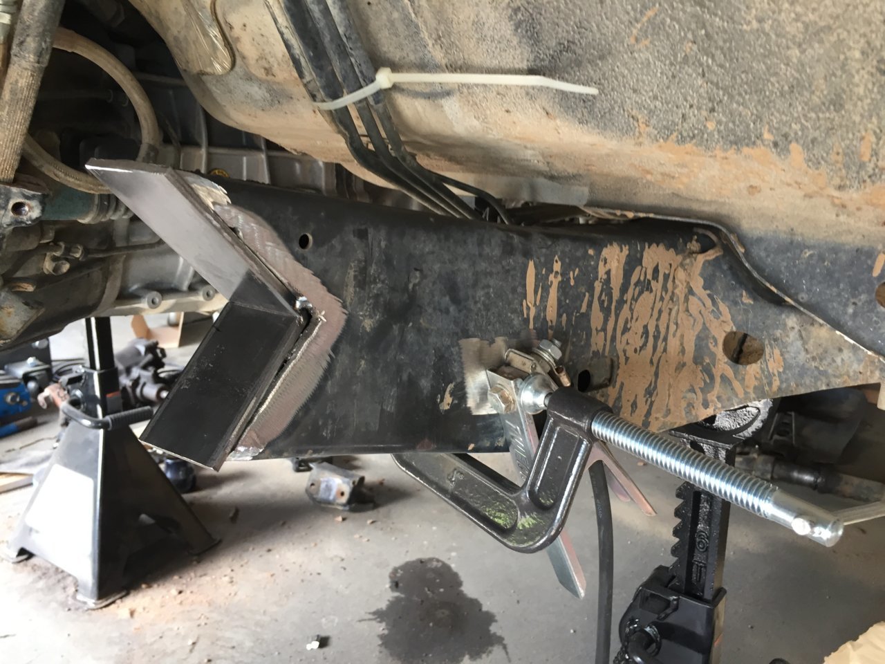

    @02hilux See photos below. For the photos with the axle under the truck, the axle is at ~1/4" below full bump. This week I'm working on the axle brackets/truss. I just ordered all my Johnny Joints / rod ends so now I'm waiting on those. I'll start a build thread soon, though I want to make a little more progress first.

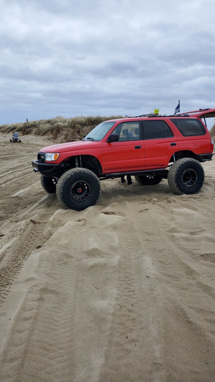

    1st gen but 23 in frame height and 6.5 inches of useable up travel. I found 23-25 is my happy place for frame height For stability to bottoming out on stuff. 40s helped a lot to solve that though.

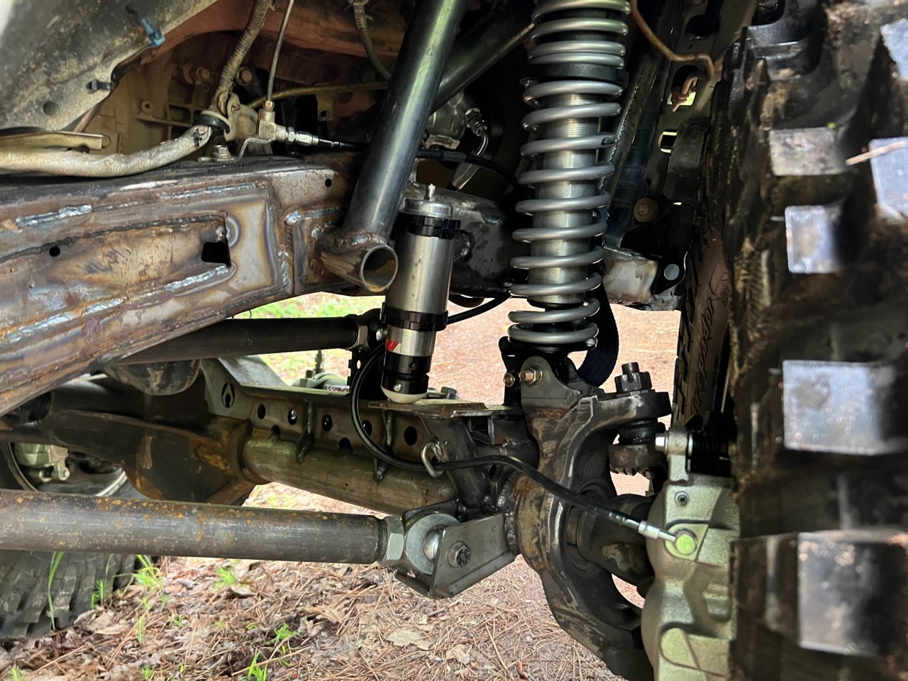

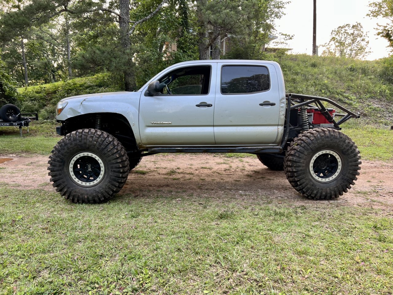

    Same here. This is what mine looks like one tire stuffed. I’m strapped at 12” so the rubber shaft bumper would compress fully if the other side was able to droop fully to 14”.

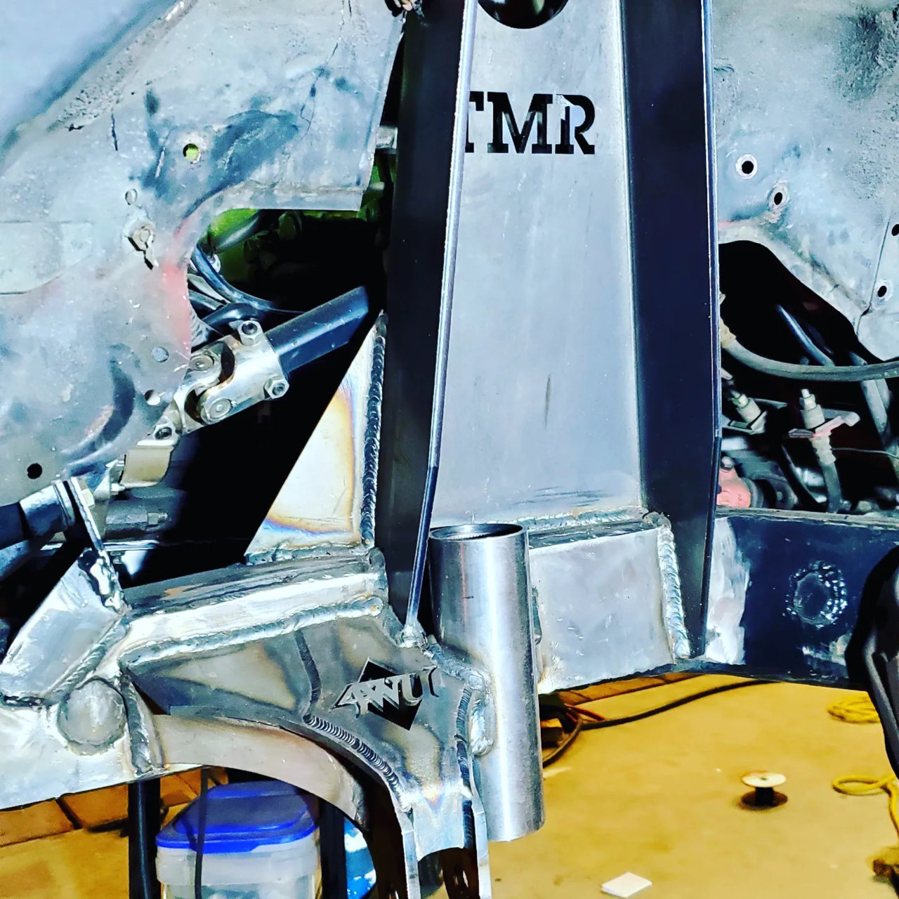

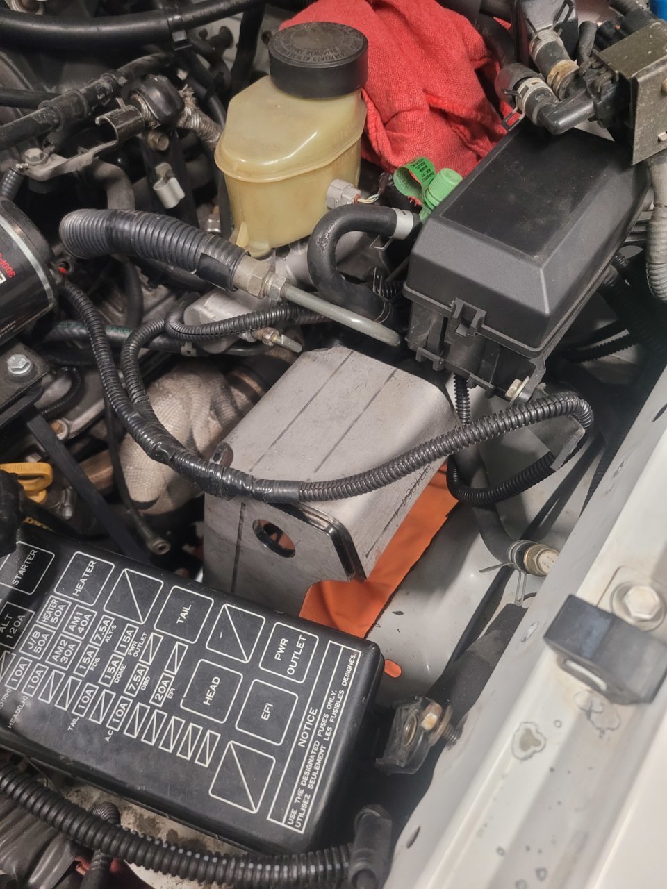

    3 gen 4runner 24.5" frame height on 39", 4WU front 3 link and 57" rear leafs. 5 inches of up travel, had to raise engine 1.5 inch and modify oil pan for up travel.

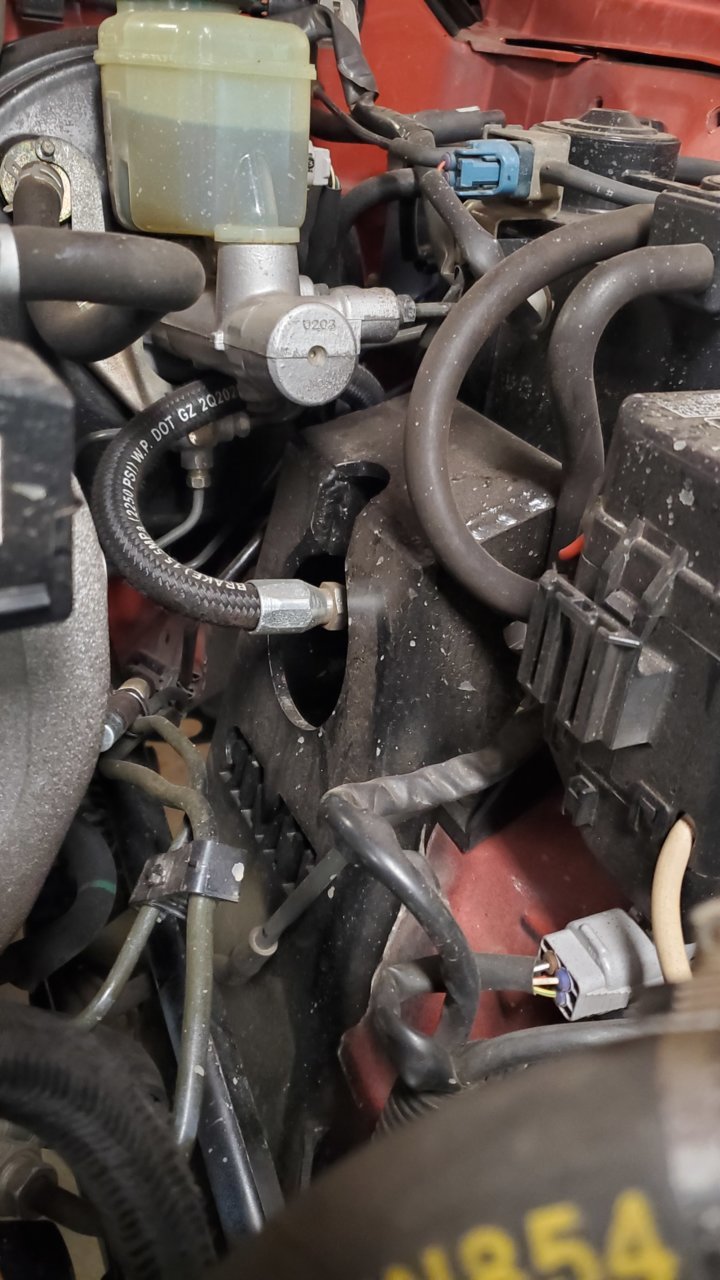

    1,815
    12" C/O?
    Any pictures of your tower mount location?
