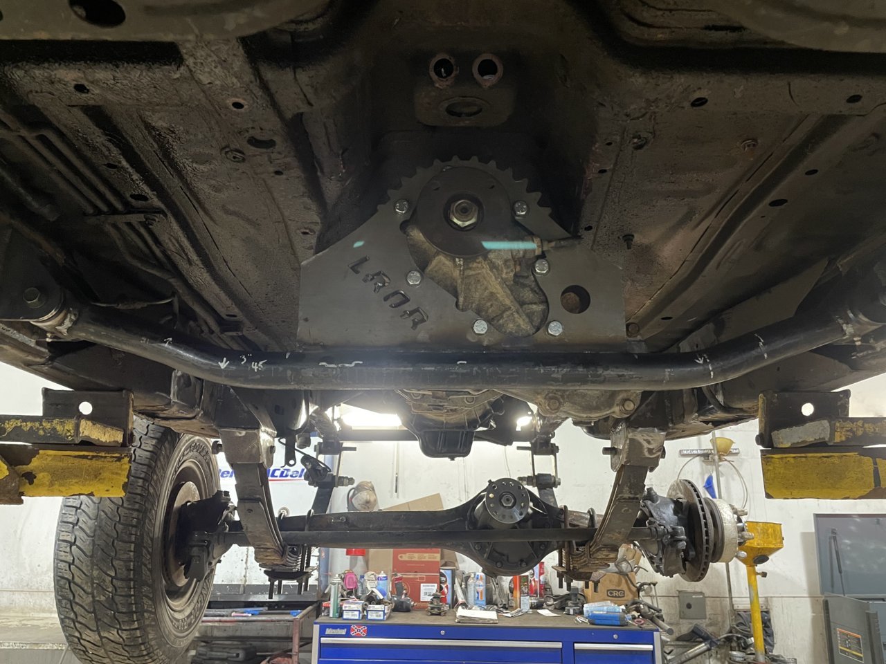

    I held back judgement dropping a 2nd gen taco cab onto an 85 frame and desecrating that frame, but I see the SUA and shackles forward and now it's interesting! Post more pics and details as this progresses!!

    80 series front housing
    Spring over made it huge original plan was 80 series radius arms but coils hit the frame (too narrow)

    That's what I originally thought too. My first thought was like "oh no if that's a mini truck axle it's gonna turn into a banana in no time" :laughing:

    80 series radius arms and coils would have been dumb anyway, that is if you were actually going to wheel it.

    Basically just an overbuilt camping truck, dual cases with 4.7 in the rear case. 5.29s in the diff. Oem cruiser suspension would have been nice, links would have been nicer. But I don’t have a link suspension wallet currently.

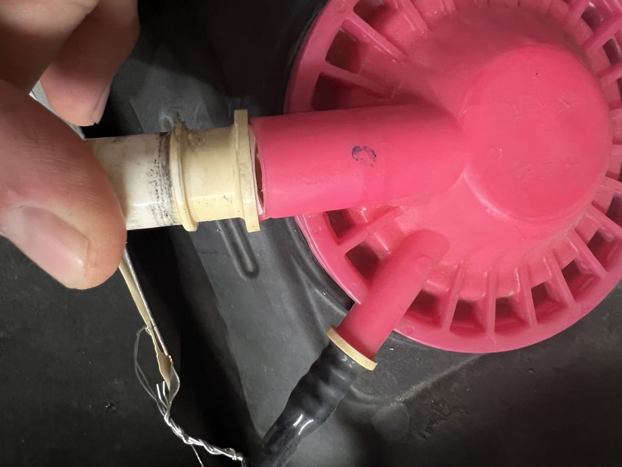

    Anyone removed the pink vent cap things from a gas tank? Im replacing my tank and the new used one is cracked, so if possible, I could swap the old vents on to the new tank. They look to be sealed with some hard plastic or sealant.

    I think those fittings are fused to the tank. Any chance your used tank can be returned?

    Need more info what type of vehicle/tank is it and what hoses are those?
    If it's the part I'm thinking of a first gen Tacoma, not pink, it's press fit into the tank and held in with a gasket. I snapped one of hoses off and was able to get a new assembly from Toyota.

    Its a 2004 4runner, but the 2nd gen tacos have the same setup, and the vapor vent thing that goes to the charcoal canister. I don't think it is serviceable but was hoping someone has another idea.

    If you can't find it on Toyota parts deal or some site like that, If it was me I would try to pry the already broken one off the tank and based off that see if you can swap it. If so seal it with some RTV. Or slather the broken tube with jb weld and see if it throws codes.

    I have a second gen tank sitting in the yard you’re welcome to have anything you need off of it. Sender is gone. Just let me know.

    Thanks for the offer, I am going to just return the broken one (cracked during shipping) and get another one.
