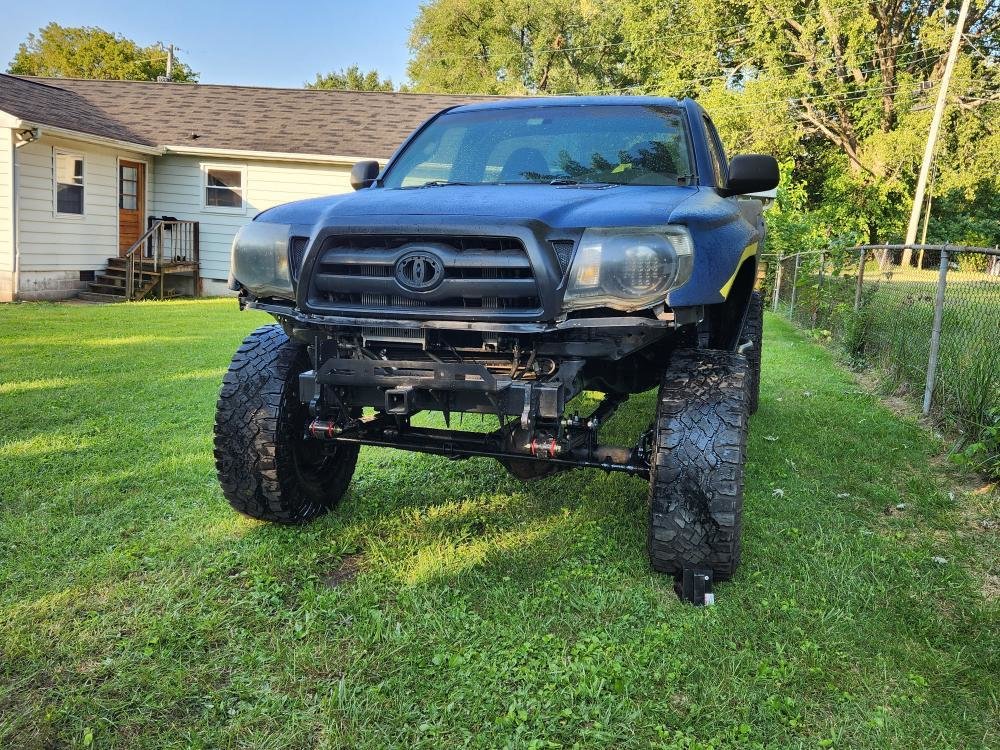

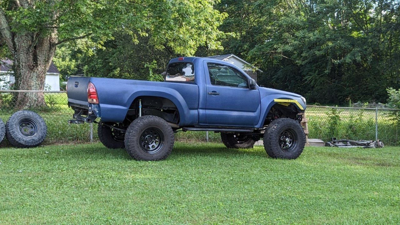

    V8 Solid axle swapped 5 lug
    Got a lot of stuff lol
    It's a roller now. Still got plenty to do mainly steering.

    You did the stealth mode solid axle?
    Fernando[QUOTED] likes this.

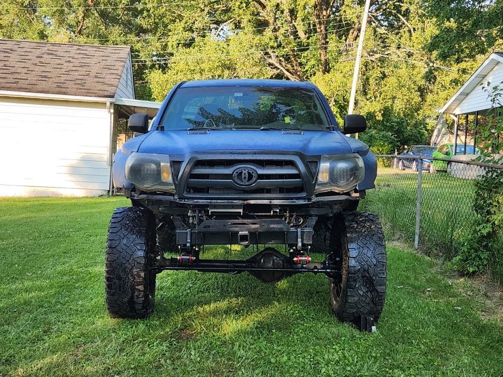

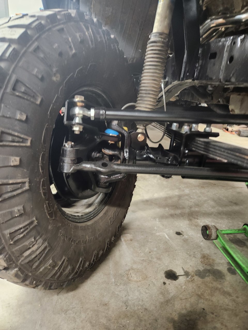

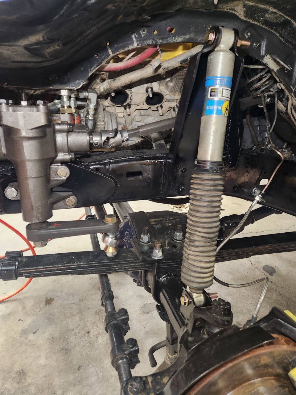

    Got the steering done. Should be test driving soon.
    With 315/75/r17 (34.4") duratracs ended up with just shy of 22" of frame height
    02hilux, Wulf, sparkystaco and 4 others like this.

    8,964
    Hickory, NC
    02 Tacoma, fixed with curse words.
    Good job putting the shackles on the correct end!!!

    Ahhhh another fellow man of taste. Realistically I didn't want to french my frame and it gives me more room for steering.

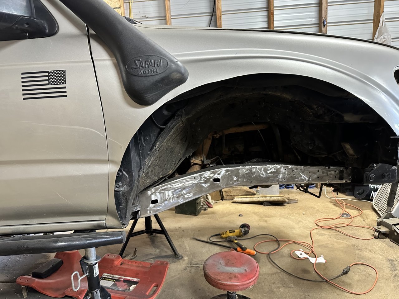

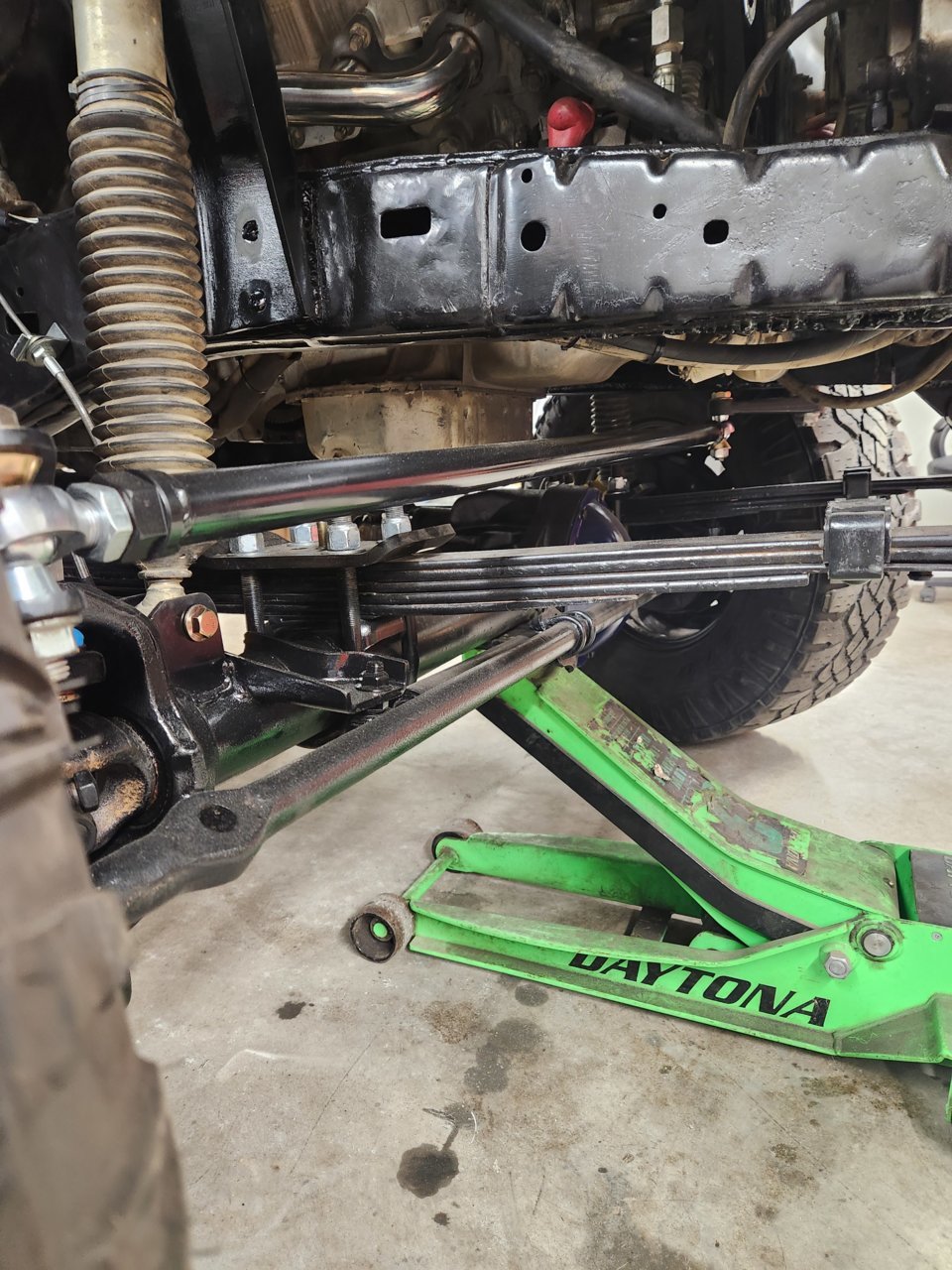

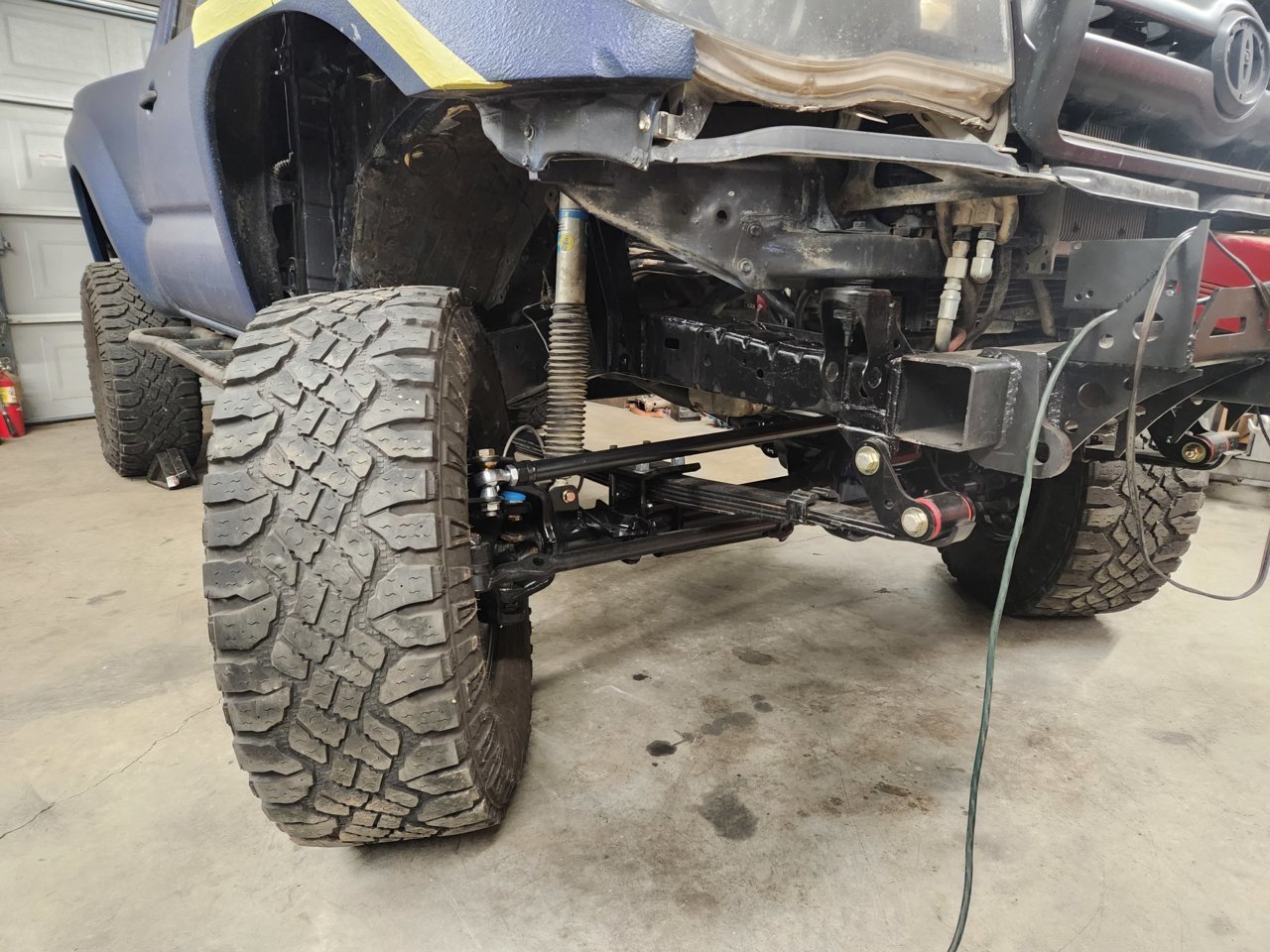

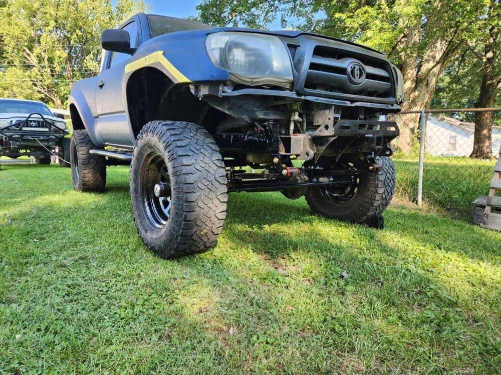

    Starting something new… got asked to do a 4wu kit on this red 4door with bypasses and coilovers and an engine cage. See how it goes.
    currently has a wfo kit
    For the most updates if your on Instagram, follow @hambone_fab_works

    No complaint on my front and rear 4WU 3 link.
    My recommendation, stay leaf spring for less routine maintenance :annoyed: and definitely cheaper for the long run. @malburg114 you know how that go.... :hattip:

    So far I’ve only unpacked it and I’m missing 2 misalignments and need another right hand 7/8 heim. And absolutely no instructions or info on what to cut on the superduty axle or where to place the link brackets.
    I imagine this will just end up similar to mine with fancy brackets that are already made. But I’m staying optimistic on it
