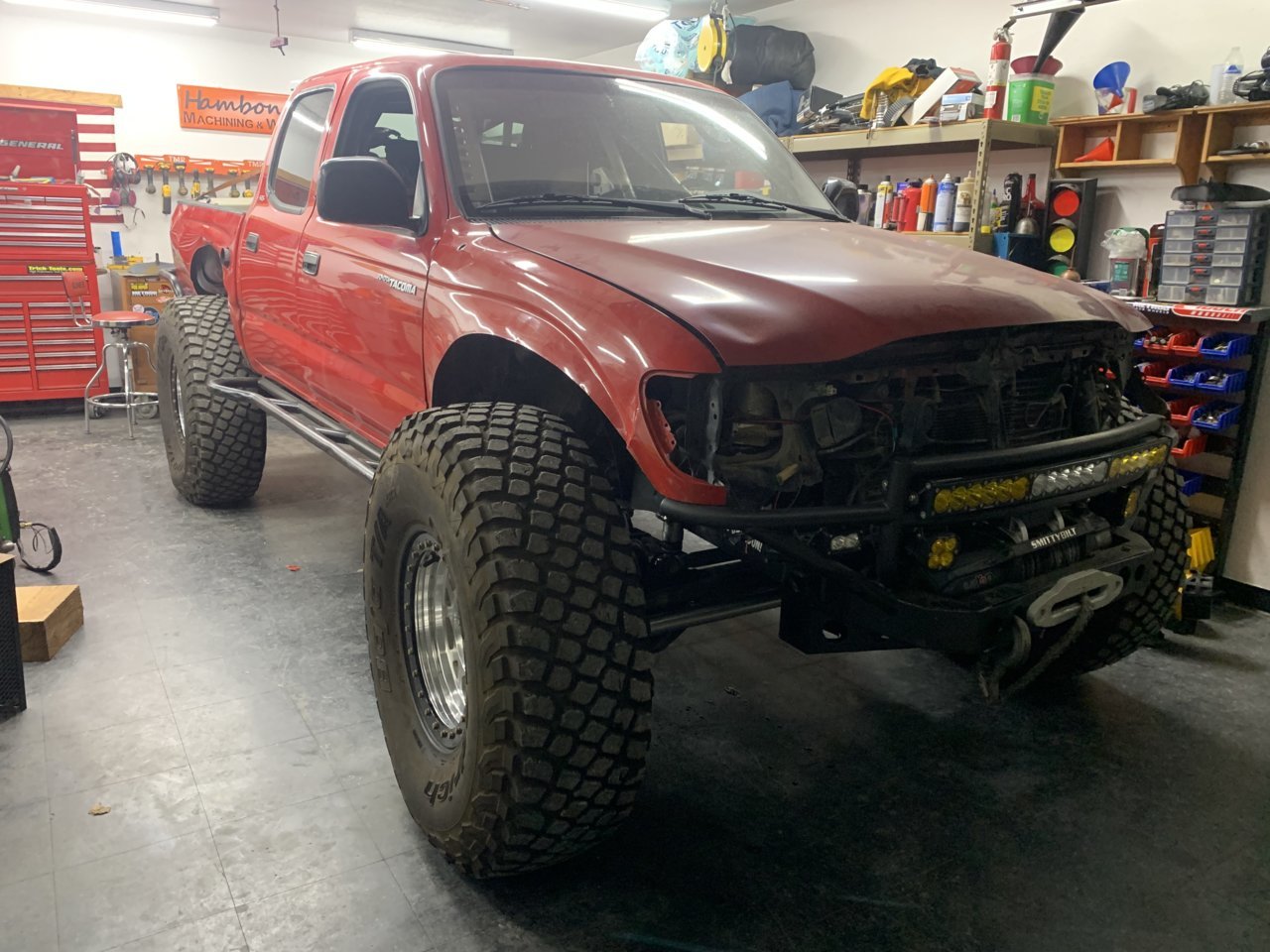

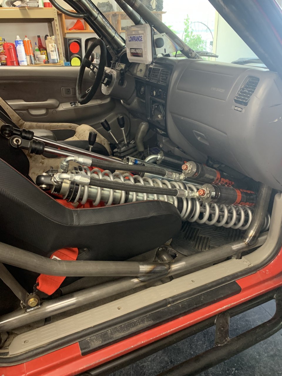

    Curious why he's going away from the WFO kit. Truck looks great. I've contemplated swapping to the 4WU but don't see the cost vs benefit to be there. is that a custom interior cage? whats his tcase setup? Is that a radiator guard in the front??

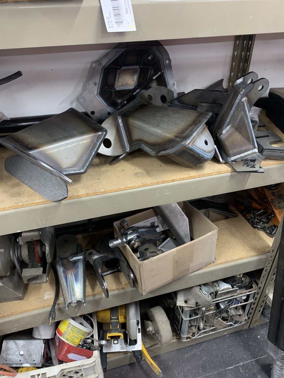

    I priced out the kit when I was making sure I had all the parts and before shipping it was roughly 4500 dollars. He wants to add bypasses which was the main upgrade and more flex. I wheeled with him at sand hollow and thought the thing flexed well and he did pretty much everything I did. I wish it had shocks so I could go to the place I test mine to see how it compares.
    yeah cage is by sloanmotorsports on Instagram. He was supposed to do the 3 link but just had a horrible accident and the family needed to clear his shop out so that’s how I got called.
    tcase I forget. It’s got a crawl box though but don’t think it’s Toyota stuff. Stock 3.4 though with the a340.
    Front is just the bumper. I’m doing an engine cage on it as well
