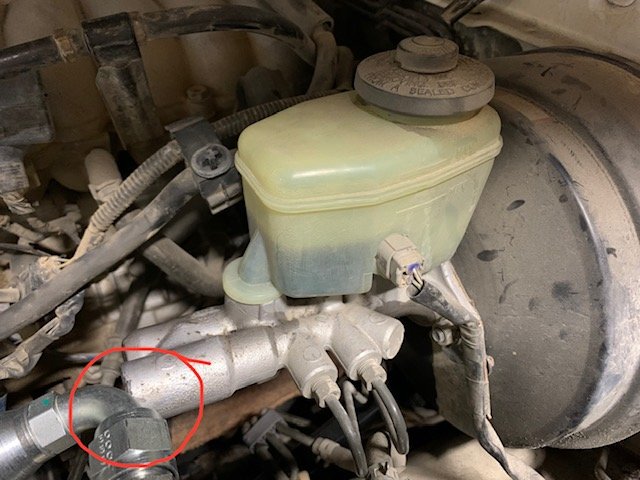

    Have the fitting face outward instead of towards the engine bay, is that an option?

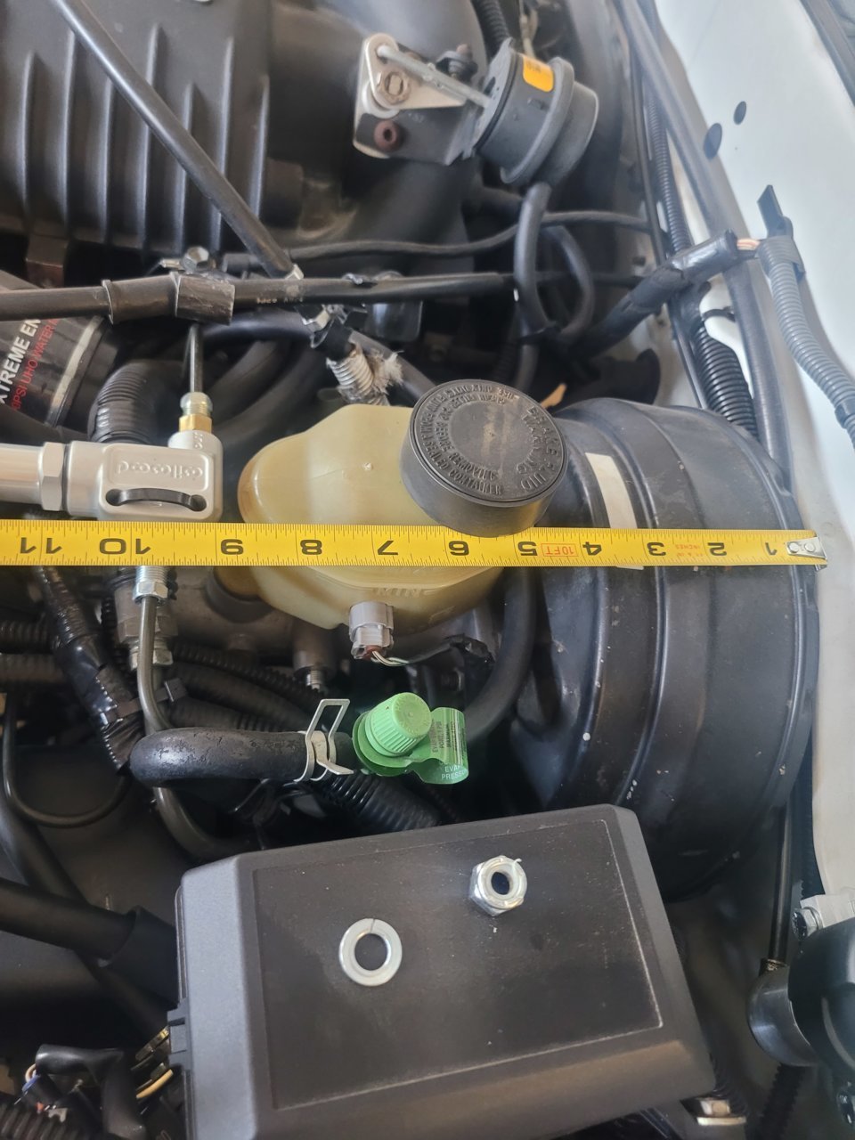

    I think the early first gen Taco with 1" MC should provide you with the clearance you need. But it's a 4 bolt MC so you'll need a booster as well.
    I'll measure and let you know

    Not a 1t t100 but from an early first gen Taco. Not a clear picture but overall, look between 10.25" to 10.50"
    If you want, I can get better measurement later. I have a 3rd gen 4r booster/mc too that I can somewhat compared it with

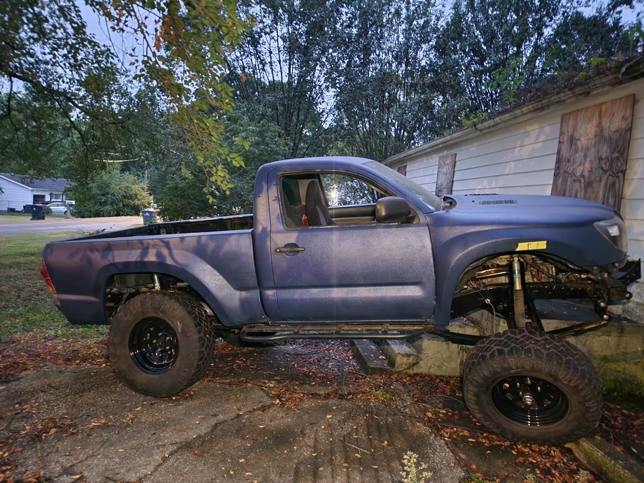

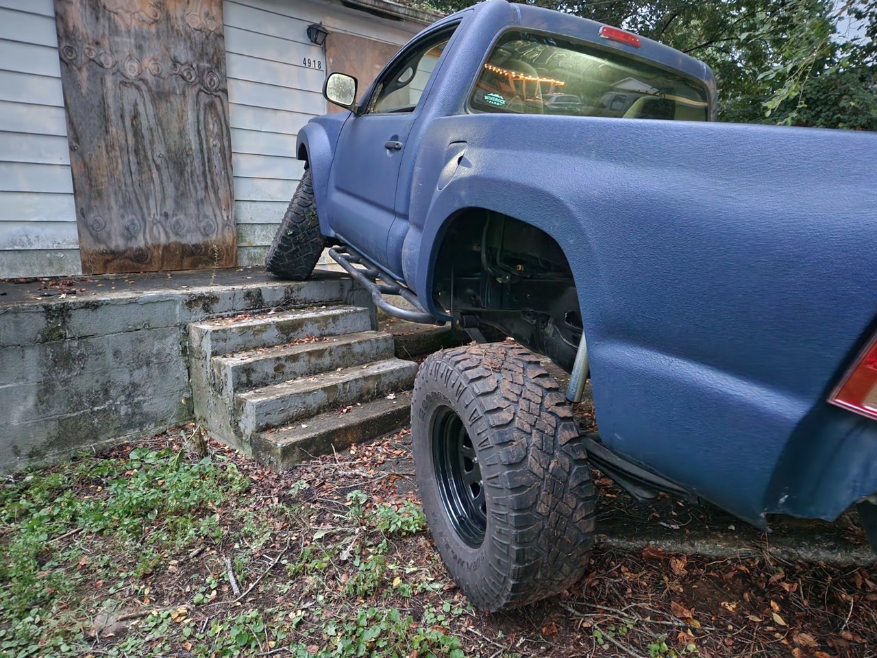

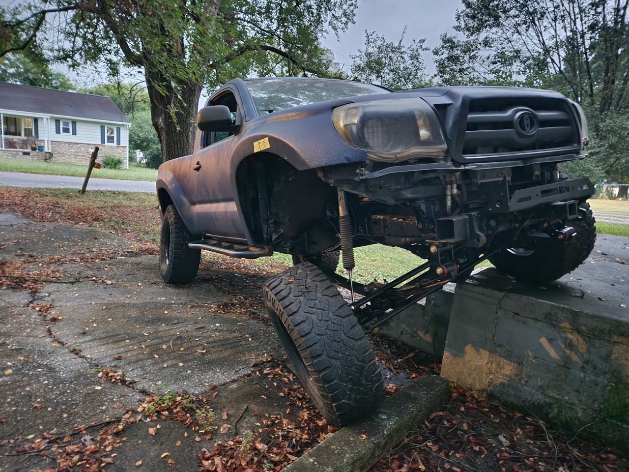

    Started my 4Runner and drove it (albeit 20 ft) today for the first time since June last year. 16 months into my “3 month project” and I’m half way done.
    No brakes, no front driveshaft, no diff/axles, nearly everything in the engine bay needs to be relocated, but at least it can move on its own power.
    It’s sitting pretty tall right now with the coilovers at 7-7/8” of shaft showing which is 1-7/8” more than desired at ride height but I imagine after some settling and adding a winch/bumper it should be close to where I want it, so I’ll keep the preload as-is for now.
