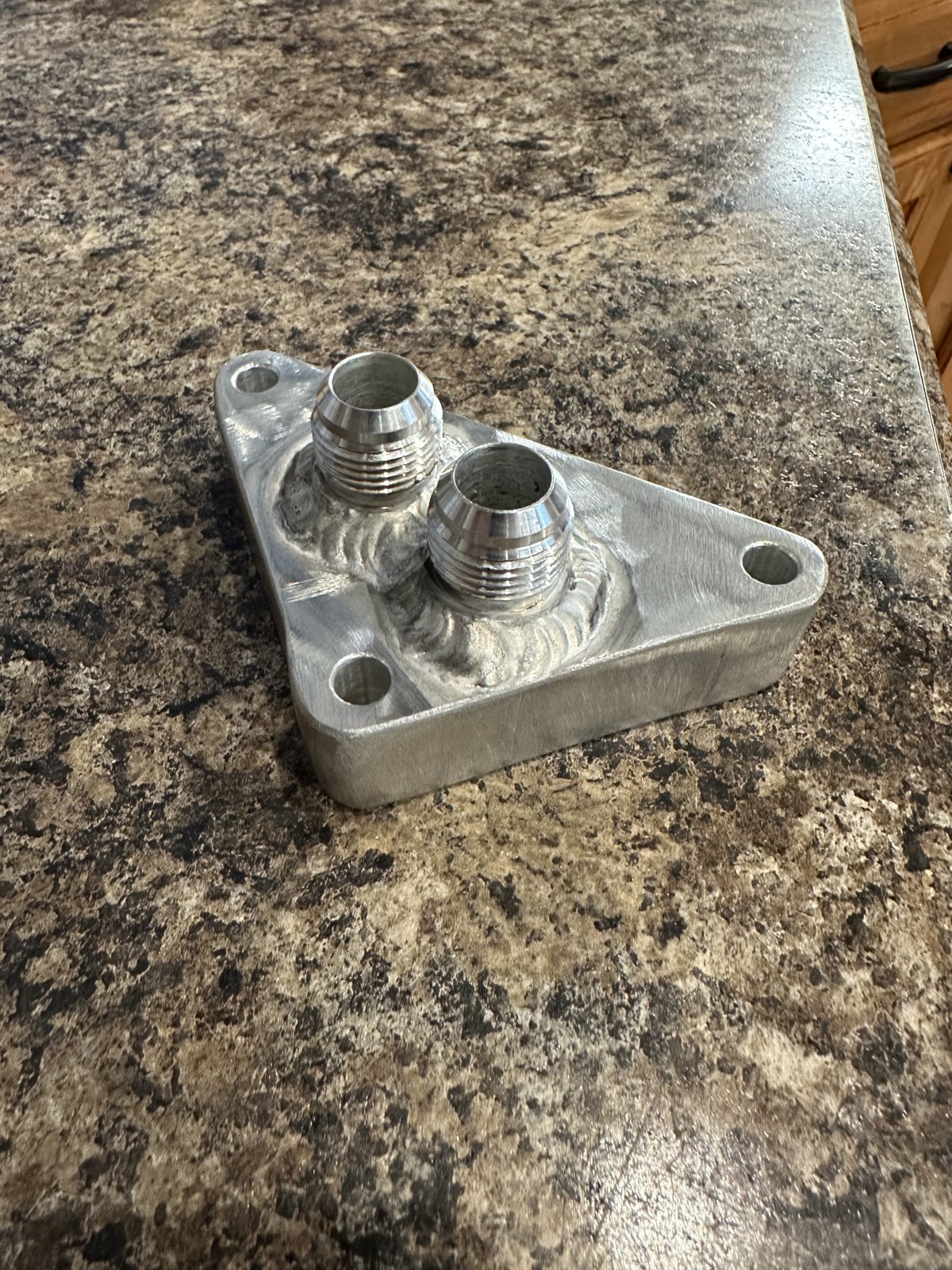

    A few things….
    I need one of these, tired of dropping 60lbs of skids to change a filter
