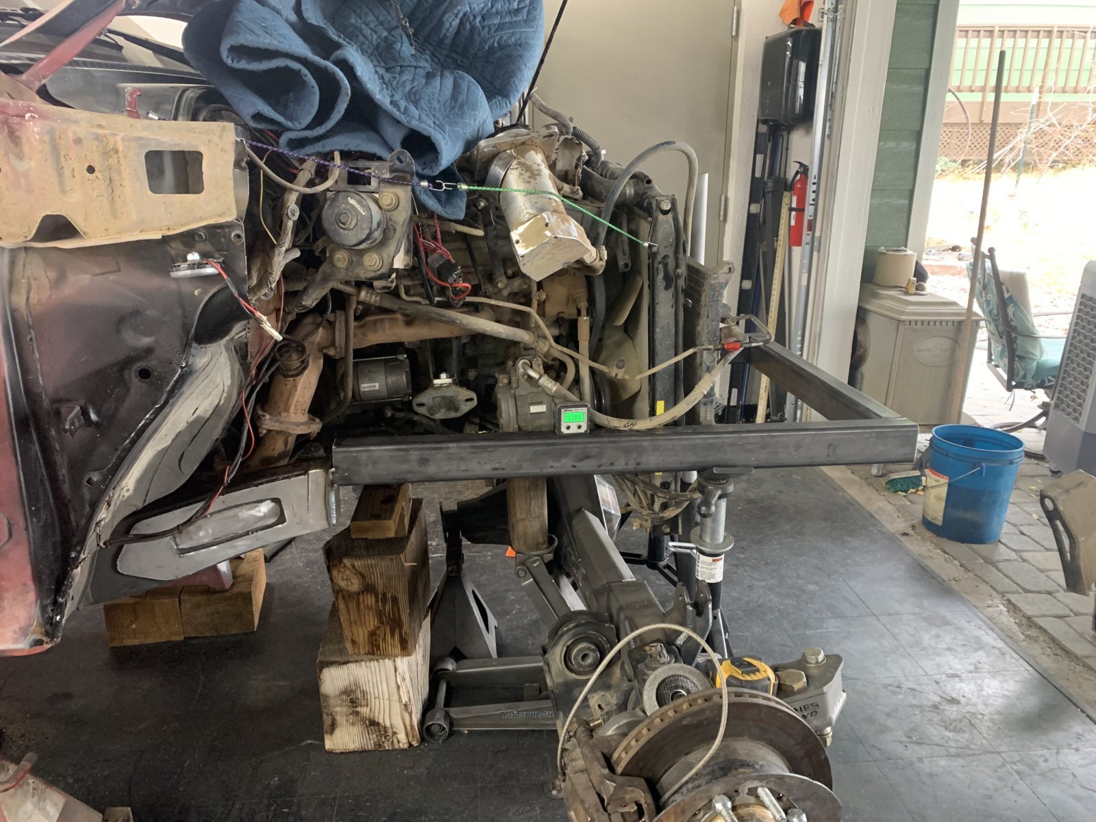

    Reno Nv

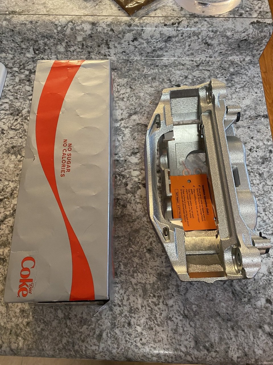

    Anytime I touch a SD axle, it’s just a question of what sized sledgehammer I’m choosing to get the job done. Because all SD60 jobs require a sledge :D
    The rear(!) brake calipers alone are hilariously huge
