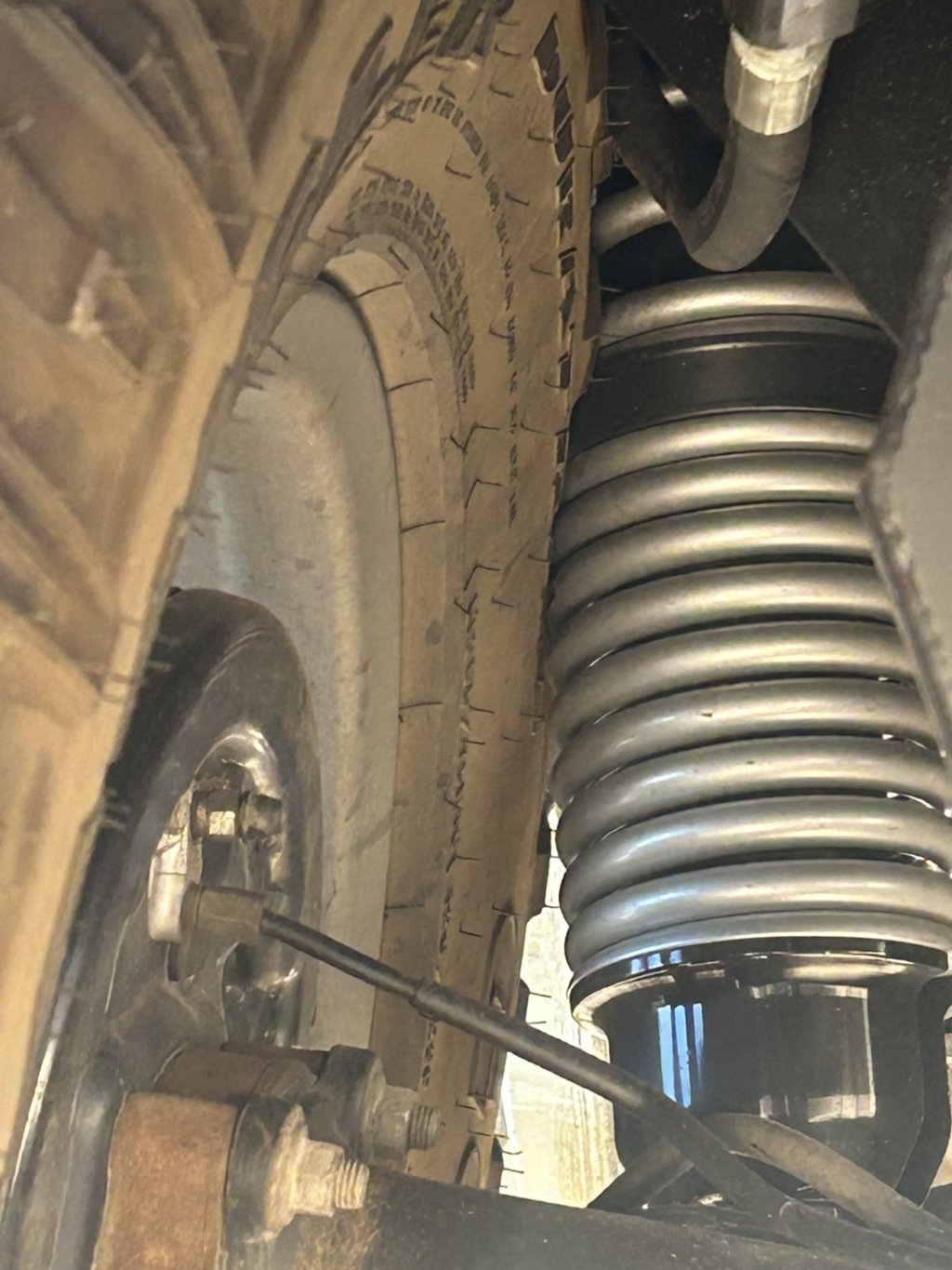

  3. Dec 3, 2023 at 8:08 PM
    PainterVern
    PainterVern GoatRoper
    Oct 23, 2019
    #308814
    148
    Vernon
    Reno Nv
    19’OR
    A few things….
    Yes Martec, no spacer here. He recommends a 2” with a 0 offset wheel. This was first flex after install. Just a test run…

  5. Dec 3, 2023 at 8:51 PM
    betterbuckleup
    betterbuckleup Well-Known Member
    Jun 26, 2017
    #222483
    4,831
    Ian
    Concord, CA
    2000 Tacoma SC 2.7 4x4 5spd
    @Buttskevin21 has the same Martec kit I believe
  6. Dec 3, 2023 at 9:59 PM
    Buttskevin21
    Buttskevin21 Well-Known Member
    Dec 14, 2020
    #349654
    2,490
    Kevin
    Washington
    2019 Brocoma, 37s, Lt, Dual Tcases, blah blah blah https://www.instagram.com/kevinjbutts/
    Stock-ish
    Yeah I crammed my shock when I had leafs with 1.5” spacers, 4.5” backspace, 37s.
    With the Martec kit I skim the dirt/mud of of the coil springs, 2” wheel spacer, 4.5 backspace
