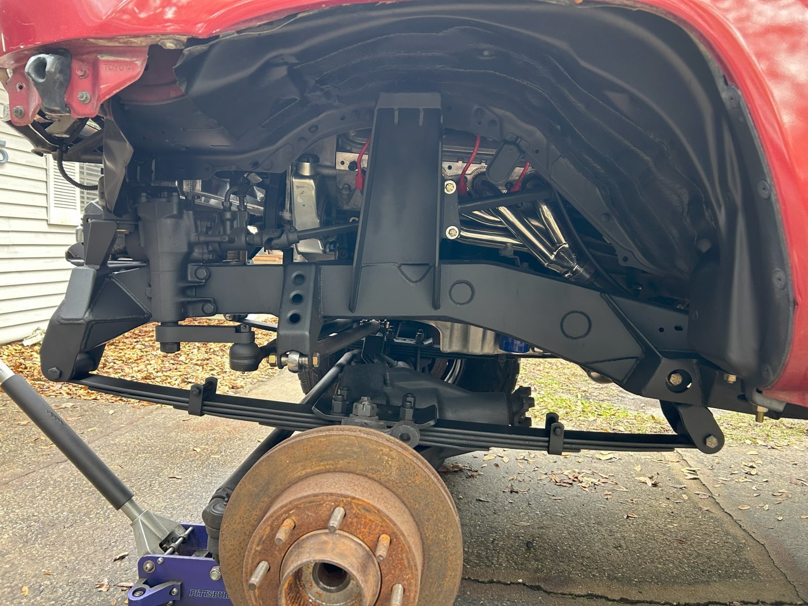

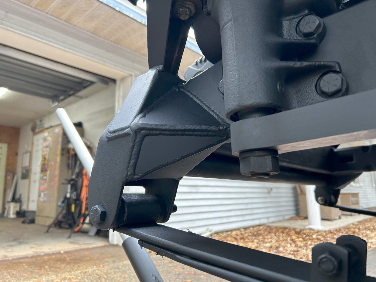

    Decided to go ahead and address this by just making new shackles that were 5" in length as opposed to the original 3.75" length ones. This bumped my frame height up to 22.25", and bumped my caster to around 5* positive. Also gave me a cunt hair more uptravel. Also finished gusseting the front hangers

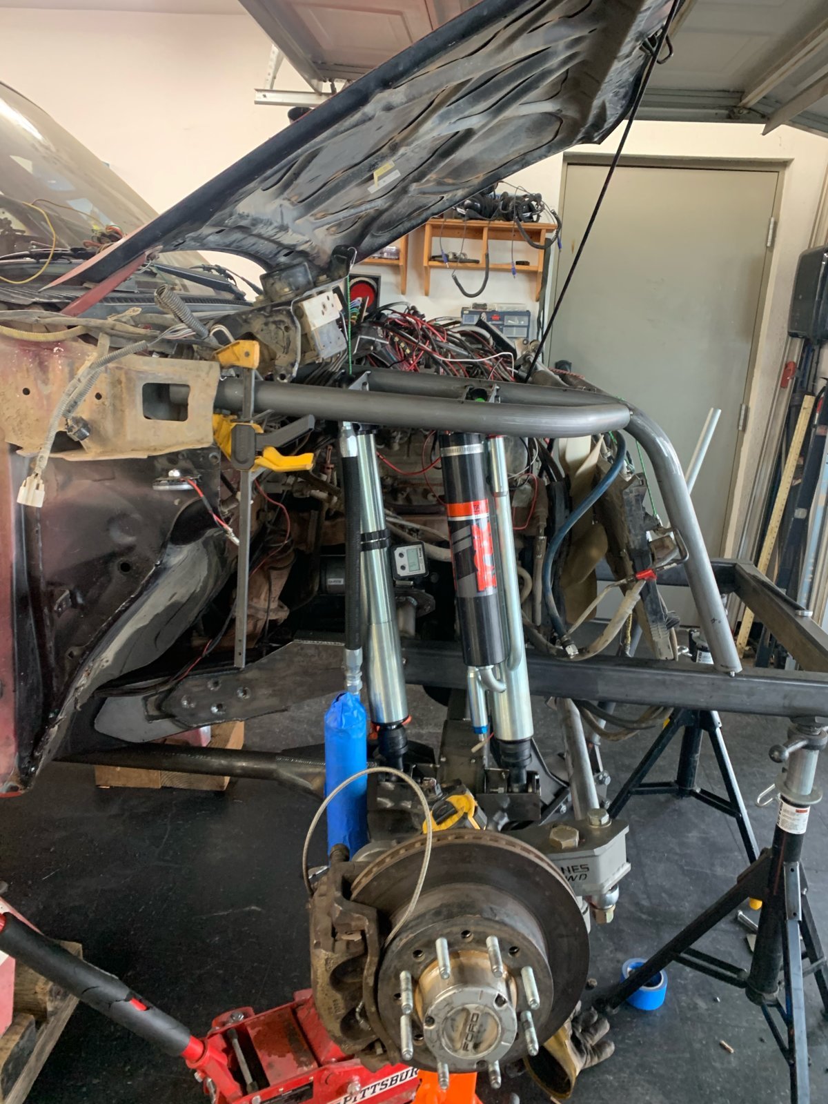

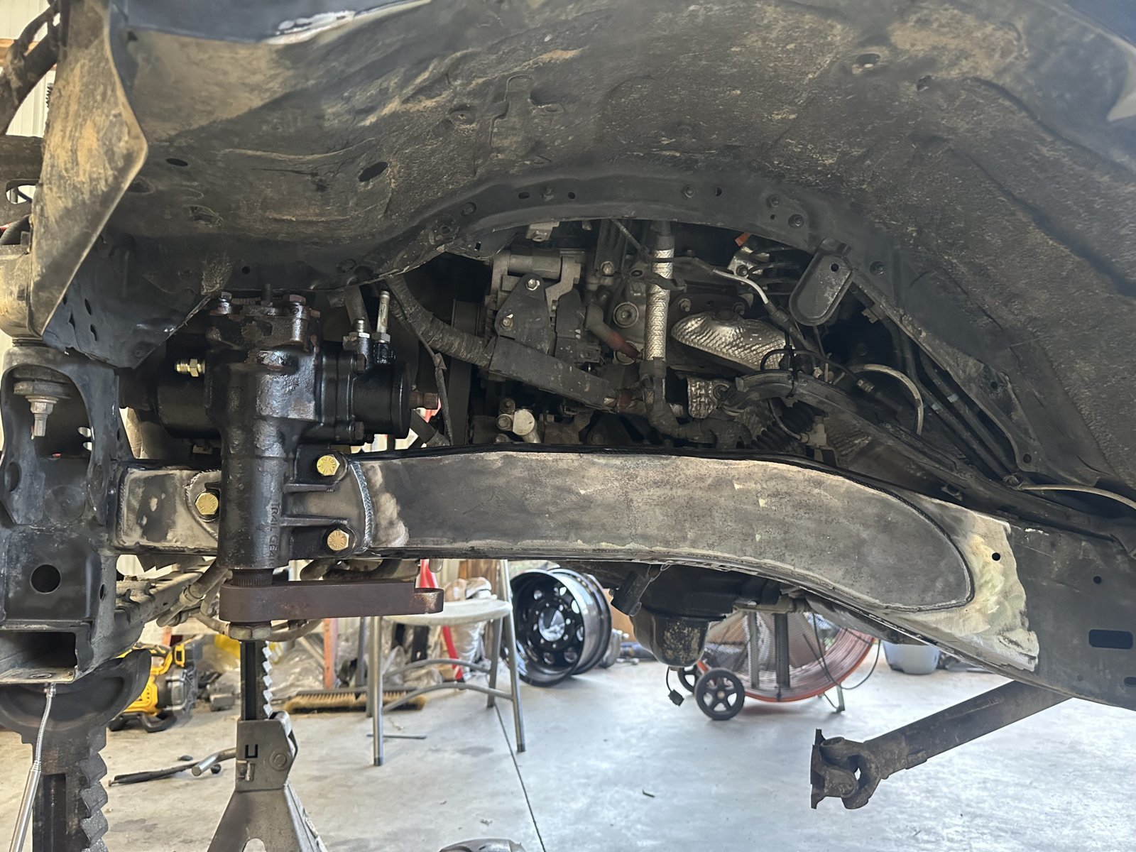

    1997 t4r has super duty axles, 5.13s locked front and rear. 3 link front with 14" kings. Rear 63s.
    Started New Year’s Day. Put a few hours a day on it
    axles are 05+ superduty, 5.13s grizzly lockers.
    trail gear box, psc 1.75” bore 8” stroke.
    shocks, king 2.5s 14” travel from @AccuTune Offroad.
    rear has a 63 swap.

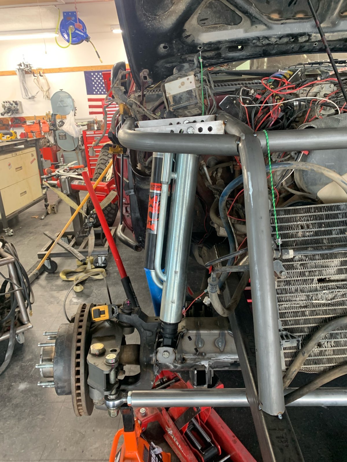

    @ Timbos Customs, curious why you burned the steering box in before even getting shocks or links mocked up? I had to move my box multiple times before landing it in the right spot, drilling those holes all over again is not fun
    malburg114 and 5 Lug Fury like this.
  19. Jan 4, 2024 at 5:22 PM
    Timbo's Customs
    Timbo's Customs Well-Known Member
    Aug 8, 2013
    #110078
    7,266
    Timothy
    Lakeland FL
    2019 f250 6”lift 37s deleted 1997 T4r, tons and 4ds
    Because it’s mounted as far forward as possible without doing some major reconstruction of the core support/ radiator mounts. It’s 1/4” away from hitting the lower hose
