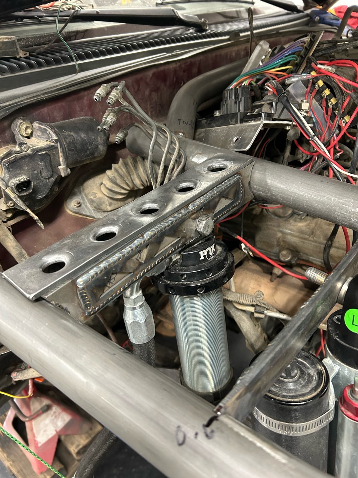

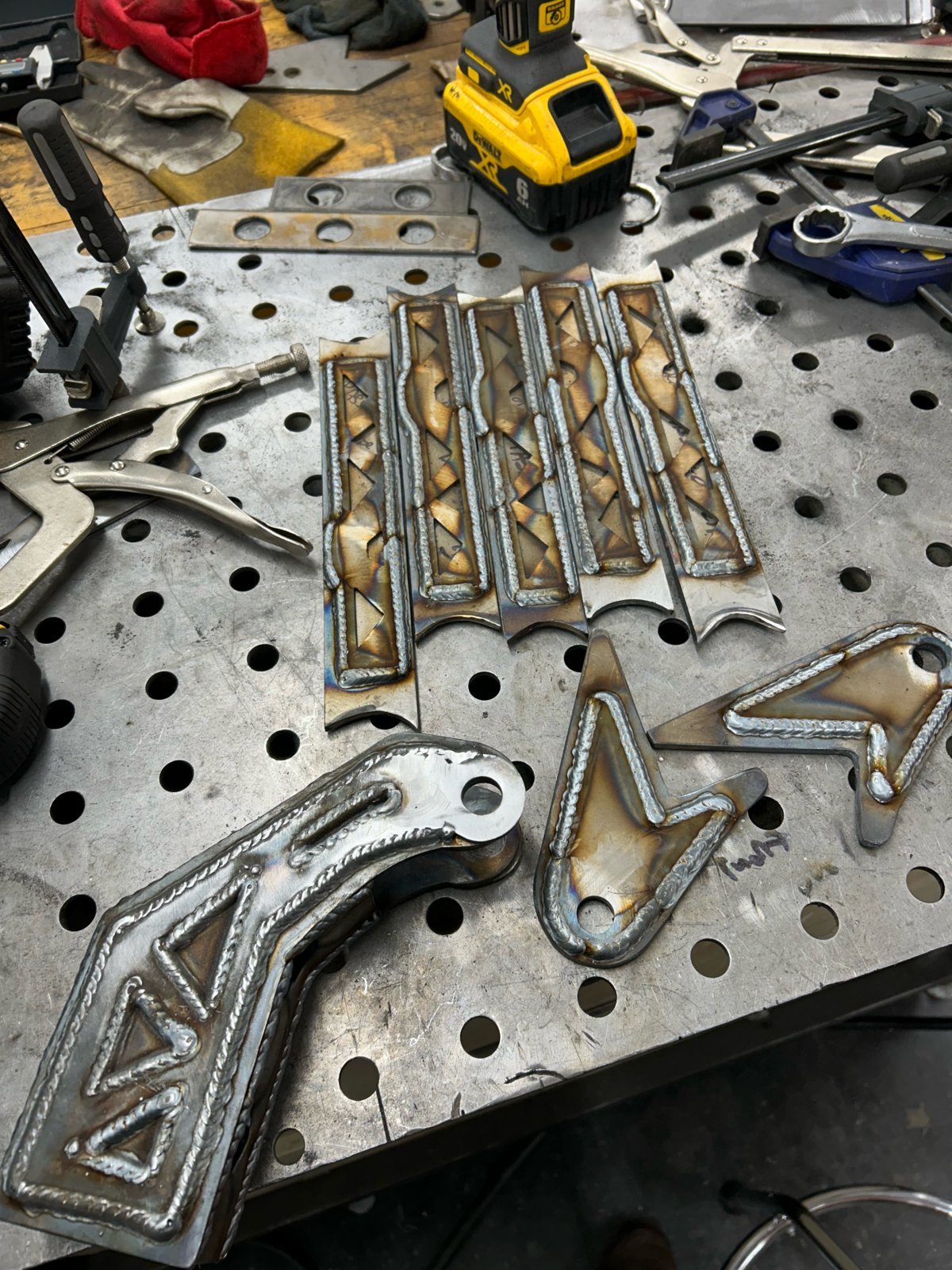

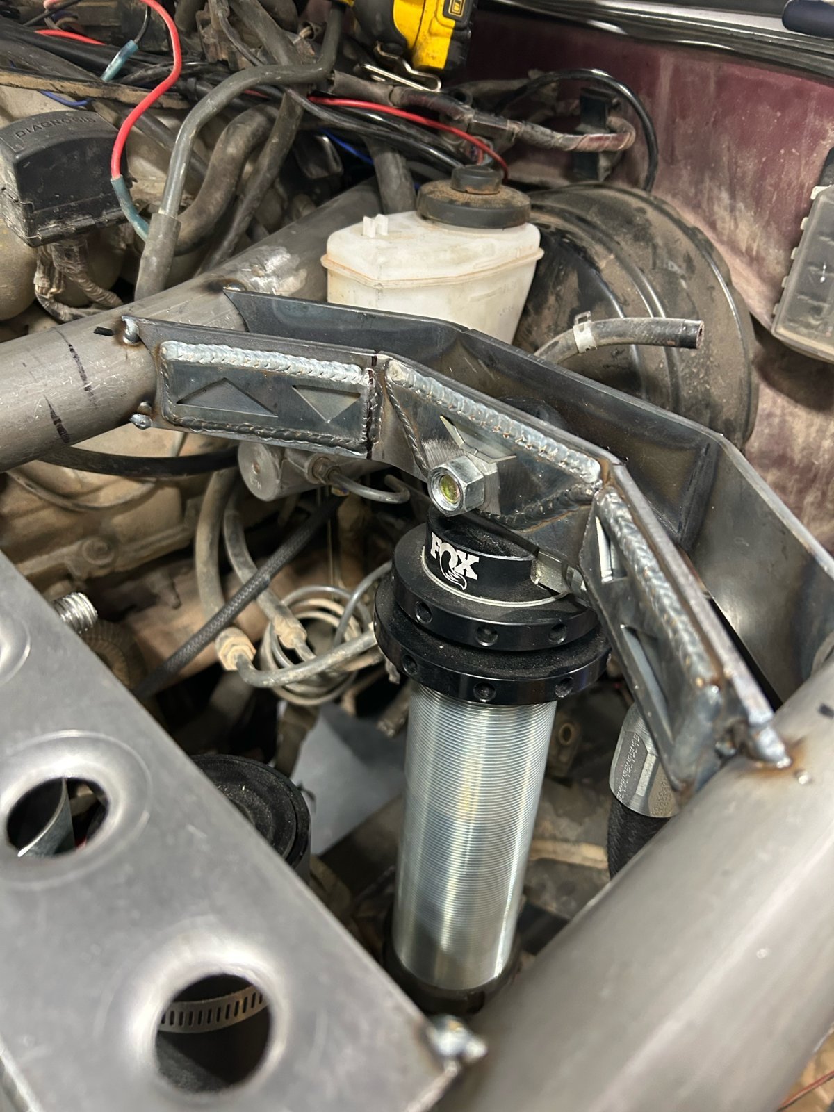

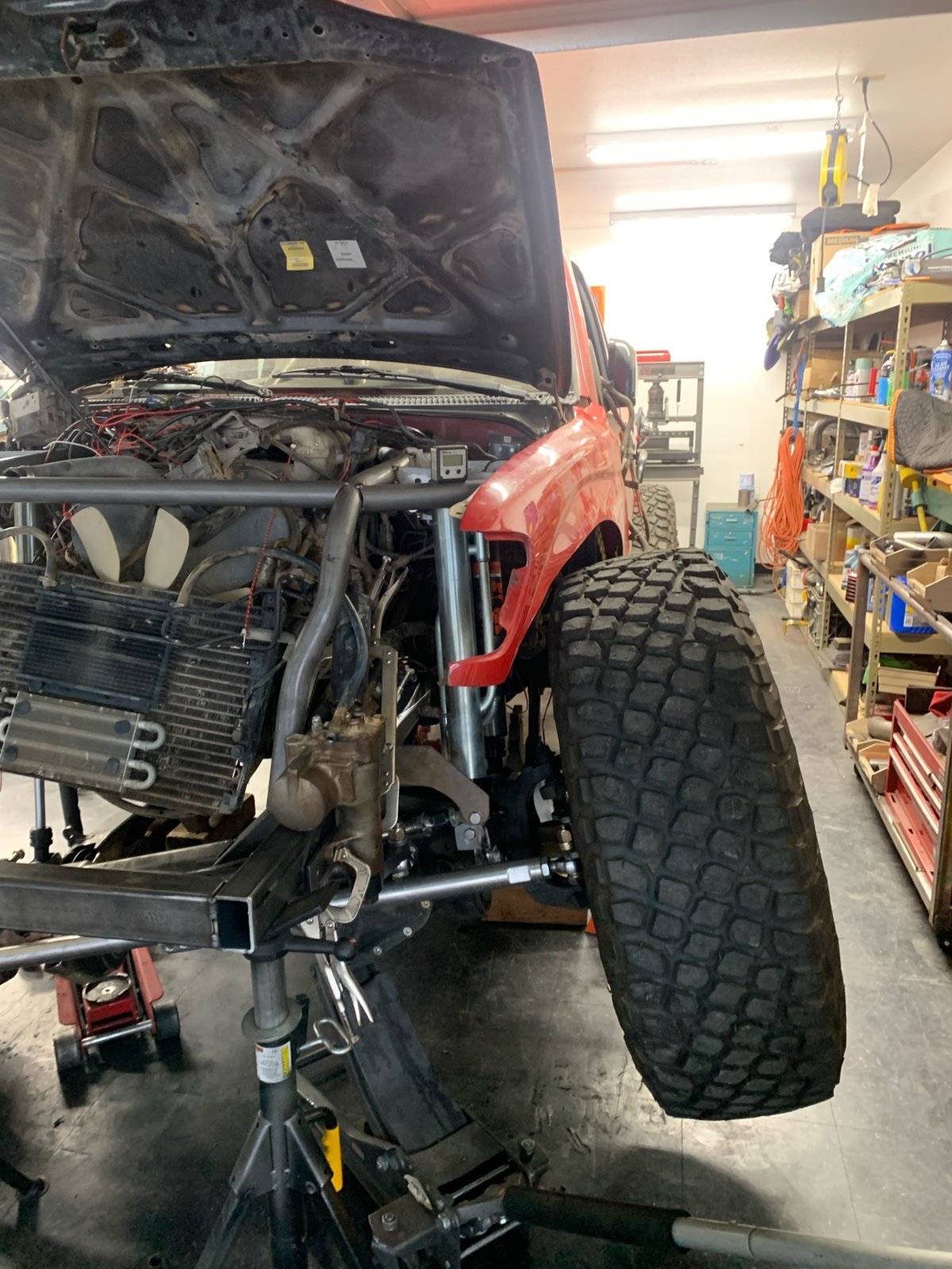

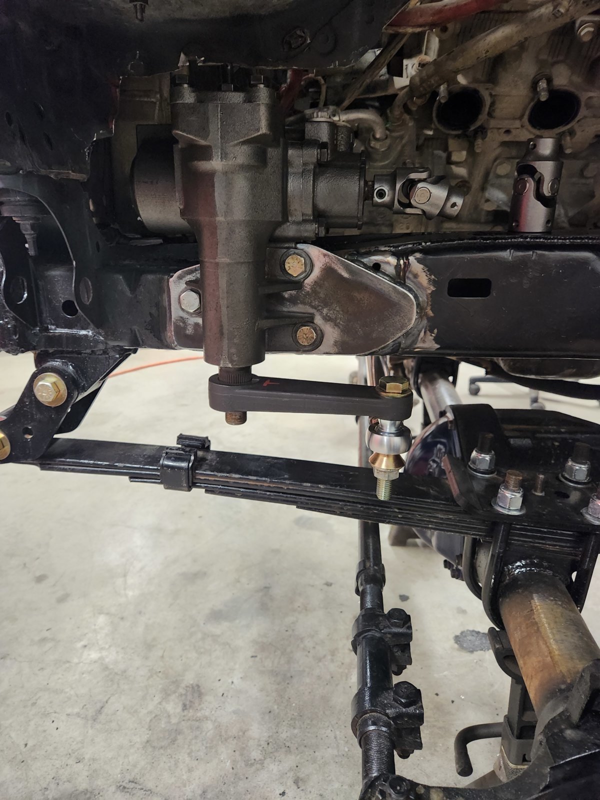

    More progress. Getting close to roller status. Making the last of brackets and will cycle everything again then mount the steering box and start burning everything in. IMG_3963_Original.jpg IMG_4144_Original.jpg IMG_4120_Original.jpg IMG_4117_Original.jpg IMG_3962_Original.jpg

    Hopefully the axle clears everything and that box doesn't need to go through the core support. I did the same thing on my truck and had to move it into the core support to make steering play nice but the 3rd gen frames might be a lot different

    My 4runner had to go through the core support also. I checked Martecs site on his and it’s roughly the same placement. There is a 3rd gen running 42s and it’s roughly the same spot.

    I landed pretty close to that area as well.

    The steering box on my 3rd gen 4r is where the body mount was.

    This is where I shoulda put mine. But I ain’t moving it now lol

    That's some really nice fab work there. Looks great.

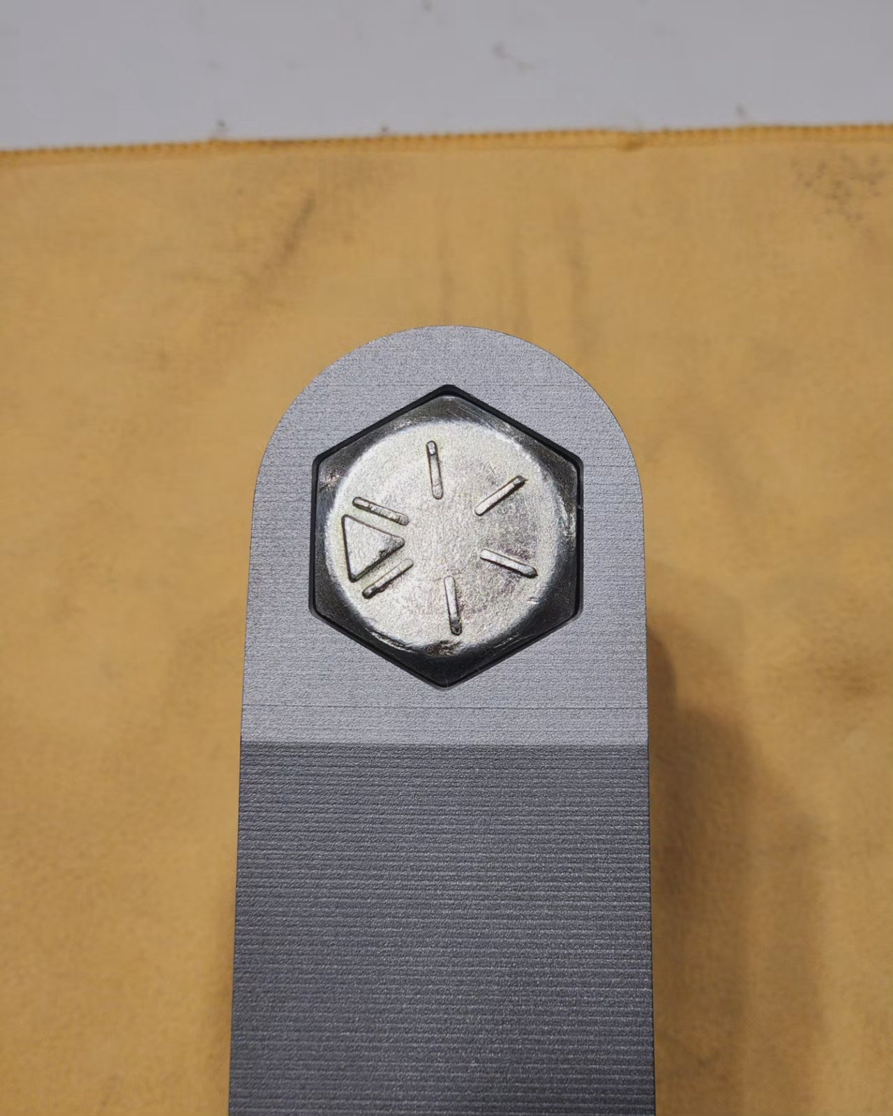

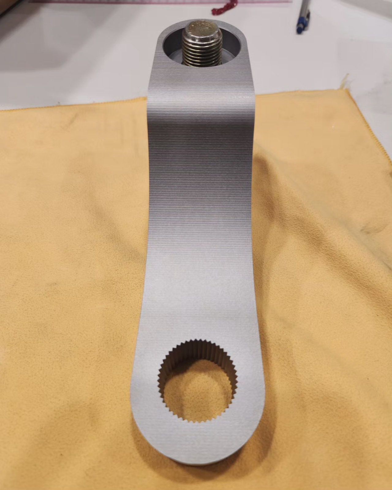

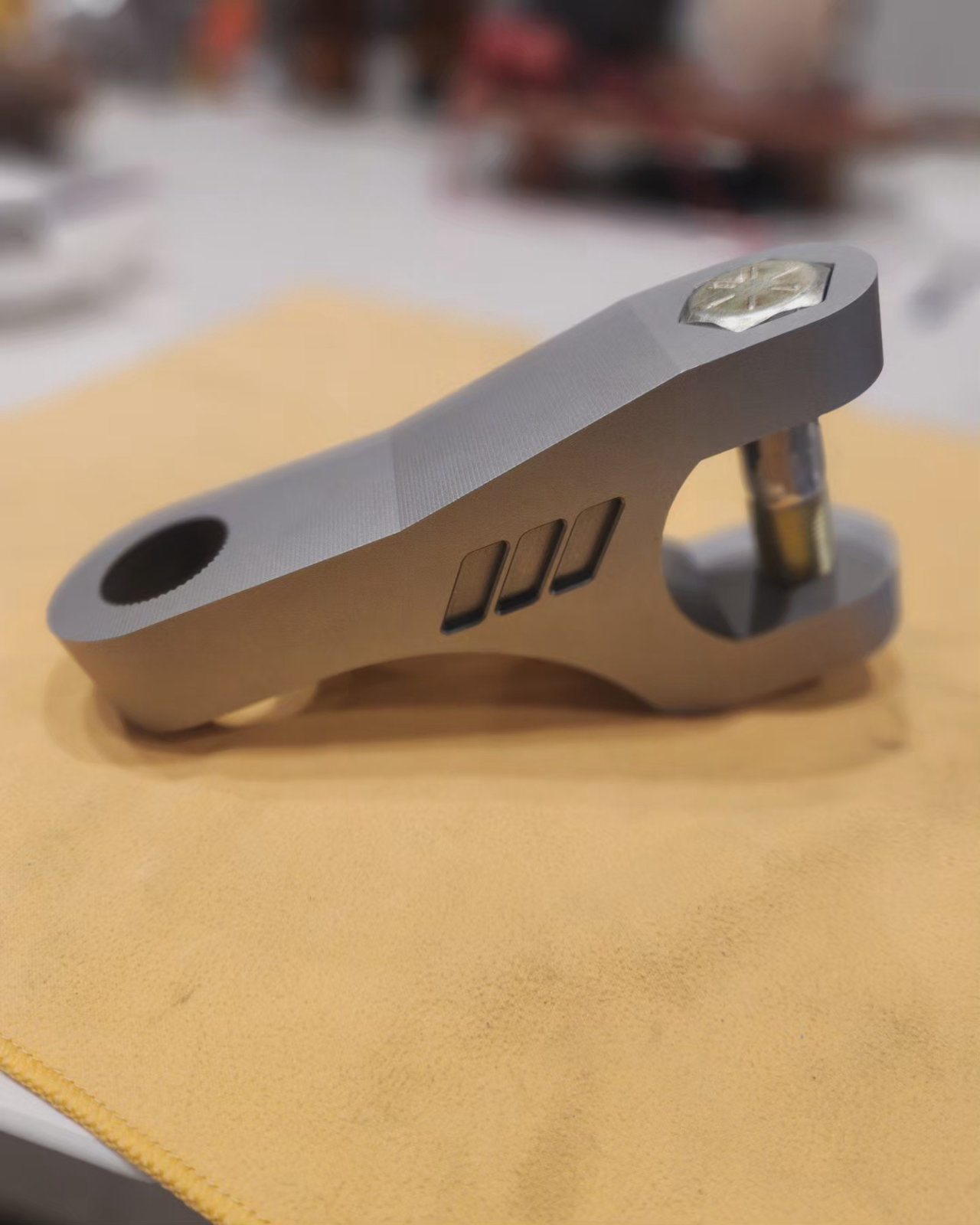

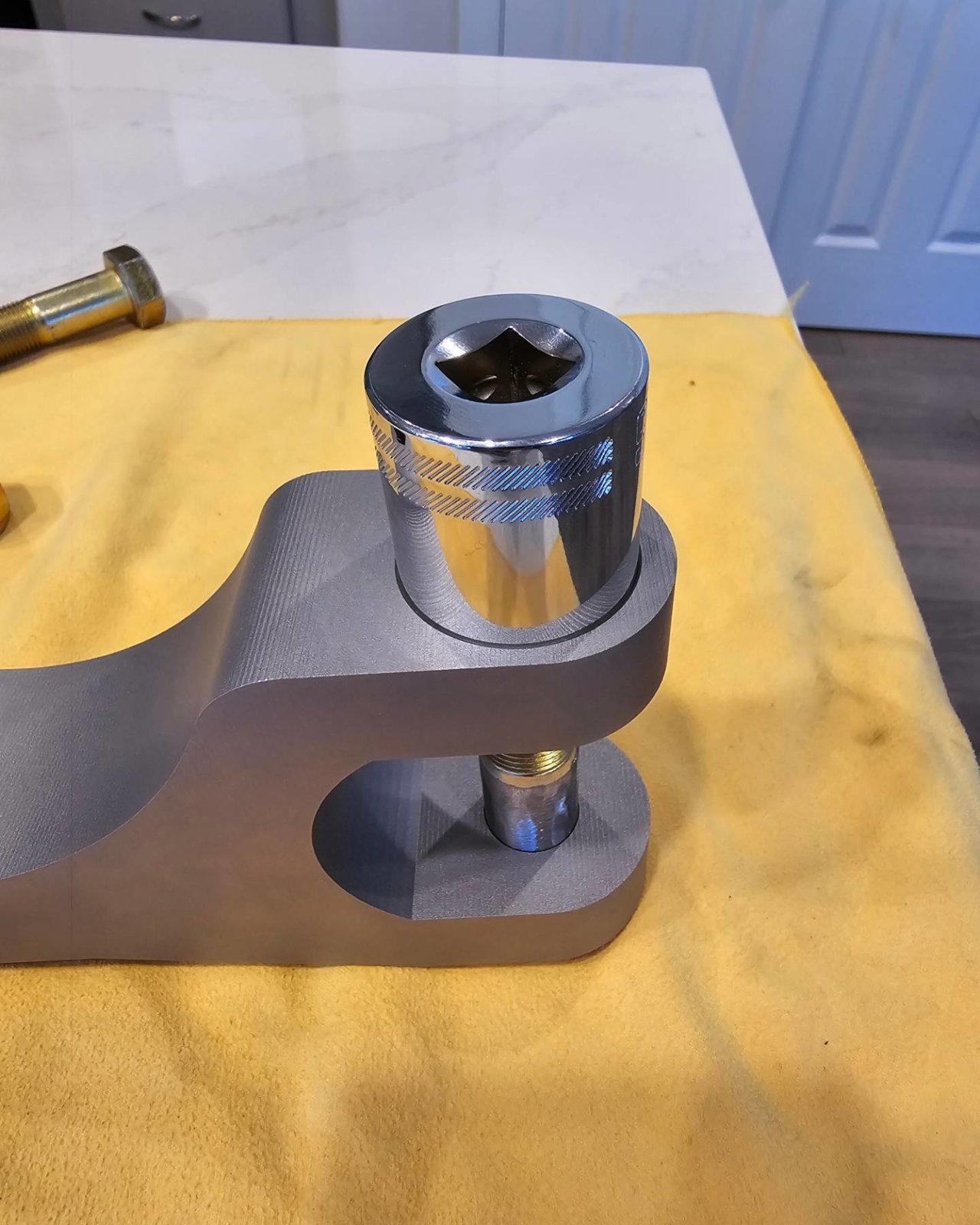

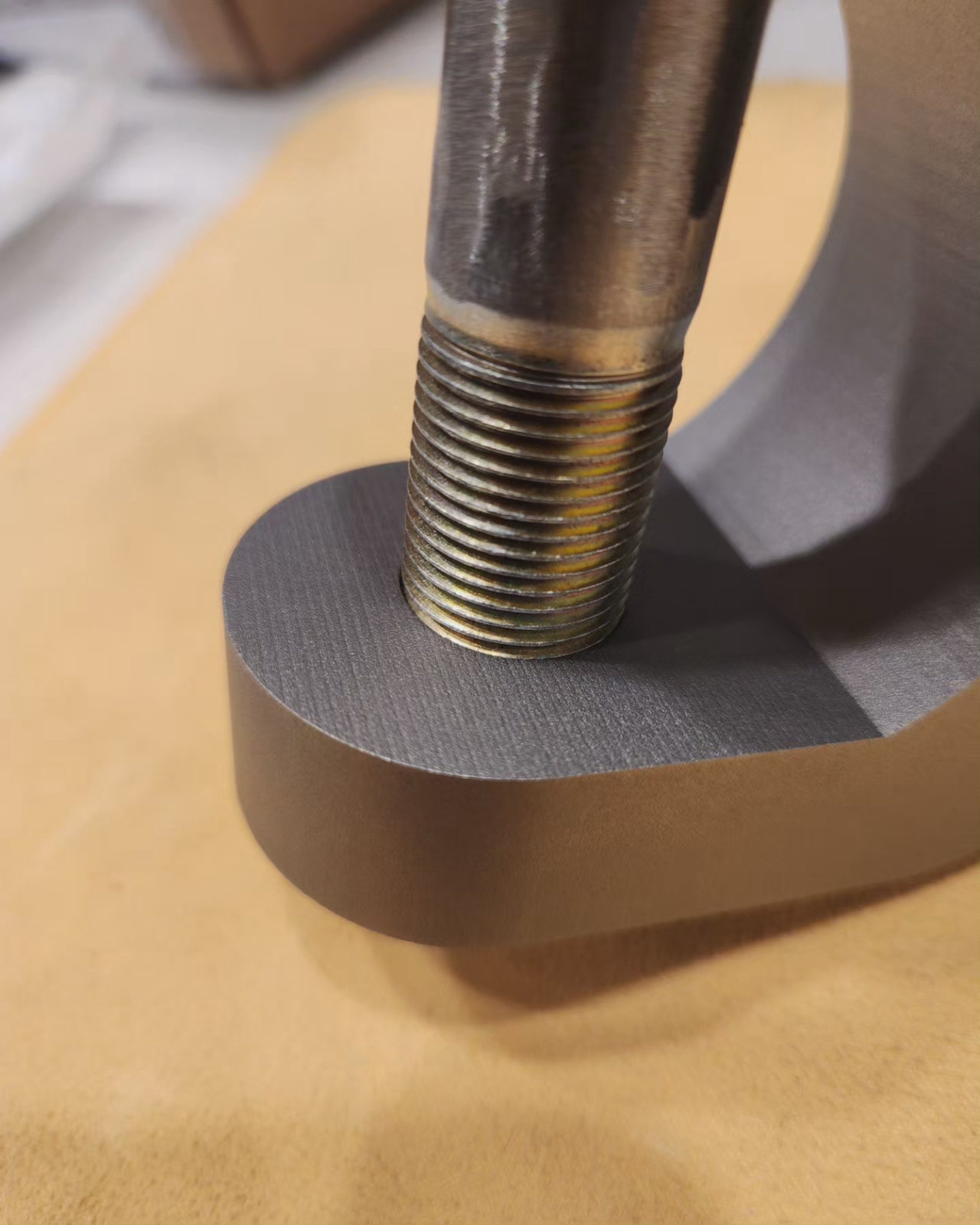

    Something I always wanted to do but was on the back burner for quite sometime. Finally made it come to life. It's on my truck now doing some real world testing. This is base off a stock drop pitman arm. I'm more active on IG @buc_mac if you're looking for progress

    Billet? Spec? Cost?

    That's a great looking piece. Definitely interested in learning more.

    4140 chromoly, spec is similar to stock pitman arm drop. No pricing at the moment
