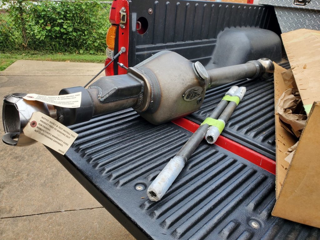

    Recently picked up an 01 ext trd that is bone stock and came with this TG bare housing (TGI-308906).
    I have no problem ordering the adapter and running dual mini truck cases for the passenger drop.
    My question is, TG doesn't make a 3 link for the taco pass drop. Does anyone make a link kit that will get me close?
    The tube is 3" but has that flat brace on the pass side, looking for feedback and options.
    Windigo likes this.

    that’s more work and money needed. Why not sell it and buy a housing with the correct drop?

    The extra money can be spend elsewhere such as lockers, beadlock, tires etc. If it’s an assembled housing, that’s one thing. But it’s a bare, why bother catering everything to it. I would sell the housing, keep the shaft and buy the correct drop bare housing.

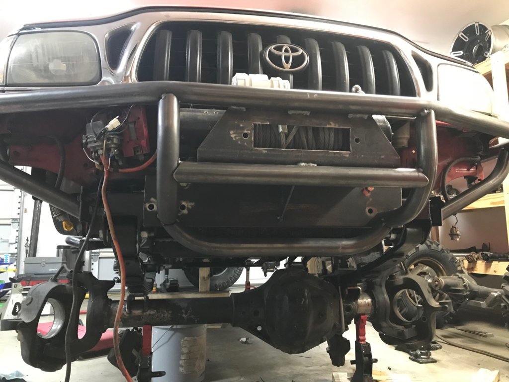

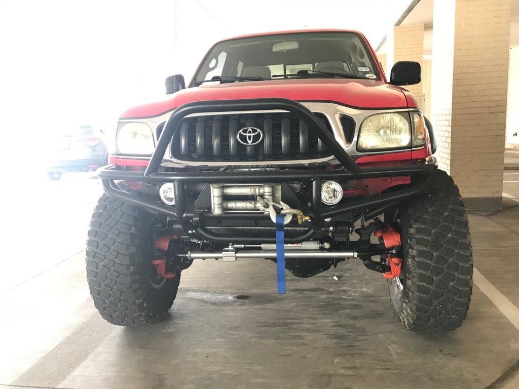

    Gentleman! I want to get some shocks on order for my SAS build but am looking for recommendations/advice from the experienced. My build is an 02 3.4 Tacoma Chevy 63s in the rear and trail gear axle and springs in the front frenched into the frame. Currently I'm sitting in some Bilstein 7100s with 360/80 valving that I ran in the rear of my third gen for awhile. I'm thinking I might be able to get away with these in the front but maybe a little harsh. I'm also considering fox 2.0 race series that come with 30/90. I think these would work well in the rear but might be a little light on compression for the front???

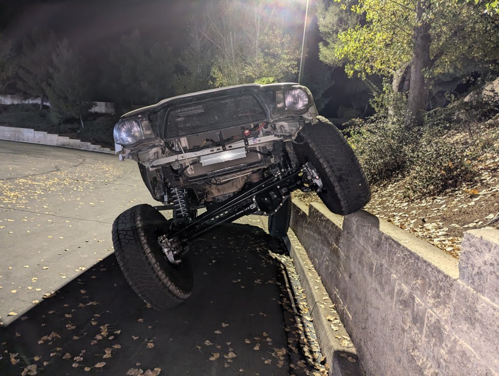

    Just finished 3 linking my 2nd gen with a 2005 Dana 60 and a 14b rear. Are you guys all running a tundra booster with a gm master? I've got a tundra booster and master right now but the pedal is extremely squishy and I can't lock up the brakes. I would try the gm master but I've only got ~1" from the tundra master to the shock tower and I think the gm will be too long

    can speak for 1t setup or tundra booster but I can lock my 40s with the tiny Tacoma 1” MC and dual diaphragm booster.
