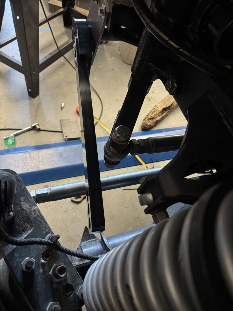

    If anyone is wanting to add a front sway bar, this information might help you in the future. Making mine removable with .250 brackets instead of welding the brackets to the frame like the rear I have.
    @Team_Jake since you were considering a front sway
    Everything’s cut, measured for clearance twice, and ready to weld. Will triple check clearance when I start on the air bump in a week or two. Clears lock to lock (pitman arm and tire) by an inch or so and is +1” away from CO. Currently, trying to get some 1.75” tube bend to tie the tower together.
    Brand: TK1 KOH ULTRA 4
    Bar: 43.50
    Tube: 40.75”
    End link: aluminum 12-13”
    Arm: 20”
    Splined block: offset

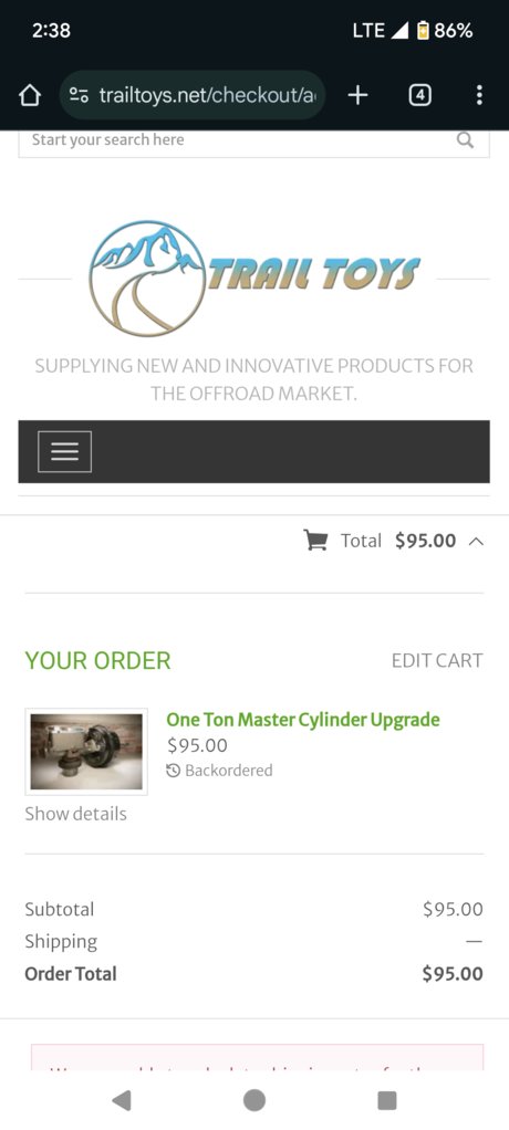

    Tried that backordered might just make my own adapter. It's not an emergency but don't want to leave it to the last minute.

    Rock Hound Offroad makes an adapter for a 2000s dodge 2500 master cylinder to mate to the tundra booster. I received it the week I ordered it. Planning to install it next weekend

    Yep I want one. But rockhound dose not deliver to Canada
