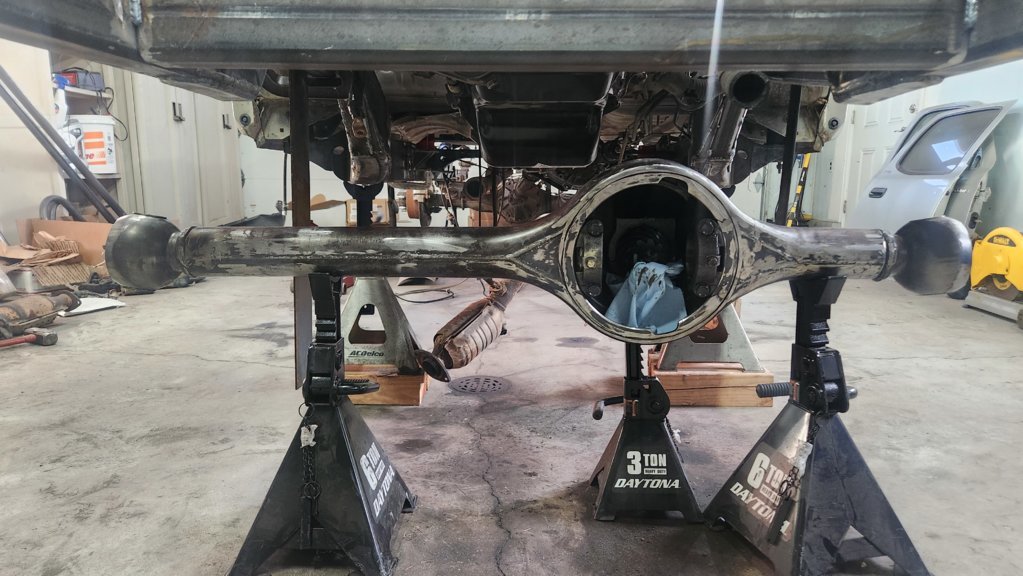

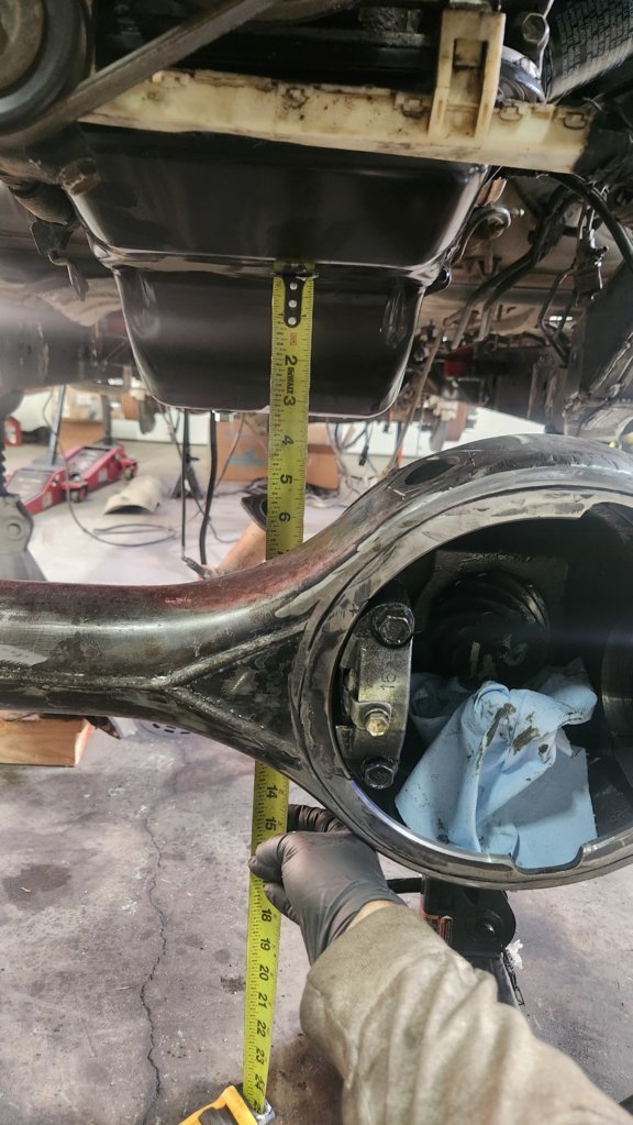

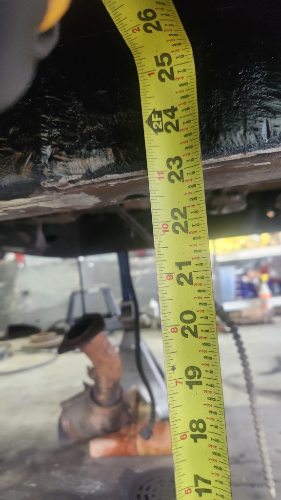

    Correct. Truck is currently sitting at 23", goal is 23-24" with 39s. And yes, doing a 3 link with 14" coilovers.

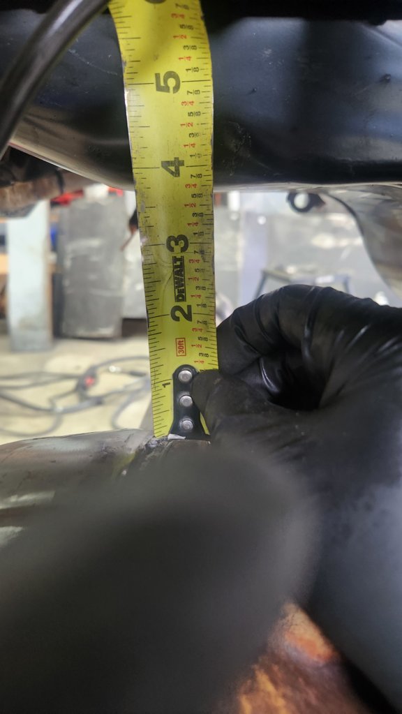

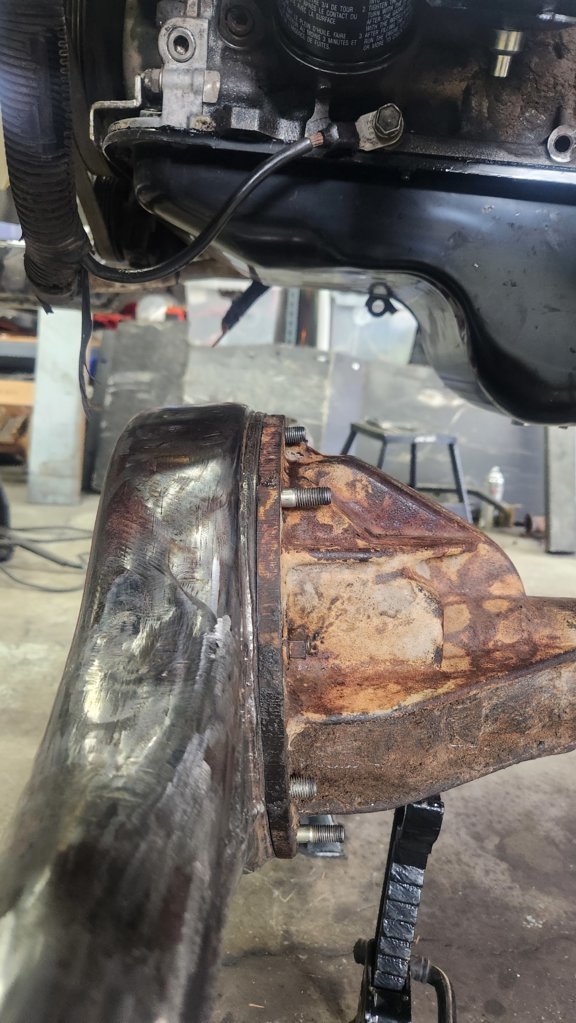

    Is the axle at ride height in the photos? Not much uptravel if so.
    Is the diff hitting the pan the first point of interference? Upper link clears?

    it looked like you chopped the front end off at the bend according to the picture?

    Axle is sitting close to ride height yes. I'm in the beginning stages of getting the links on, that's the project for this week. Just by looking it seems the pan will be the closest thing to hitting. Haven't started putting links on to see how it will all cycle.
    Yep, I chopped the frame and raised the engine 3.75".

    damn. It’ll be a tight package trying to keep it low and tuck entering under there.
    TBH, you should consider the panhard as the limiting factor. At least for me, that was my limiting factor. Cut some pvc and cycle the suspension.

    Do everything ya can to make it low with some uptravel. You won’t regret it

    Noted thanks! I'll throw some PVC under and see how it looks.
    I'm trying! Would like to aim for around ~5" uptravel

    That would be really impressive.

    No body lift? I can’t read a tape because I came up with about 1.5” of clearance to raise mine :homer:

    1" BL. Wasn't planning on it, but since I raised the fuel tank, I had to use it.

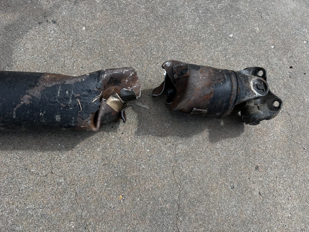

    Time for some HD tubing.... 2.75x0.156
    IIRC, factory is 0.04ish and most DS shop will recommend .08 or .120
