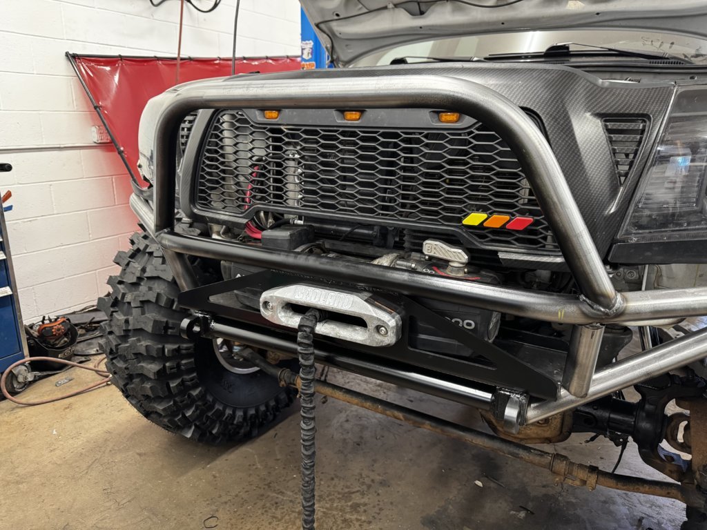

  10. Feb 7, 2025 at 4:42 PM
    Operator8
    Operator8 Well-Known Member
    Sep 14, 2021
    #377040
    704
    Woodland Park, CO
    2005 White Tacoma TRD OR
    SAS INW

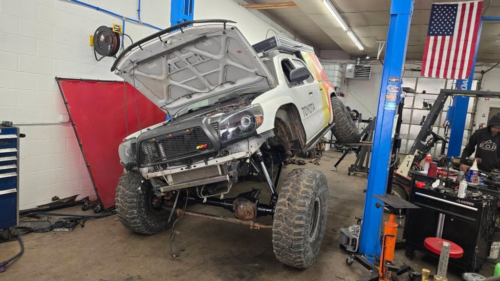

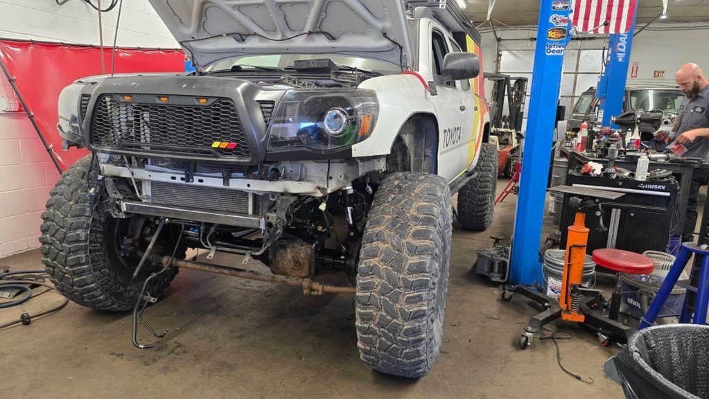

    Had to borrow tires (just a little smaller, but they are getting the job done), so things don't fall too far behind. New order for tires should go through today. Axles are still due some more cleaning up, and the internals plus e-locker need to be done. But it's coming along!

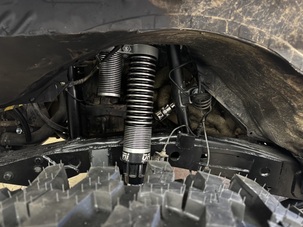

  19. Mar 18, 2025 at 5:21 AM
    Operator8
    Sep 14, 2021
    #377040
    704
    Woodland Park, CO
    SAS INW

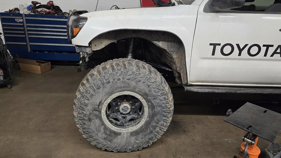

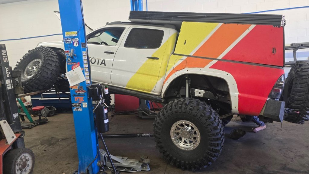

    Just about there… Will be a bit before I drive it though, as I need to get the exhaust redone.
