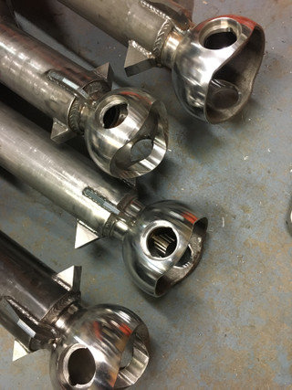

  2. Mar 20, 2025 at 9:42 PM

    I’m a fan of 9.5 and 80 birf & knuckle. Combined that with HF knuckle, plenty of BEEF
    Built a w44 years ago. Enjoyed the length and matching lug pattern as Toyota, 6x5.5 Only downfall, 4.88 is there only ratio that will match. I seen people run 5.19 front and 5.29 rear.

    Looks good. I'm fixin to shell out for the Branik total splines... my wallet isnt going to be happy but I will in the long run.
    and I just dropped a load on some Haltech goodies for some boost..

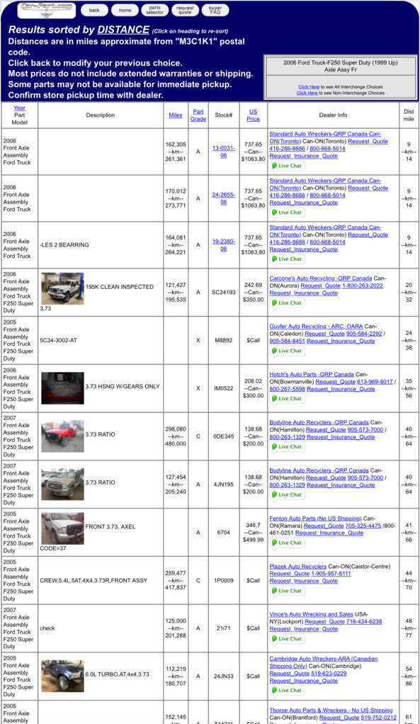

    We're looking at around 1300 for 05+super duty front axles in the Toronto area from junk yards.

    I paid right at $1,000 for 05+ pair outside of ATL a couple years back for the taco.

    You’re not wrong. People say the elocker is weak (which it is) but the 8” ring is weaker and will break before the factory elocker, lol.

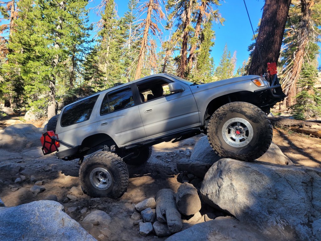

    @lit_taco4x4 find yourself a FF80 (93+) rear end is the best route without dropping a pretty penny. In the valley, non-elock can be had for 6-800 and elock are upwards of 12-1400 with inflation. Probably one of the best combo and you can recoup from the investment by selling your current rear setup.
    Picture is a buddy’s runner, hi8 elock front and elock FF80 with Nitro shaft on 40 and 4.7 doubler. Issue free for 10+ years with a lite foot and picking good approach angles.
