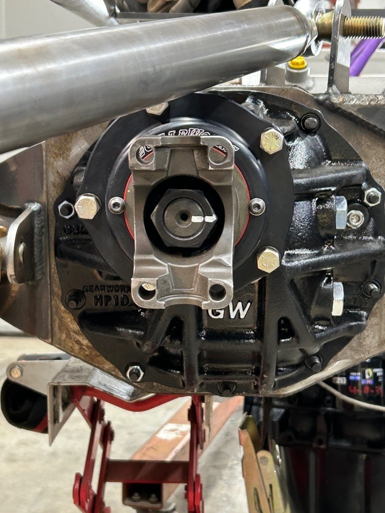

    You'll be fine. Just don't let the skinny pedal bite you. A FF80 or fab 9 would be a nice match to your front Diamond.
    Or there is always the HP10 route lol. These hurt the wallet and I still have one more to buy..

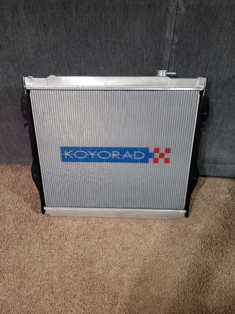

    There’s 3 difference size radiator, Denso 221-3137 (1” core IIRC) sits flush with the frame. Denso 221-3136 hangs about 1.50” below the frame (1.25” core). Denso 221-3138 is for the auto v6, hangs the farthest down. They all have atf cooler built-in atf cooler.
    I had no issue switching from oem Toyota v6 radiator to the smaller core Denso 221-3136 running 40” tires with summer heat averaging 100~110. Up until 2 or so years ago, I decided to go with the KoyoRad 2 row radiator and ditch the Denso. The koyo physical measurement is identical to 221-3136 but have a 1.75” vs 1.25” core and 2 row vs 1. I’m auto but had ran an extra large external atf cooler so I didn’t matter.
    Auto will required an external cooler if you plan on running the koyo as they do not have built in cooler. I have the koyo with Toyota coolant without issue for several years now.
    picture: top is atf cooler and bottom is steering cooler

    KoyoRad VH010513 & SK-C13 cap -
    Core is 1.75 and 2 rows. Identical overall measurement to Denso 221-3136. This radiator coolant capacity is larger, hence, able to supply cooler coolant to the engine and have no ATF cooler. For the auto guys, you’ll need to run an external cooler like I did.

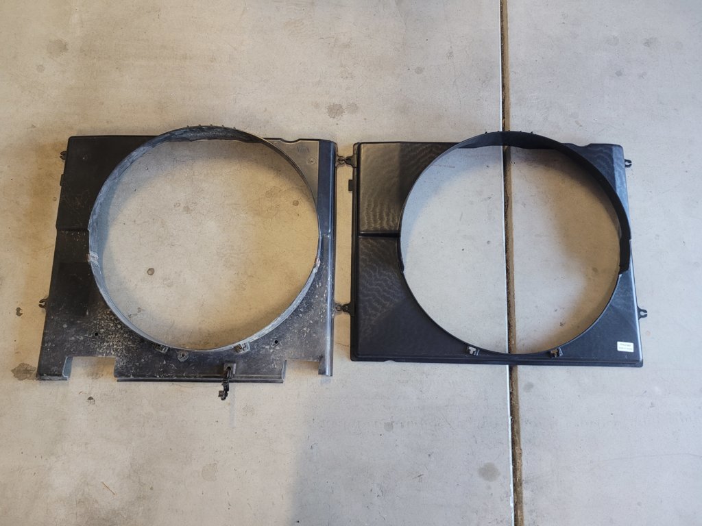

    If you’re running the shorter radiator, you’ll need a different lower hose: Gates 22120 / Napa 8791 and a Toyota Tacoma manual transmission fan shroud:#16711-07020 or #TO3110111

    KoyoRad FTW
    Shroud -
    Left, cut v6 shroud for Denso 221-3136
    Right, shorter shroud. Fits perfect.

    I ran the Denso for years, issue free. I decided to swap it out for the KoyoRad because I wanted more cooling capacity and I was never a fan of having plastic on the radiator. I kept the Denso as a back up, collecting dust in the garage.
