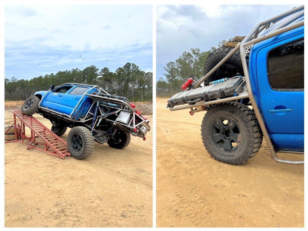

    2nd gen, but I'm at 42.5" eye to eye on the lower links. Built the truck to go fast, but it crawls beautifully. Upper links are shorter. I want to say 36" if I remember correctly. Running 18" coilovers on the axle. cycles a little over 24" of travel, bumped and strapped at 22". Kept the stock wheelbase of ~127" and am sitting at about 1" of lift over a stock truck. Forward link mounts are above the bottom of the frame rails, so no hang-up points and good driveshaft protection. Kept the forward mounts close to being in-line with the carrier bearing to help minimize slip yoke plunge, so you may have a very different length if going on that as a priority on an access cab 1st gen.

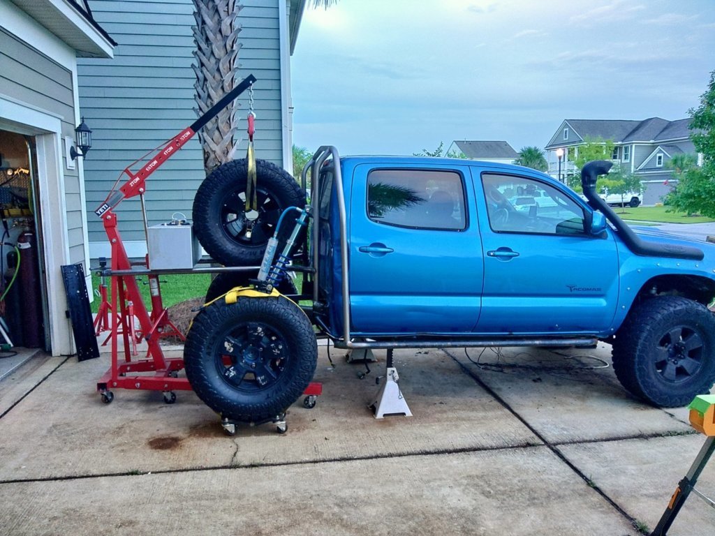

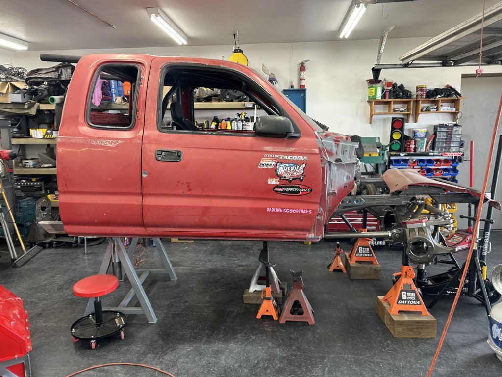

    Tire right behind the cab will help a lot. I've only had the truck running on these links for about 6 months, with two wheeling trips. I've barely touched the links. I think it's a combo of the mounting points tucked up inside the frame, and the low ride height.
    I'll have to take a better picture of it currently, but this build photo shows how high up and protected the lower links are. May have to zoom in. Would pretty much have to slide across a tall rock right down the center of the truck to hit them. They're 2.0x1/4 DOM. If I run into bending issues, I'll swap them out for 7075, since I don't want to add even more weight, sleeving the 2" DOM.
    Edit: I'm hovering right around 5000 lbs fully loaded with gear and fuel, which isn't bad for a fully caged truck, but its easy to let weight get away from you. That would also play a big part in how easily you can bend your links. And guesses on your finished weight?

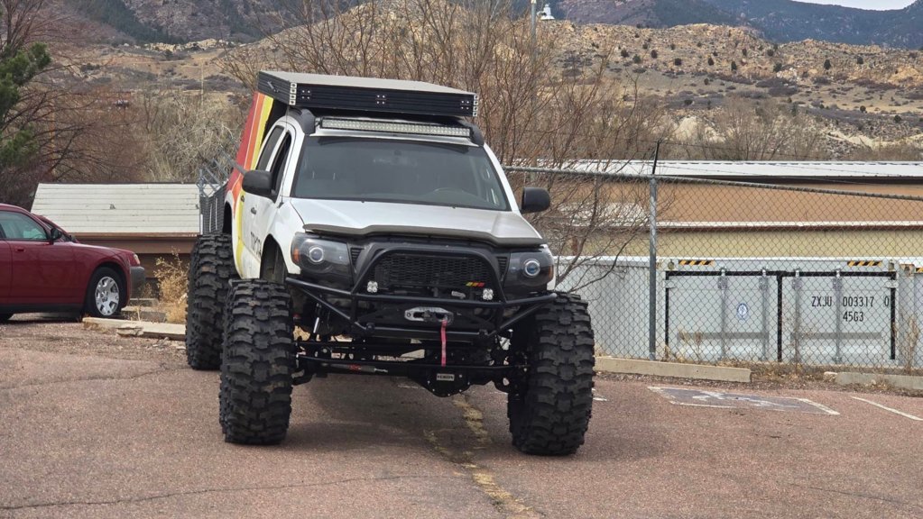

    Truck is somewhat under its own power again, be it FWD only at this point.
    2nd week of April I’ll try to get the exhaust redone. Right now it’s “running” with a chopped up Y-Pipe.

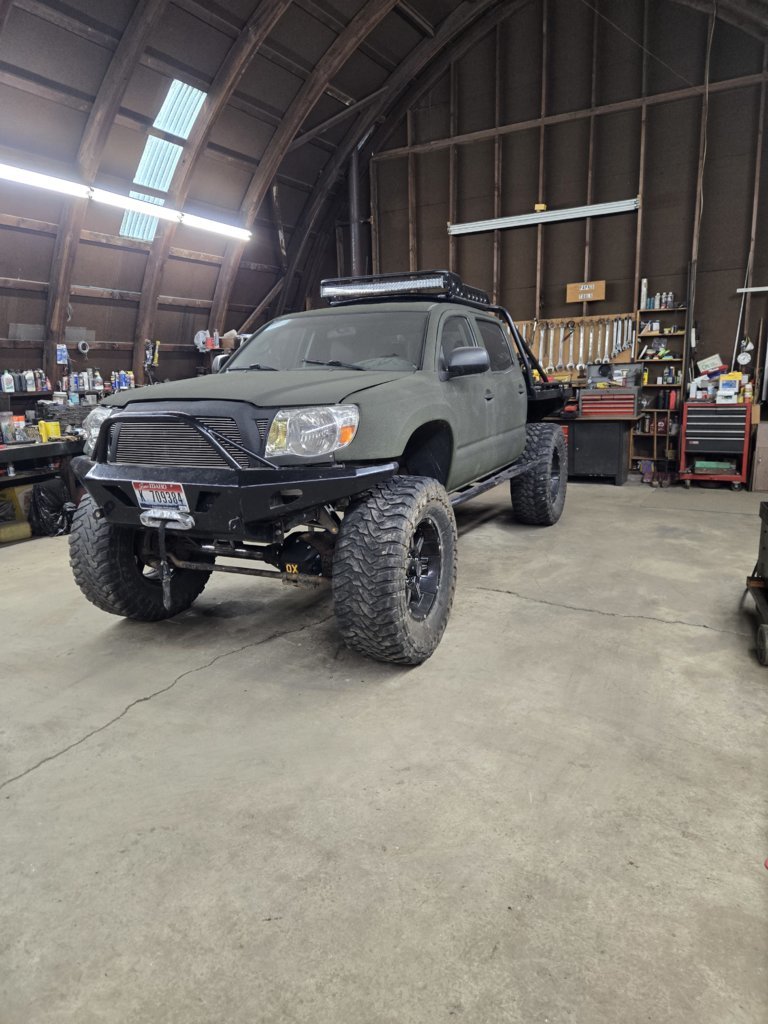

    What size tires are you running? Also wheel backspacing? Any rubbing? I'm in the middle of clearancing for tires now on my build.20250322_172843.jpg

    43”. Wheels are Dirty Life Enigma, 4.53 BS, -12 offset, with 1.25” spacers. Flexed out no rubbing, but this was legitimately the 1st time out of the garage. So no trail experience yet.

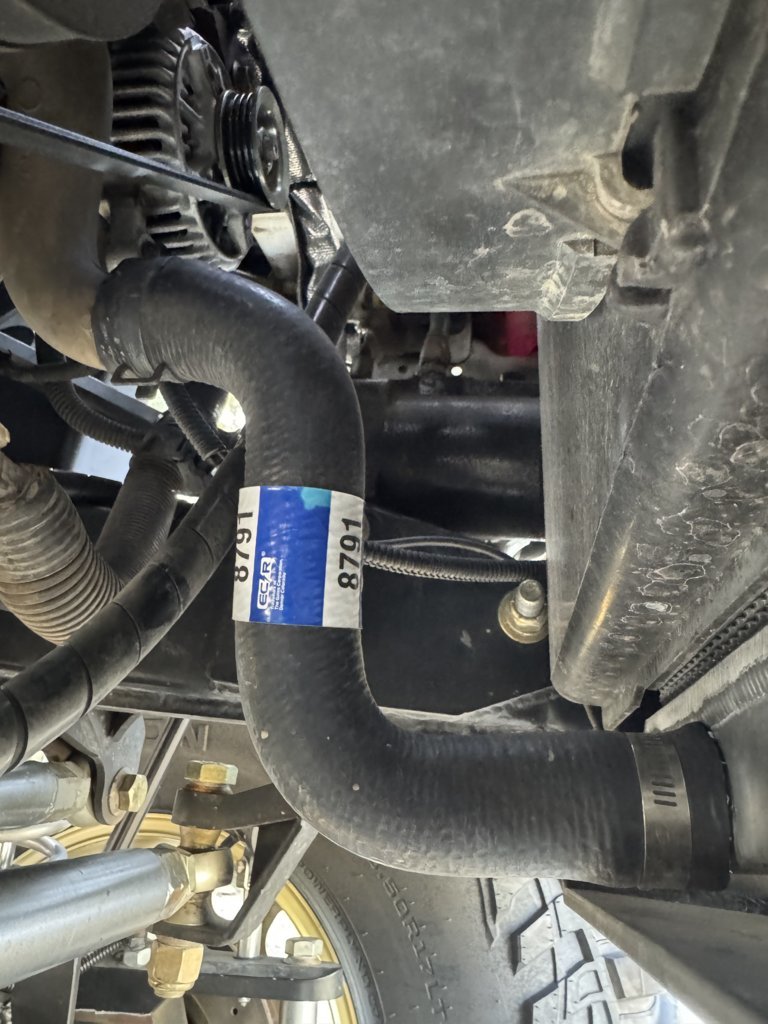

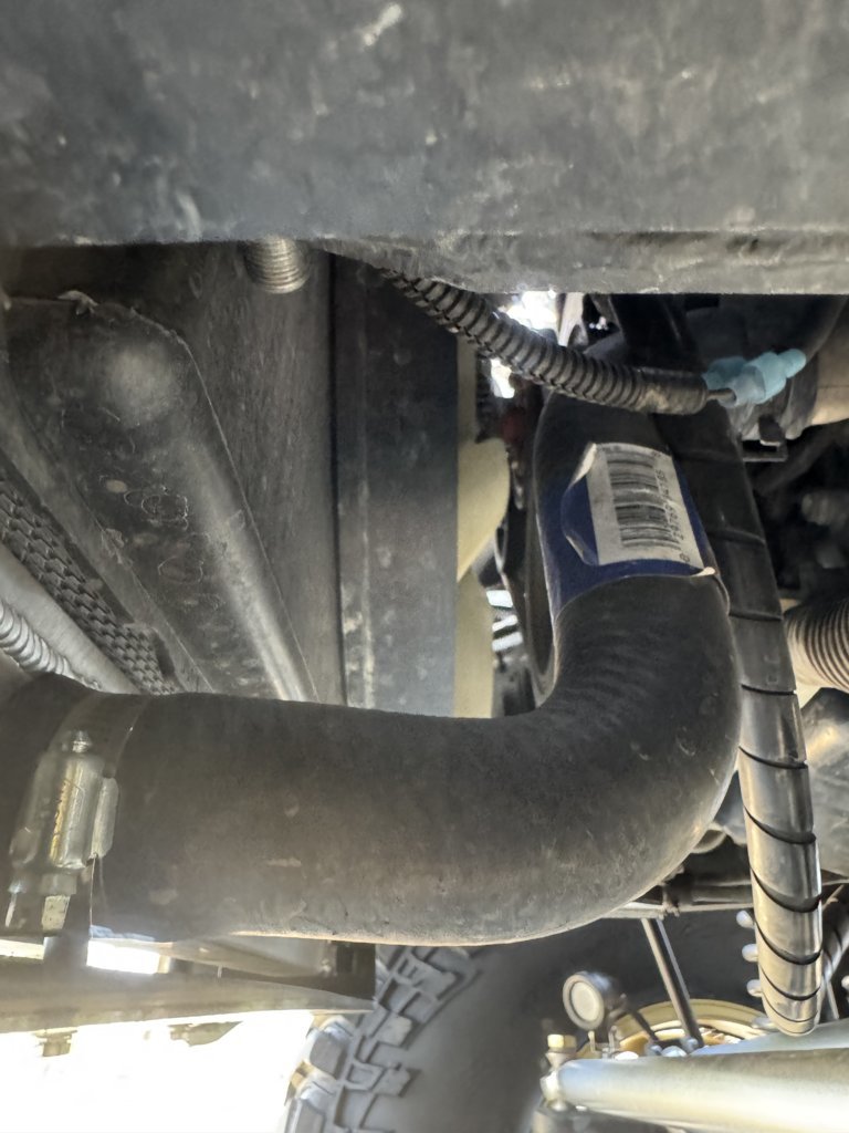

    Since we were talking about radiators... @02hilux were those hose part numbers for the 18.75" core radiator?
  9. Mar 28, 2025 at 6:58 PM
    02hilux
    02hilux What do you mean there’s no road, I’m here
    Sep 14, 2016
    #197244
    6,521
    Planet: EARTH
    I can’t confirm but I used it on Denso 221-3136 with the 20” core height.
    I’ll look at my lower in a bit and see if it will fit the 18”
    Chadr7858[QUOTED] likes this.

    Dayco C71765 or Gates 22120 hose is the ticket for the 2.4l 18.75" core radiator. No more ghetto splice job.
    Tacofire98 likes this.
  12. Mar 30, 2025 at 3:48 PM
    02hilux
    Sep 14, 2016
    #197244
    6,521
    Planet: EARTH
    Glad 22120 worked
    Chadr7858 likes this.

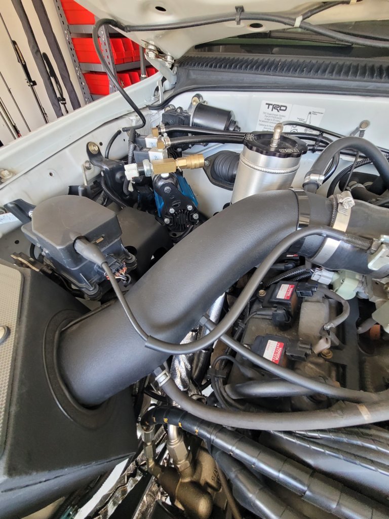

    Are most of ya doing the swap deleting the abs? Seems like an unnecessary unit at this point.
    Windigo likes this.

    Planet: EARTH
    I delete mine years before swap for a first gen

    Yeah remove it and the extra lines. Then use that space to put in a small air locker compressor or power distro block.
