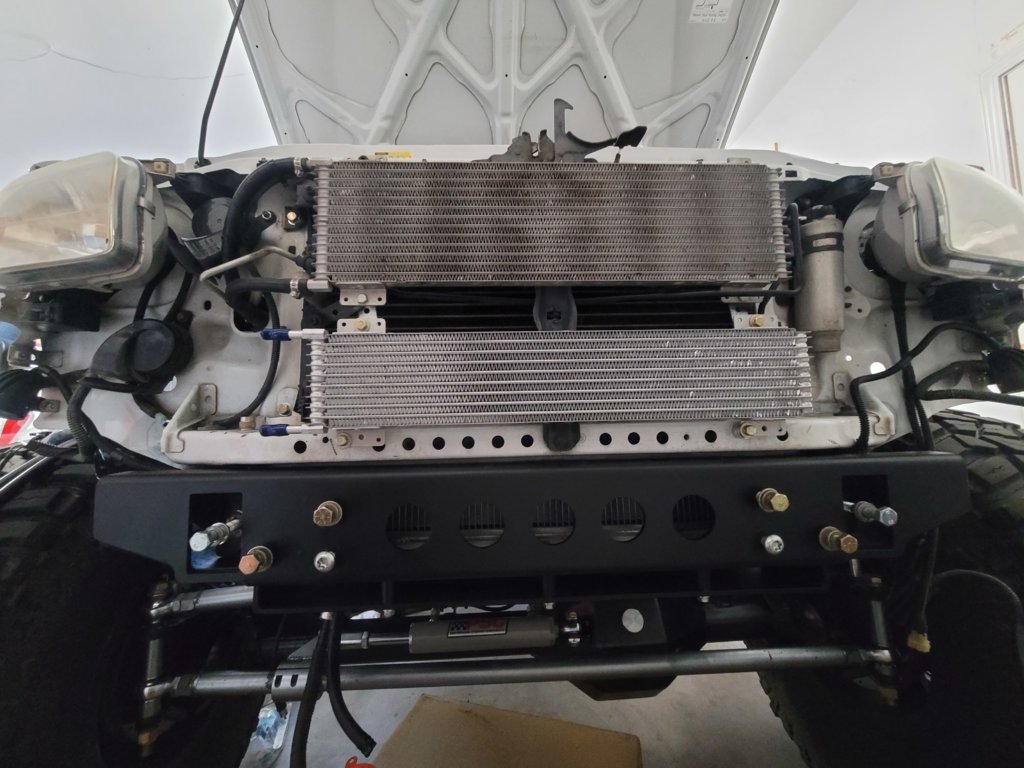

    my radiator skid. Way overkill in thickennumss!

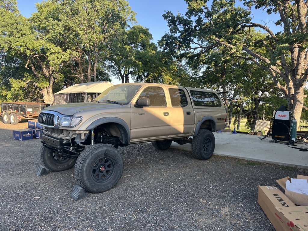

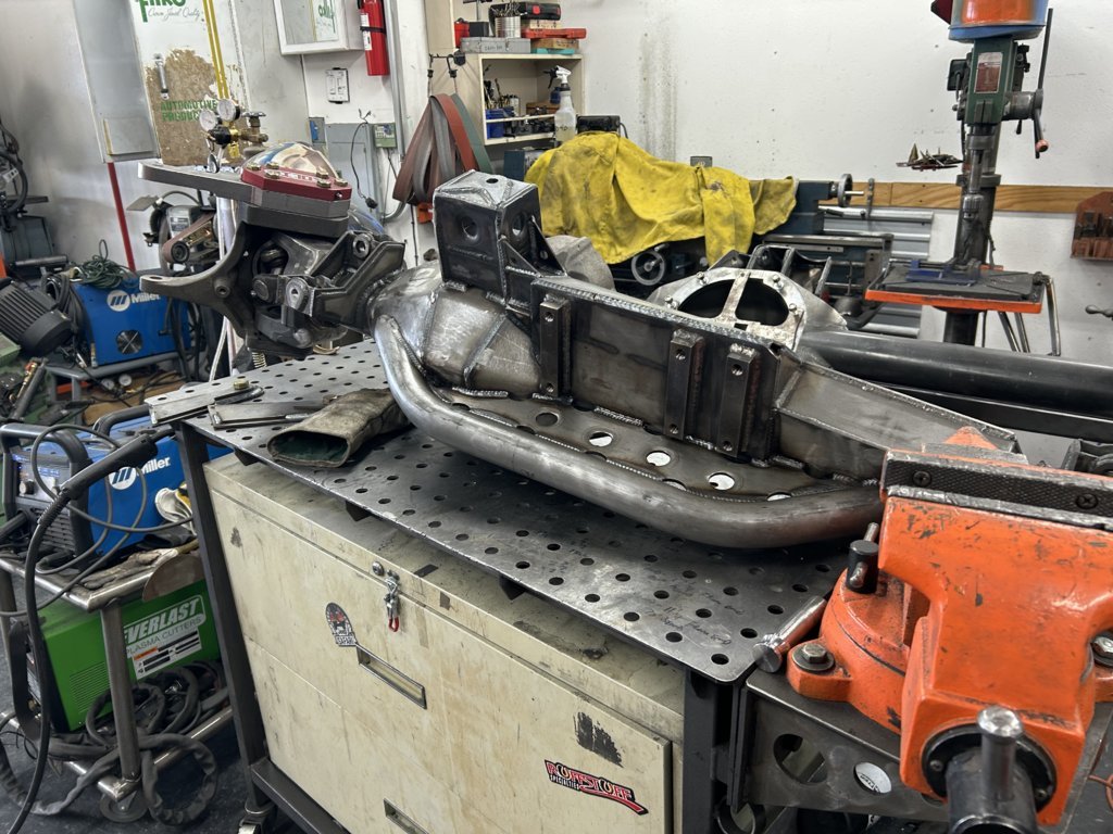

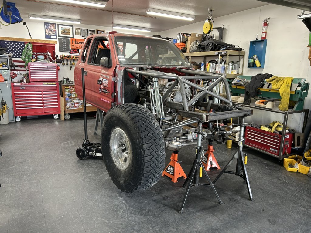

    IMG_2189.jpgAlmost done…

    I have to do the rear now, I have 3” allpro leaf on now, seriously low, gonna think about it for a bit, maybe aal for a few, while the front settles in, then 63s possibly.
    Looking on Craigslist and marketplace for tires to get me by til winter 37s
    I have some 16” rims and a set of 17” 4Runner rims, seems like 17” has more of an option for rubber
