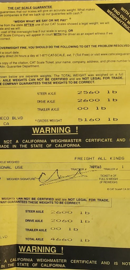

    This loaded / unloaded weights with driver?
    Loaded heavy I’m 2740 front 2720 rear
    Minor tools and spare I’m 2640 front 2400 rear
    But 4runner.

    With driver. Loaded
    iirc was like 4800+ unloaded with driver. Gas levels likely differed between those two measurements too.
    I don't carry a spare, but most tools and recovery equipt stay in the truck
