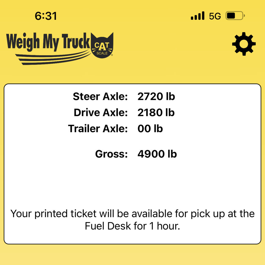

    Fully loaded and ready to wheel with a full tank of gas and me in the driver’s seat. First gen truggy on a toy based fabbed front housing and an FZJ80 rear
