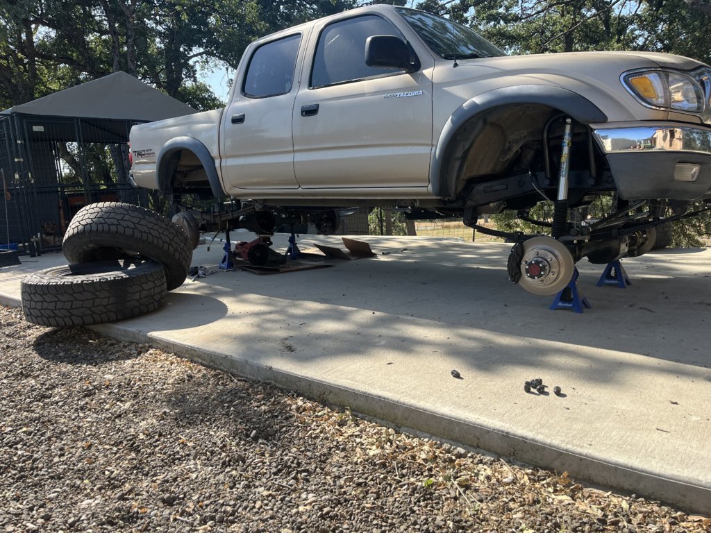

    IMG_20250607_222004.jpgOut of the garage

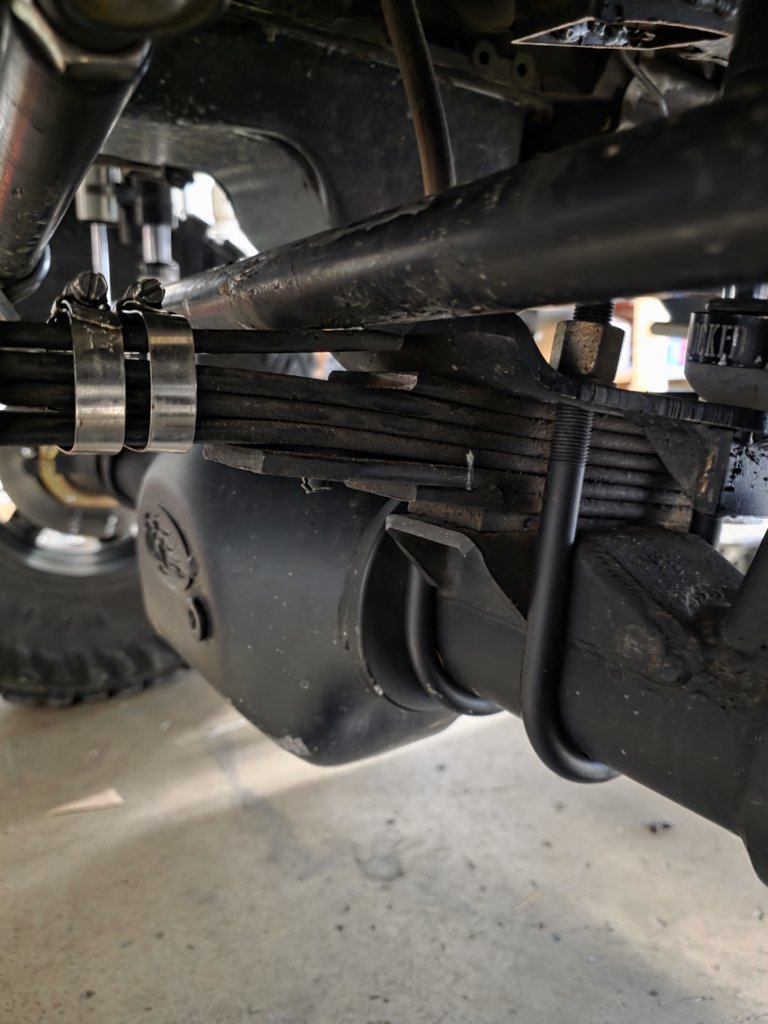

    Last stage, gears, driveline, check all nuts and bolts for torque, lube, tires, then drive it for the summer.IMG_2372.jpg
    Should be ready for next weekend
