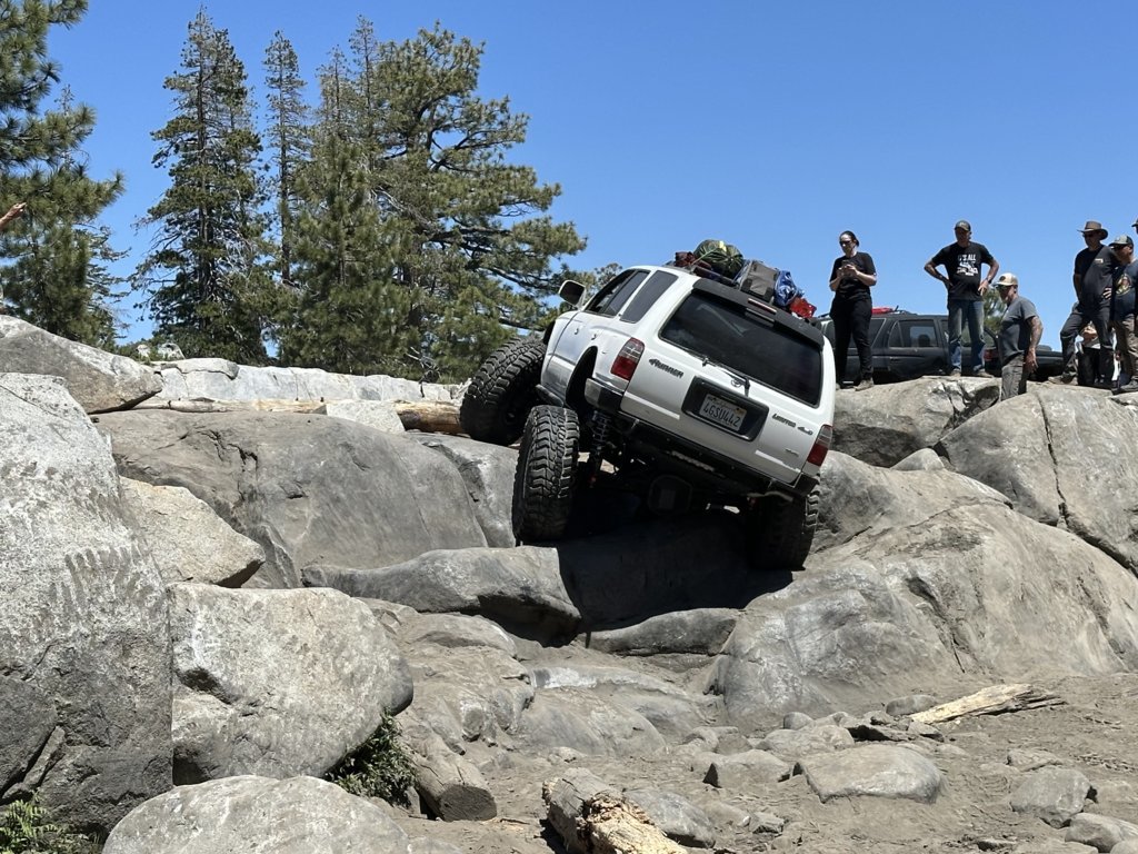

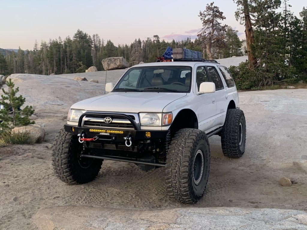

    First trip is in the books after the SAS, completed the Rubicon Trail (attended the Rubithon event last week). I took my wife and 2.5yo son, drove to the trail (from San Diego, no trailering), made it through the trail, and drove back home without any issues.
    I made it up Soupbowl which was awesome! Someone there said they thought I was the first 3rd gen 4Runner to complete that obstacle, anyone here know if that’s true or not?

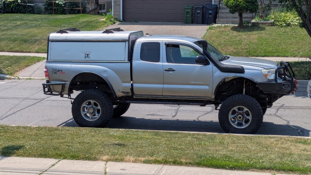

    Heat is a pic of my 14 Tacoma with solid axles.
    Definitely not on the same level as the builds I see on this thread but I'll keep working on it.

    Not true, I seen a handful of third gen up soup bowl. There’s a bunch of capable 3G 4Runner in Sac area.

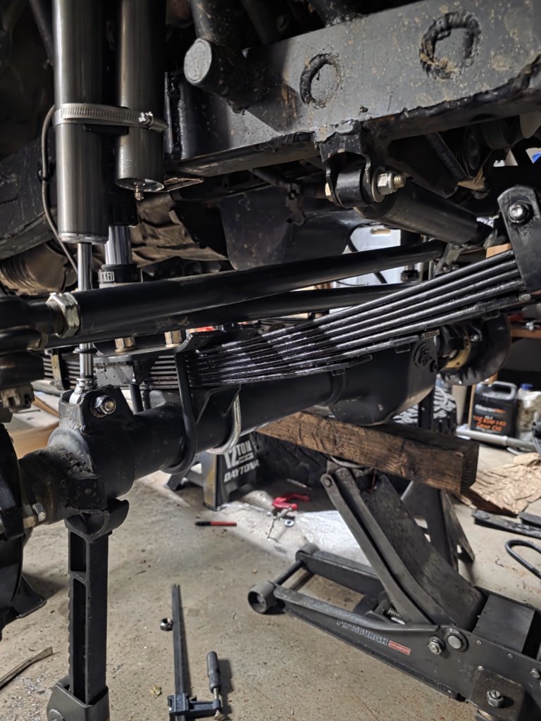

    Here's a picture of the front and rear axles that I swapped in. Still working on it but it's getting there.

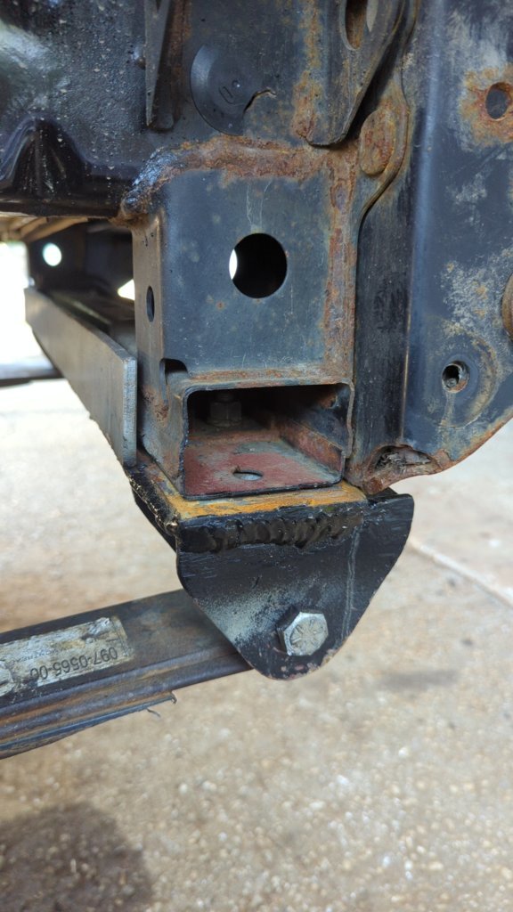

    hopefully the front axle hanger isn’t 1/8” thick (picture can be deceiving) and at a minimum 3/16” or 1/4”. I seen 3/16” square/rectanglar tube buckle/warp/bend with weight/impact over time.
    also, the rear brake lines at the end, why not run out over the springs? Anything that hangs will become anchor and the last things you want is a broken brake line on the trail.

    Yep the flex lines front and rear somewhat stuck on and over axle believe it or not I never thought of that.
    The spring hanger is almost a quarter inch thick but it does bolt up to the existing crossmember. Hopefully it's not going to be a problem. Here's a picture

    Majority of the folks who built their rigs aren’t on the gram or facebook. Like me. lol. I’m surprised I’m on TW, haha. So it’ll be hard to find a specific rig complete a specific obstacle. It’s 2025, I’m sure many had done it in the late 90s with their 3G4R at one point or another. Glad you made it up and got it checked off from your radar list. Hopefully Dusy Ershim is on your radar, it’s 3x more difficult and longer to complete vs Rubicon.
