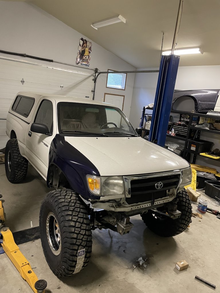

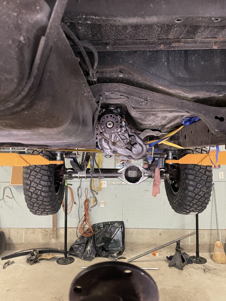

    Diff clearance of a diamond 8” housing with 37” KM3’s at 25ish psi. 12.75”

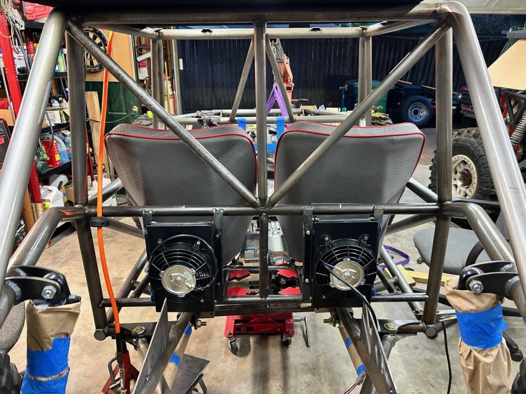

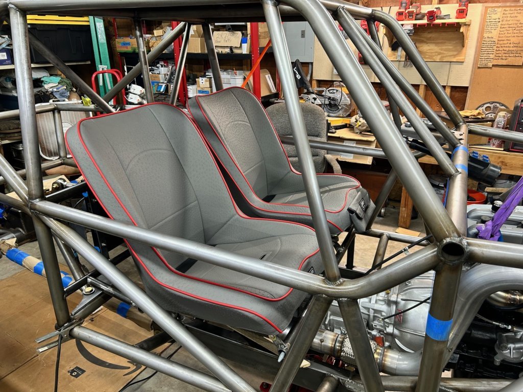

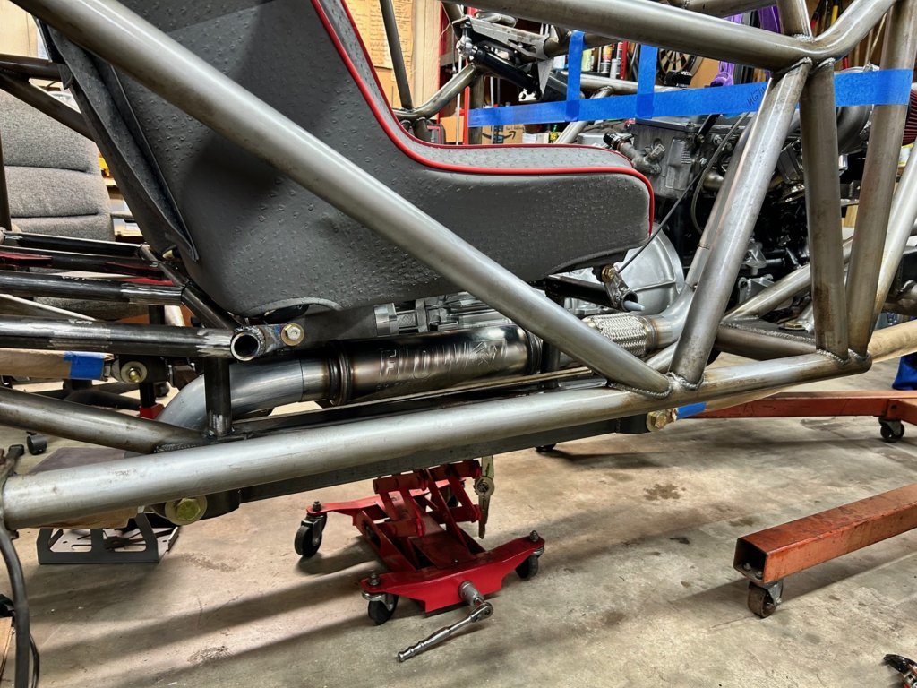

    Seats are in Almost ready to wheel lol

    I don't know what you mean by a parts list but I do have the Martec kit for the front of my Tacoma. I'm still buttoning up some things so I couldn't tell you how it works. I will say it makes it super easy to put links in the front. The kit portion of the build was the quickest part. Getting the steering, brakes and axles are the tedious part for me.

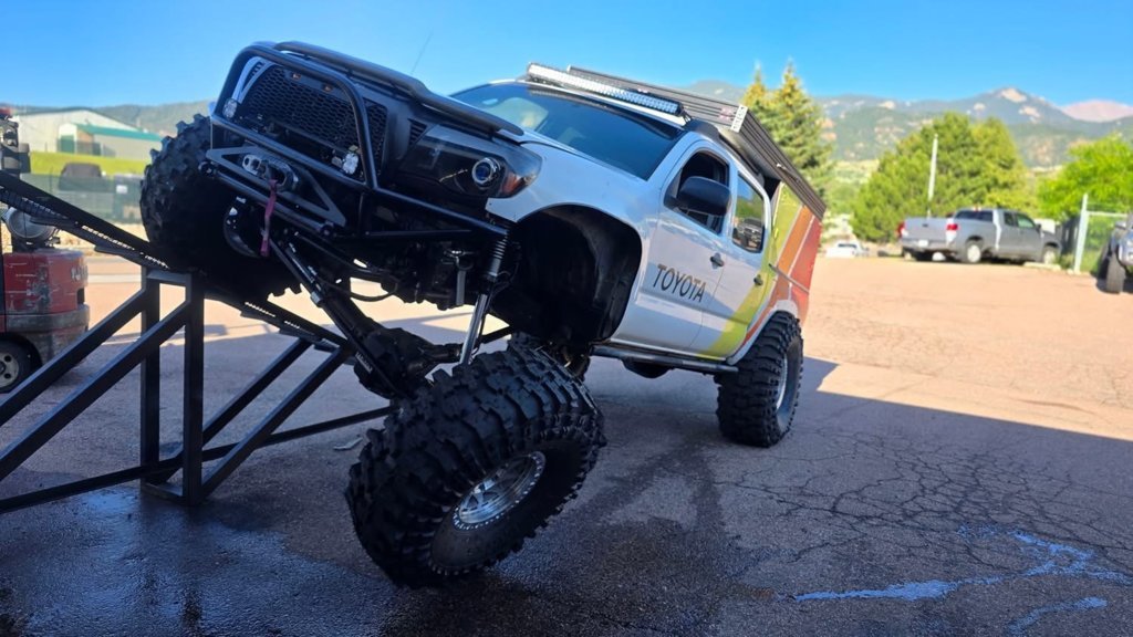

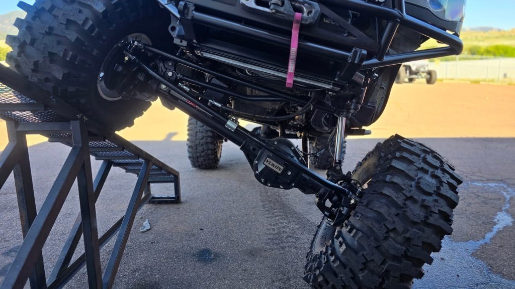

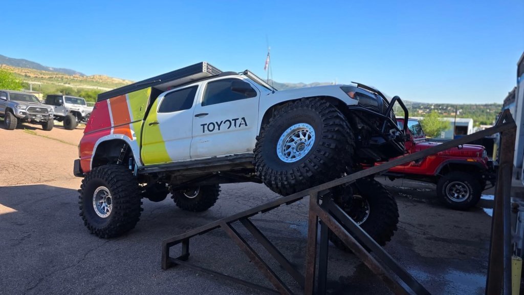

    This trek, has taken longer than I thought it would, and still not quite there….. But almost….

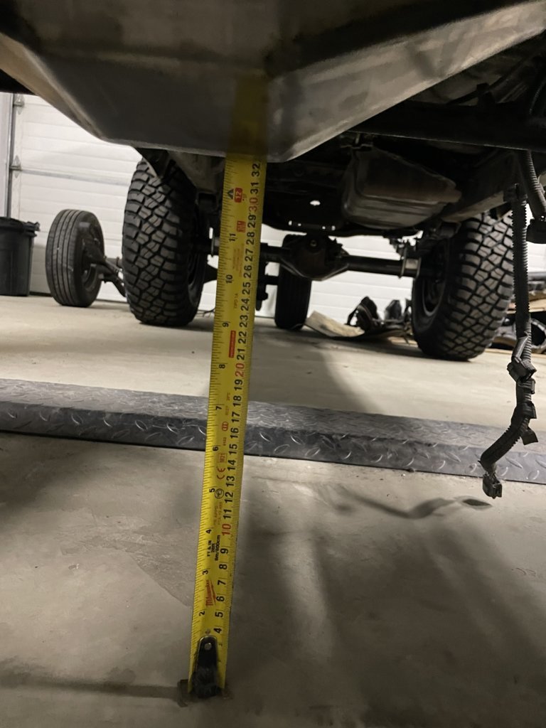

    What is everyone’s thought on Belly height. Current build is 24” to the frame. 5.5” uptravel. 108” wheelbase with 37” tires. (It should setting .5”-1”. I have leaves up front and have limited droop so the leaves don’t fan out and unload for “fake” droop. Belly height is about 20” but I could get another inch or two if I cut a small wedge into the floor where the rear case (running duals) starts to contact.
    Worth it or keep the floor stock?
    I’ve already massaged the floor with a 2x4 and a jack.

    That's pretty damn good, considering it's on leaf springs.

    The key is not running high steer. Or not having a running driving example :blahblah:

    What an amazing transformation,and its all so professionally done. I looks great and from the pictures it works great.

    Short wheel base would be better to be a little lower imo, but those travel numbers make the little extra height worth it. I’m 20-21” on 37s at 127” WB, and I’m super happy with it wheeling.

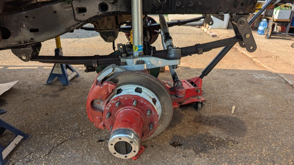

    I wanted this pic in hear to show one of the many way a SAS can be done on these trucks.

    I'm going to post this on the build thread thanks for asking haven't though about it in detail before.
    :rofl:ok you got me, "solid axle swaps" and "budget build" are not to be used in the same sentence, but looking at some of the builds on hear do feel I'm pretty cheep with this build.
    I had the axles hence the pass. side 60 just a little referb needed
    the t case adapter 3k
    the dana 300 has been in my tj, buggy, xj and now taco.
    p/s pump from my 2nd gen runner
    reused my rear drive shaft
    front drive shaft not there yet/ front crossmember not done
    leaf springs and associated parts to go with leafs had laying around
    steering shaft (not happy with) came from my runner
    makde up some shifters
    had the shocks was supposed to put them on the rear 150 i think
    shocks hoops Amazon 150 i think
    steering box (s) im on the second one, had them
    all the other little stuff oils bolts front end parts brake parts bearings other things cant even think of, yokes u joints leaf spring bushings ect.
    im going to guess its about 2k or more, all my metal I've used had laying around, junk yard parts, rims from my runner, tires from my tacoma
    I'll just call it 6k.
    this will include cutting discs, welding wire and gas gloves hardware everything
    and the arguments between the wife and me were free so that helped:):):)
