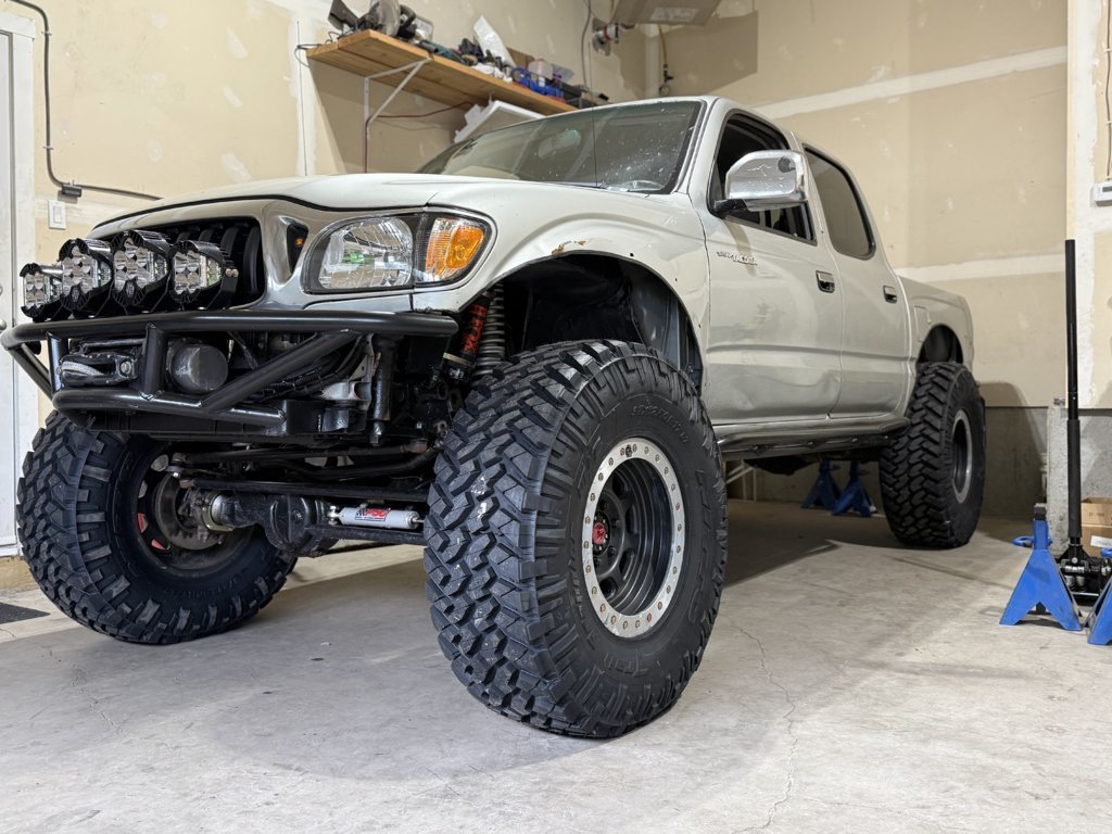

    Wish I could be a tiny bit lower but I think its a reasonable compromise. If i can make the steering fit, the limit of up travel will be the u-bolt plate/u-bolts meeting the frame. At that point the spring is 2.5 -3" negative so I probably don't need to hunt for any more lol.

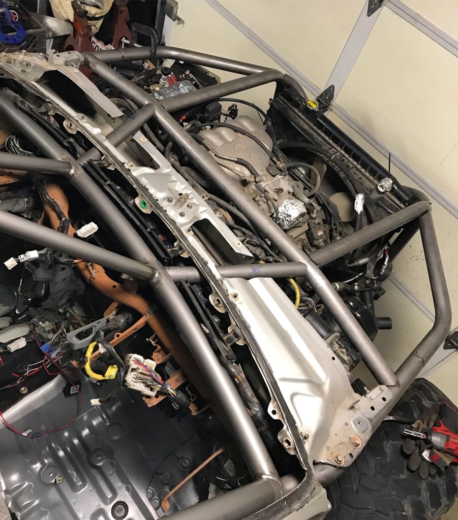

    Who’s got some engine cage photos? Need to get after mine since the rad support is cracked. This is probably a good place to start getting some motivation.
  4. Jul 21, 2025 at 7:19 PM
    malburg114
    malburg114 Well-Known Member
    Dec 26, 2012
    #93766
    3,820
    Las Vegas, NV
    2001 Toyota Tacoma TRD
    Check both my builds under my name. My white truck I did one. The red 4 door I did one as well tied to a cab cage. The red extra cab is the same idea as the 4door.

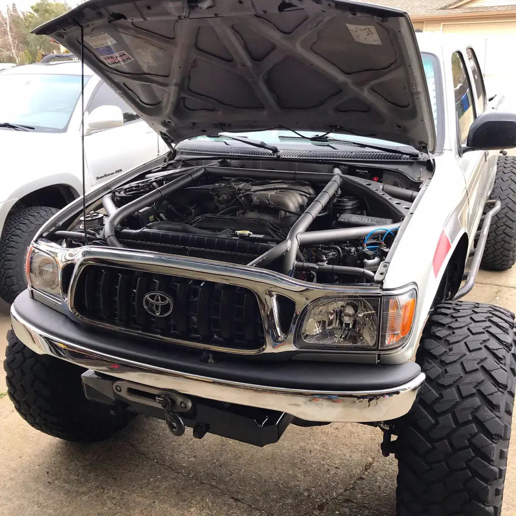

    How elaborate do you want to get? Here is what I did on my old silver double cab. Everything was mounted on tube even the headlights, grill, radiators

    Just gotta say......... That's some nice work!

    Glad you replied to this, your old truck is the goal eventually haha. That’s exactly what I want to do, but I’m not ready for full interior cage yet.. so just planning how to build the engine cage and leave it easy to tie into once the interior cage comes.
