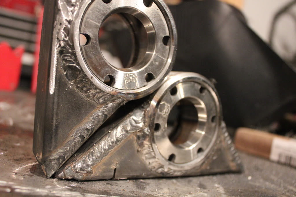

    x2 I love the Ballistic joints. Only issue I had was a little warping from welding them to make shackle hangers. That made the threaded ring a bit challenging to get in and out... but I suck at welding anyway, I shouldn't have welded them so fast.. So it's an easily avoidable situation. They're awesome, overall, and simply bullet-proof.
    I had zero issues with them. :notsure:
