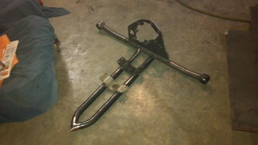

    Can't remember who was asking about it but this is what I was talking about for a dual case cross member/mount.

    That was me haha
    I like. Is there someplace you can get the plate that mounts up to the tcase like that, or does everyone fab their own?

    Front Range Offroad sells a Tacoma one that you can do whatever you want with. I will probably use it myself :) I believe it's only like $100 with hardware?

    If your using toy cases low range sells just the plate you see in the pic, link. FROR has the tacoma one but not sure I like as much as the others, link. If it were me I'd add alot of beef to the FROR piece. Just make sure you use the same mount material through out. It it possible to break a case in half with this style mount if done incorrectly.
