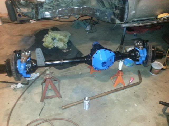

    Kinda pulled this out of my @$$ today... trying to get a rough idea on how things are gonna fit. Thoughts?
    Also, any suggestions on how I could modify/reroute the cat?

    Hood stack :D
