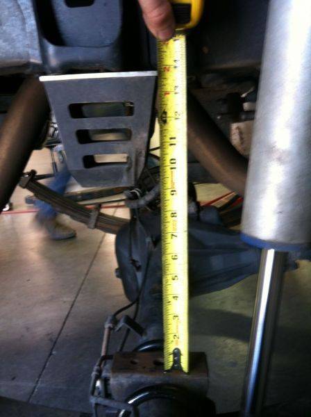

    Smashed on the truck today...The front end did amazing (but that was expected). The real surprise was the DMZ spring under kit. Wow! It didnt feel as good as my last linked ranger but it felt pretty smooth. I was shocked with the amount of up travel the springs are capable of...way better than a standard replacement deaver pack.

    Any plans on redoing your rear now? From the time I spent with the Defined kit I couldn't imagine have 19" of travel up front and that in the rear...I know Mike says 15" but I've never seen anyone get more than 14" out of the kit.

    13.9ish"

    I did my install myself and pulled 14.5" out of mine but it bumps at frame and I had to pull third leaf out cause it runs super stiff. Way better than stock but should have gone with giant or Dmz

    Yeah the set up works well. I'm getting 9" of up travel with the kit..nothing to complain about for leafs.
