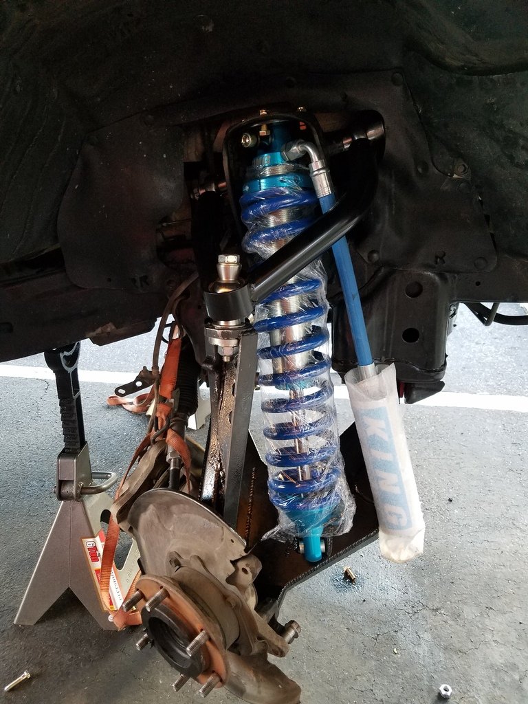

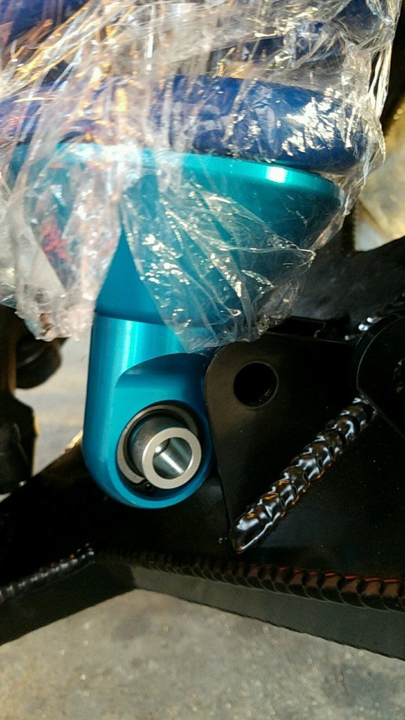

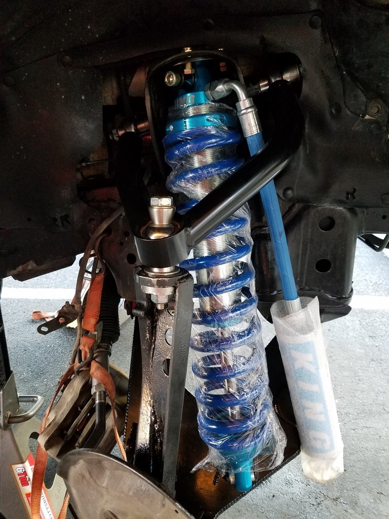

    Hello TW,
    After 8 years of window shopping and saying what if I finally bought a long travel kit. I went with the Solo Motorsports 3.5 LT Kit for the 96-04 3.4 Tacoma. I bought brand new 2.5 x 8" Kings from DownSouth Motorsports and they arrived last week. I had considered paying a shop to install the kit but I also wanted to attempt to do it myself. I kind of figure that I dont deserve to go long travel if I cant start to do some of this on my own and learn a thing or two. I'm not a newb but not a pro either. I was confident that it was within my abilities so I attempted the install myself. It took two and half afternoons after work to get everything off the truck. I was then able to get most of the kit on during the day on Saturday. Sunday I welded the Total Chaos spindle gussets and then installed the spindle/knuckle/hub. I ran out of daylight so I picked up with the shock install Monday afternoon after I got home from work.
    This is where the fun starts... I put the shock in the coil bucket and get it bolted in but the shock is about 1 inch too long for the kit.... I'm pretty sure the kit is at full droop and the upper misalignment spacer for the upper uniball is almost near bind or very close... If I have done my reading correctly over the years, shouldn't this 8" CO fit the distance between mount to mount at full droop? I can't understand why this is happening??? The CO is 24" eye to eye and is the exact CO that Solo told me that I needed. Is it possible that I have the misalignments wrong on the upper and Im getting some uniball bind about an inch before full droop? I guess I should say that Im using brand new lower ball joints (stock), brand new outer tie rod and inner ball (stock)... the kit looks perfect this is seriously racking my brain... Not that this should matter because I feel almost as capable as another person but I'm a paraplegic in a wheelchair so needless to say that after 4 days of doing this install, I'm worn the F#CK out! LOL This isn't how I pictured this going...
    I was really reluctant to make a post because I kind of feel like an idiot. I pry screwed up somewhere in the process and Im a little embarrassed but Im happy that I gave it a shot. That being said, I'm putting my ego aside and hopefully you guys wont be too hard on me lol. I decided I have to reach out for help now because I dont know what it could possibly be... I have posted some pics below so that you can see what Im working with...
    Any help is greatly appreciated!
    THANKS TW!!

    The shock doesn't look like its aligned in the adaptor plate, and the plate isnt oriented in the coil bucket correctly. Rotate the coilover 180degrees on the adaptor plate, and reinstall so the reservoir line sticks outwards. Then it should sit in the coilbucket all the way and gain the clearance you need

    The coilovers is fine in the adapter plate, but he lined up the holes to the coil bucket wrong. Just needs to rotate the top plate 120* so the rest fitting is perpendicular to the frame (as you mentioned).
    The reality is even that's not going to give him enough clearance as this is a two person job. Unscrew the preload collar all the way out so all the preload out of the coil. Two person job because one to set the bolts and another to stand on top of a pry bar on the LCA

    Also a hell of a lot easier if you get the spindle out of the way. Install the spindle last because you can jack the LCA up in order to set the 4 bolts from the lower pivot into the spindle.

    Shit. I stand corrected @MrCrowntown. You are dead on correct with rotating the shock 180 degrees. And rotate the top plate 120 degrees. This work bullshit I do is interfering with my internetting.

    Thank @MrCrowntown too. He was 100% correct in his assessment too. I just added to it and was too quick in my reply an didn't pay full attention to the photos. The goal is to have the bolt that goes through the upper shock eyelet and the top plate adapter to be parallel to the frame. Let me know if it doesn't make sense and I can draw something on a bar napkin.
