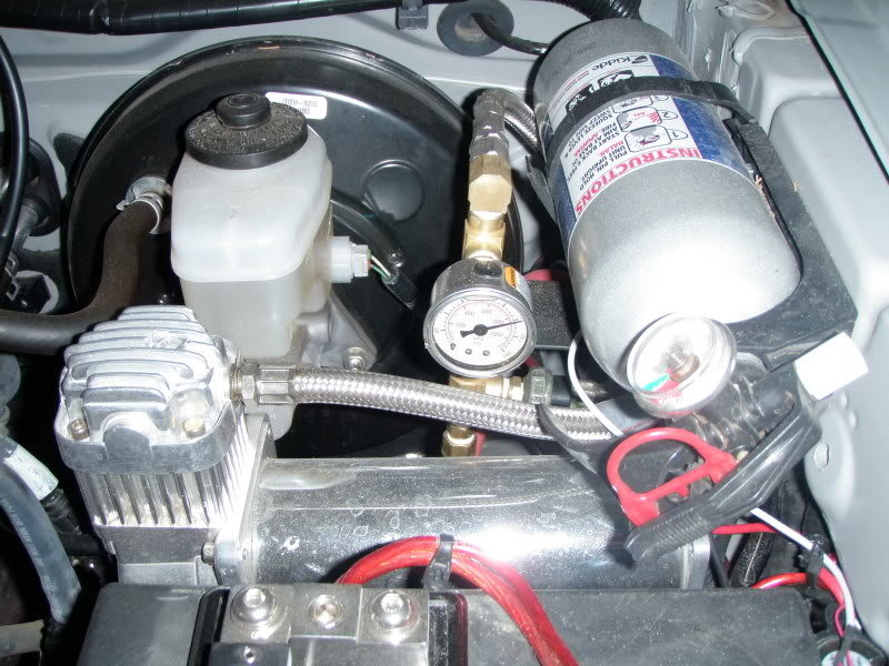

    Hard wire one in and forget about it. It's always there and waiting.

    Kilo - can you give some detail as to how you did this. I am REALLY wanting to do this with the compressor I have (MV-50?). I would definitely want this if the extra tank is something not too expensive.
    A write-up would be AWESOME dude!

    i have the MV-50 and it did all four tires from 20 up to 35 in like 15 minutes w/o overheating

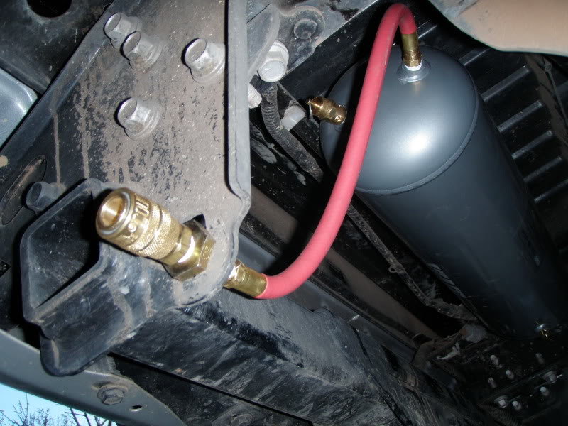

    I got one of the Sun Performance Compressors in a group buy on CT. 100% duty cycle at 200psi. Its probably one of the best things ive done. I also did a 2.5 gallon tank so airing up is pretty quick.

    According to Sears it draws 3.3 amps. 3.3x120= 396Watts. Almost the max of the inverter.
    From what I understand at cold temps it becomes pretty useless.
    I went with a ARB air compressor (CKMA12 high output) for the FJ and will buy one again for the Tacoma. TRDParts4U has them I think for $230 now. I'm able to air up 4 265/75 16's from 15psi to 36psi in 12 minutes. The compressor comes with the wiring loom, pressure switch, relays and extra connectors to wire in two lockers if need be.
