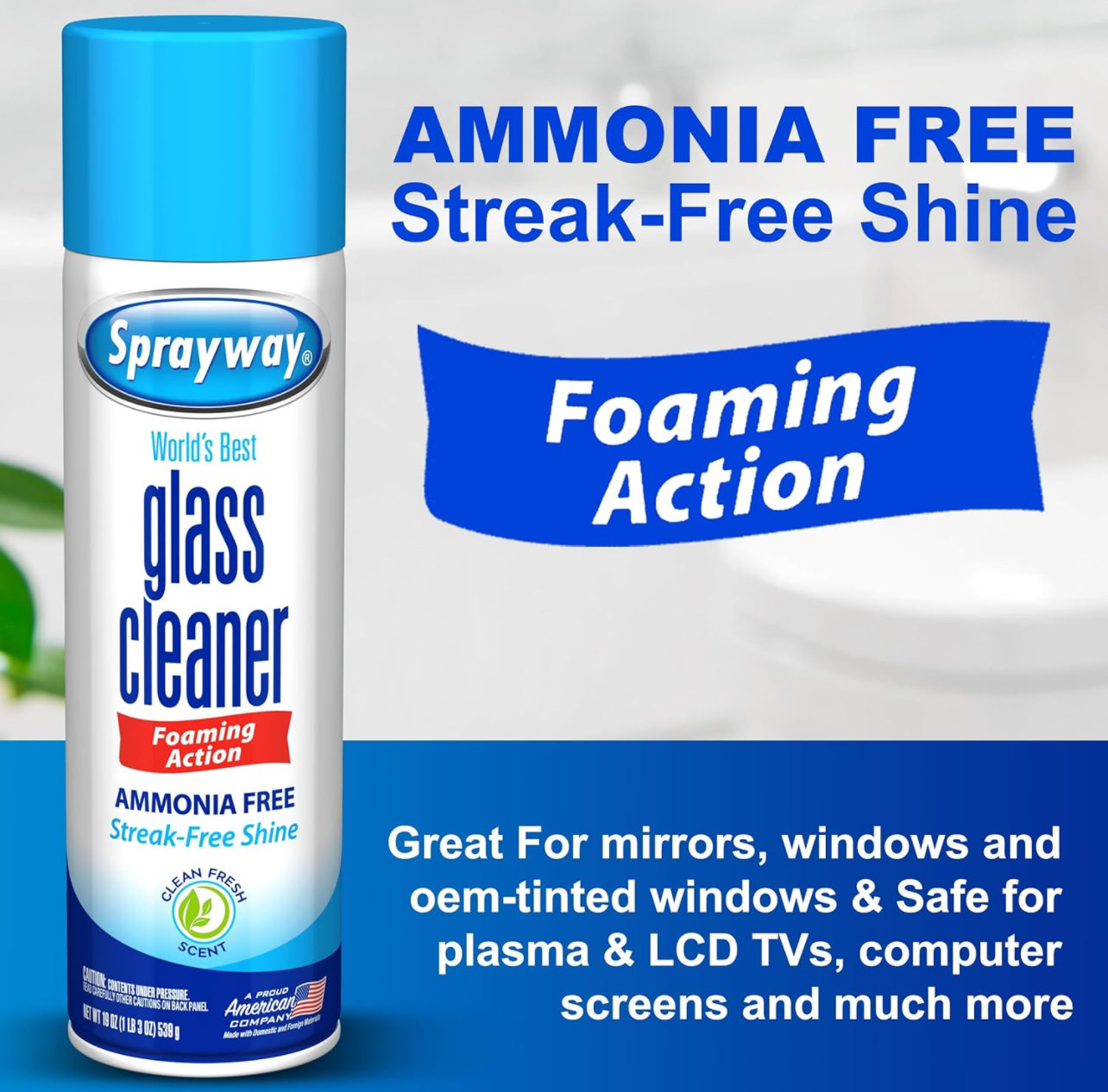

    This is what I use to remove my Dogs nose art from my back windows. I also clean my wiper blades with it IMG_8813.jpg

    It's good but it's not make chatter go bye bye good. There used to be a little cleaning lady on the can, she's gone now. Kinda miss that.
