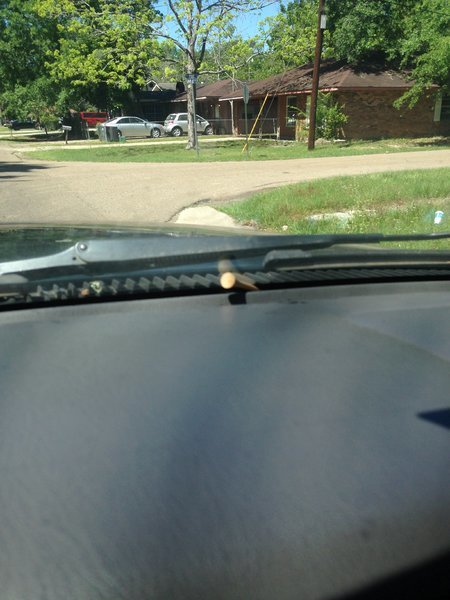

    My golf tee has literally worked for 15 years lol
