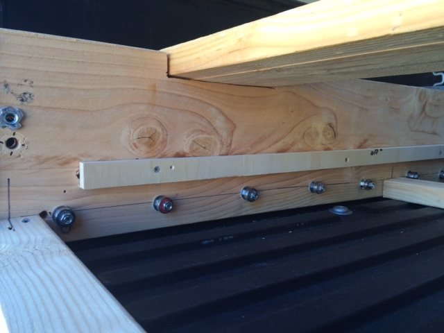

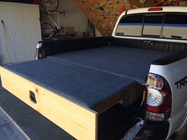

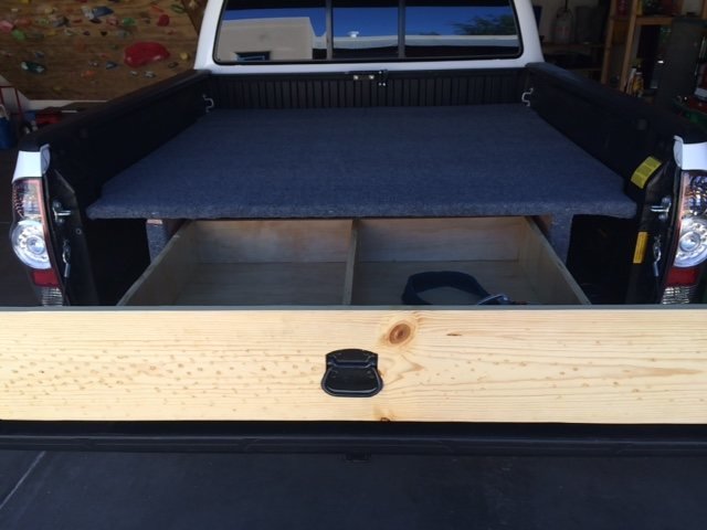

    I plan on doing this with a bed tent except a 3 piece instead of 2; for easy storage up front, and high density memory foam like an RTT.
    I don't take any credit, these are not my pics I got them from (see below)
    https://www.mountainproject.com/forum/topic/108006420/short-bed-tacoma-livin
    For the drawer he used skateboard bearings and a 1"x1" piece of wood as a guide support.
    109700871_medium_041529.jpg 109700875_medium_462c25.jpg 109700878_medium_a62002.jpg 109703322_medium_af4742.jpg

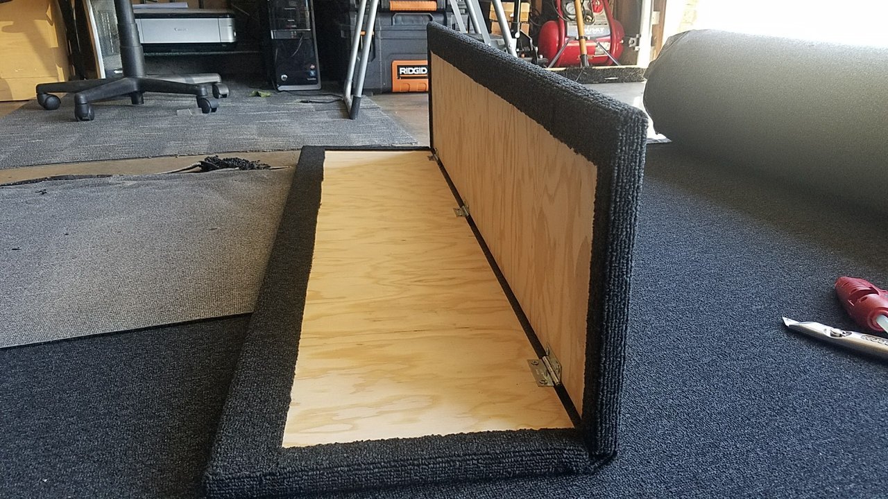

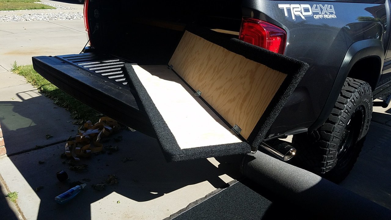

    Start of the sleeping build for a 5ft bed. Quality 5/8 plywood for strength and weight. A pair of 2x6's20170429_095521.jpgCarpet the platform with quality carpet 100% nylon unitary backing for waterproof non mildew properties.
    20170429_143906.jpg Kick platform for the extension to sleep easily folds to slide under platform when not in use. 20170429_160557.jpg
    I also use a support custom made for added strength. View link below for short video on my google + page to see it completed. I made two.
    I am selling one I made for a friend that ended up buying a camper. For the cost of the materials. Works great and I would strongly suggest getting a folding foam matress, a full size fits perfectly in my setup. No air pumps and air matresses always leak no matter how much money you spend on top of the line ones. The 4" thick mattress folds into a 2'x4' piece and is really comfortable.

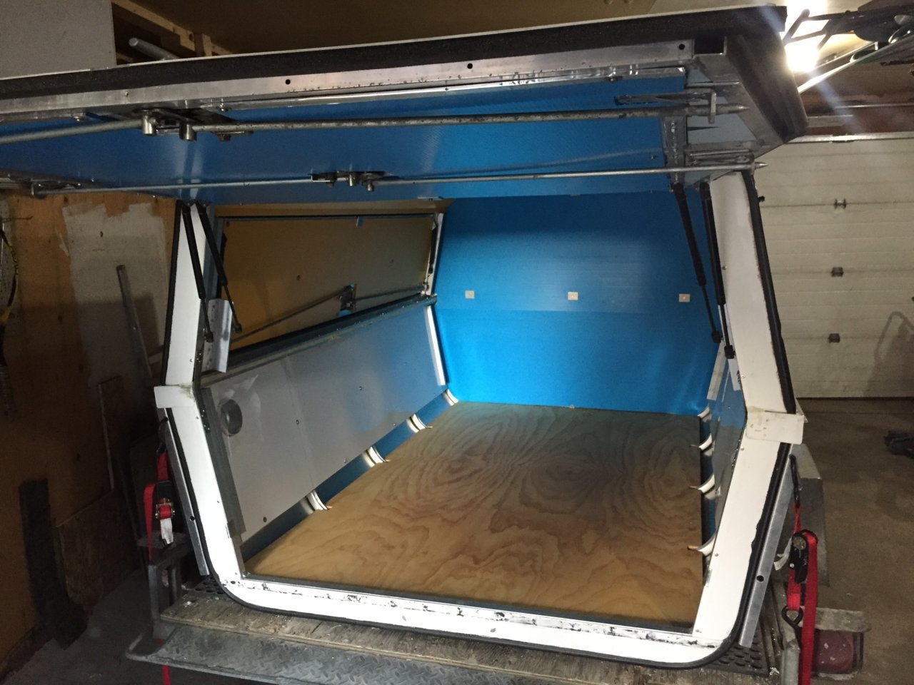

    Got this mostly complete now. It is on a trailer and not in truck, but would fit on your 5ft bed taco’s no problemo (need a small platform to clear wheel wells).
    Just an idea to get your minds turning.
