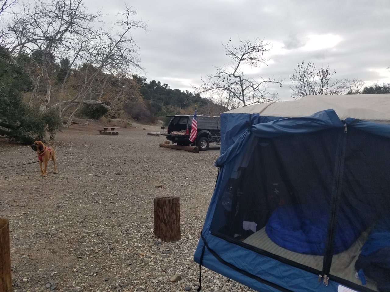

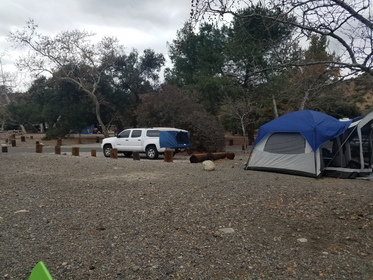

    In my opinion.. If you don't have a RTT or don't want to use a regular tent then I'd go with the DAC tent like I did. Set up is really easy, just find some good spots for 4 to 5 bungee cords to hook onto. Biggest complaint would be that it doesn't hold out water that well, meaning that condensation can accumulate pretty fast if you aren't careful or ready for it.. Then again I've only ever noticed this in heavy rain or when I camp on the beach. I believe I have a solution for next time, which is adding a bungee over and around everything to create a tighter seal. Material is really nice tho and if I had to buy it again I would.. I get people asking me about it all the time when I camp lol
    I believe that their are two sizes, and I'm pretty sure I have the mid-size, but I'll have to check later to confirm, but having the full size might be nice b/c you would have more to work with probably (also depending on how your shell's window door opens may play a role in what size you need)
    Full Size
    https://www.amazon.com/dp/B007WT1GY...t=&hvlocphy=1014420&hvtargid=pla-449723662756
    Mid Size
    https://www.amazon.com/Mid-Size-SUV..._rd_t=40701&psc=1&refRID=QDDNKFSRBS8JVE4WZYSD
    If you have any specific questions lmk, hopefully this helped :thumbsup:

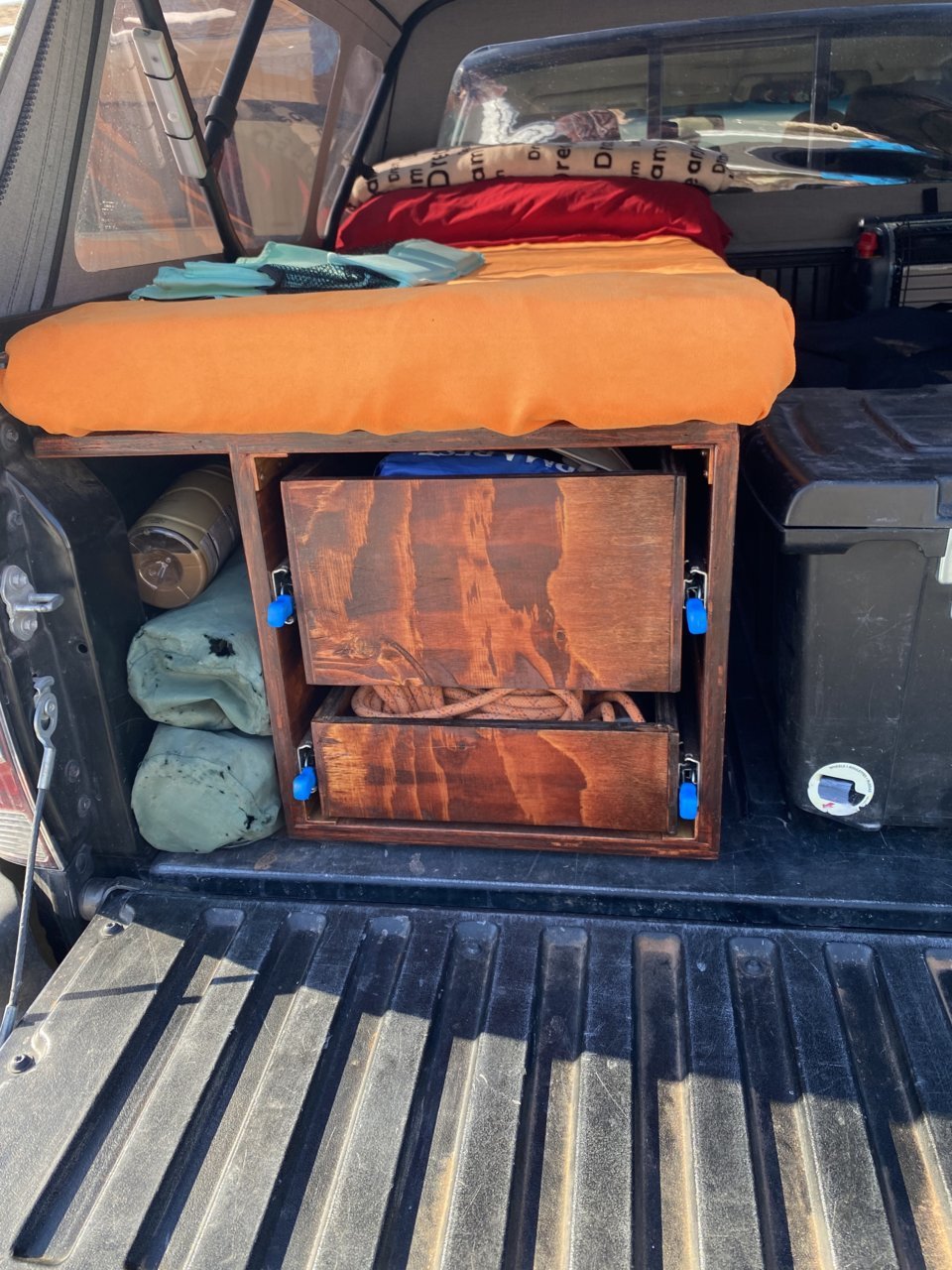

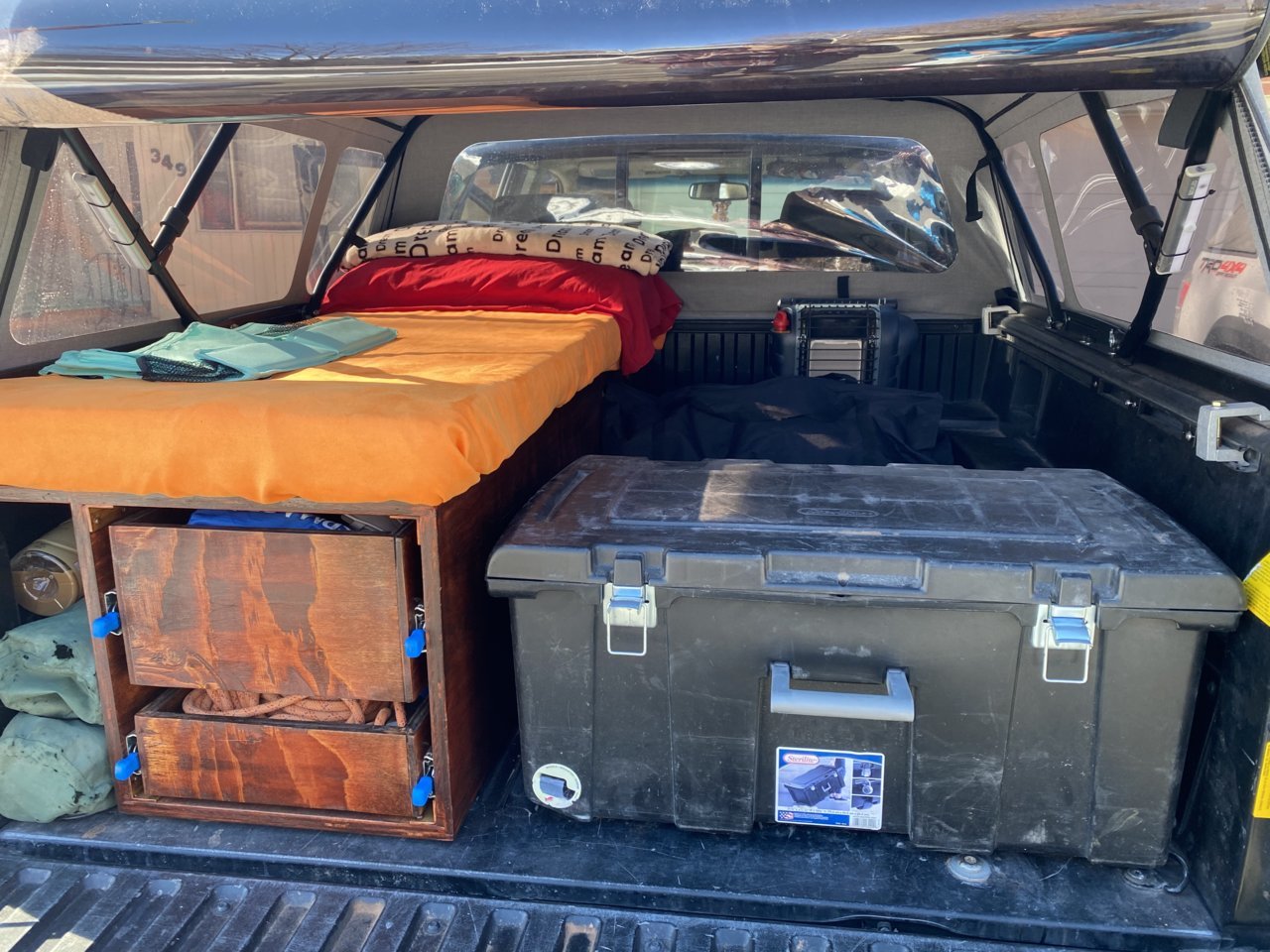

    I have a long bed but my friend has this in her short bed soft taco. She is about 5’6”.

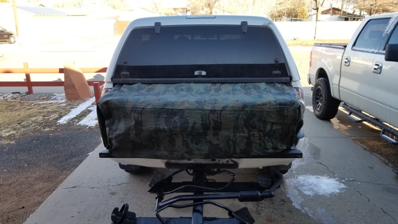

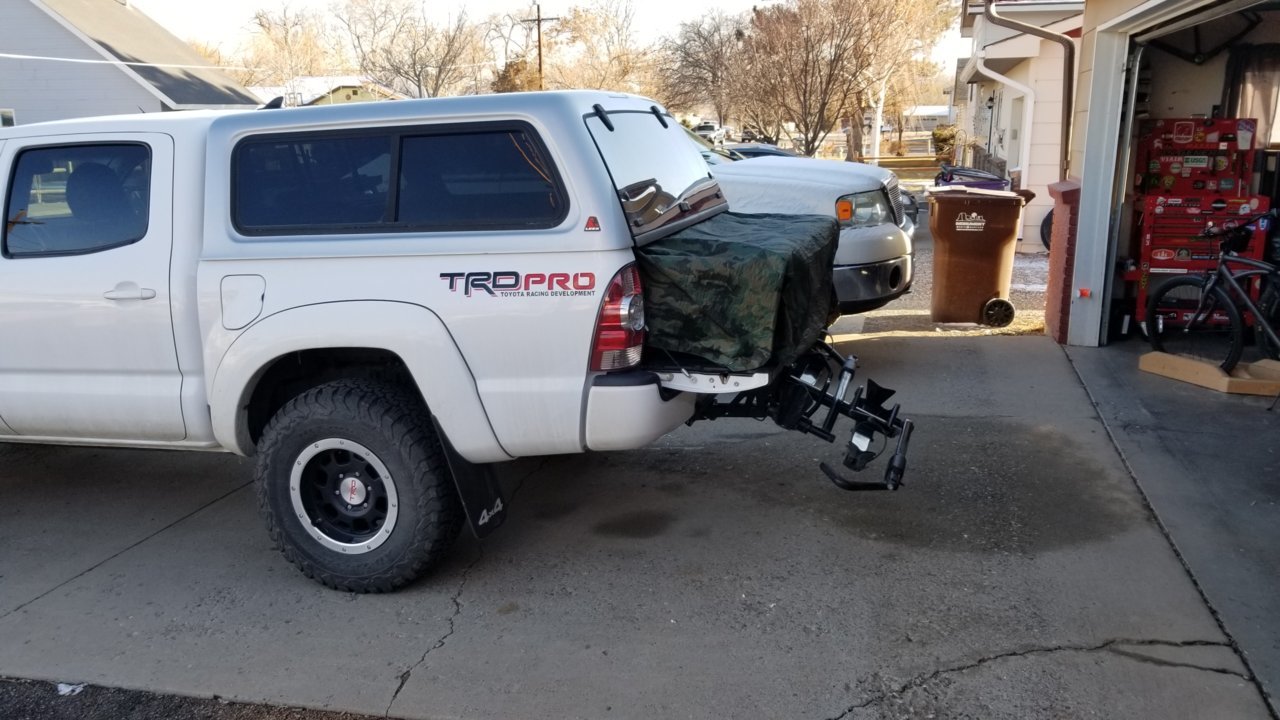

    Here is the set up I made today. I used pvc to make a frame that can be wraped with a tarp. The pvc frame is connected to the bed with carabiners at the bed hooks and the top connection is made with carabiners and paracord connected to the moveable bed cleats. The frame lifts up and down to allow you to enter the bed.
    On the inside the tarp is connected to the topper at the gas strut hinges with wire ties wrapped around the tarp eyelets. Then I have a couple magnets closing the tarp gap near the rear side of the bed. I then tuck the hanging end of the tarp under the 3 legs of the frame. Should stay a little warmer and protect me from wind and light rain. Its nice being able to stretch out. 20210214_170801.jpg 20210214_161659.jpg 20210214_161705.jpg 20210214_161653.jpg

    Nice set up :thumbsup:

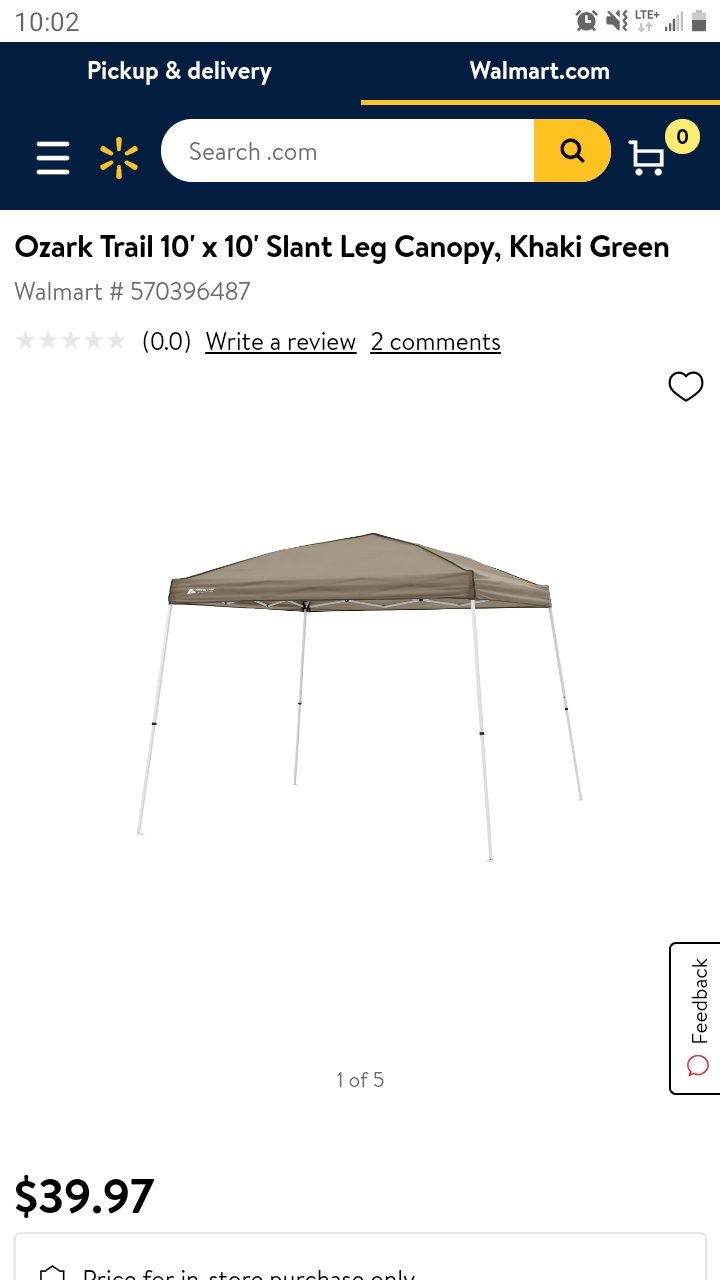

    Heres a random cheap idea If bugs aren't an issue the just pop this up and back under it. If they are an issue do some fabricating and add some mesh walls to it. Also I have a short bed. I'm right at 6ft. I have a camper shell and I just lay angled and sleep in mine just fine.
