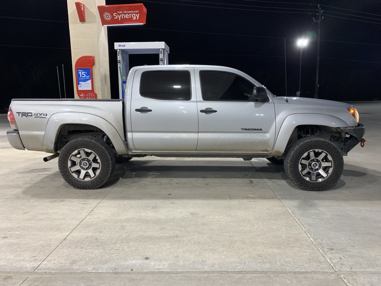

    That’s the way to go. I like A4D31C7F-3309-4696-BBA5-1453023E3CC2.jpg all the scs wheels.

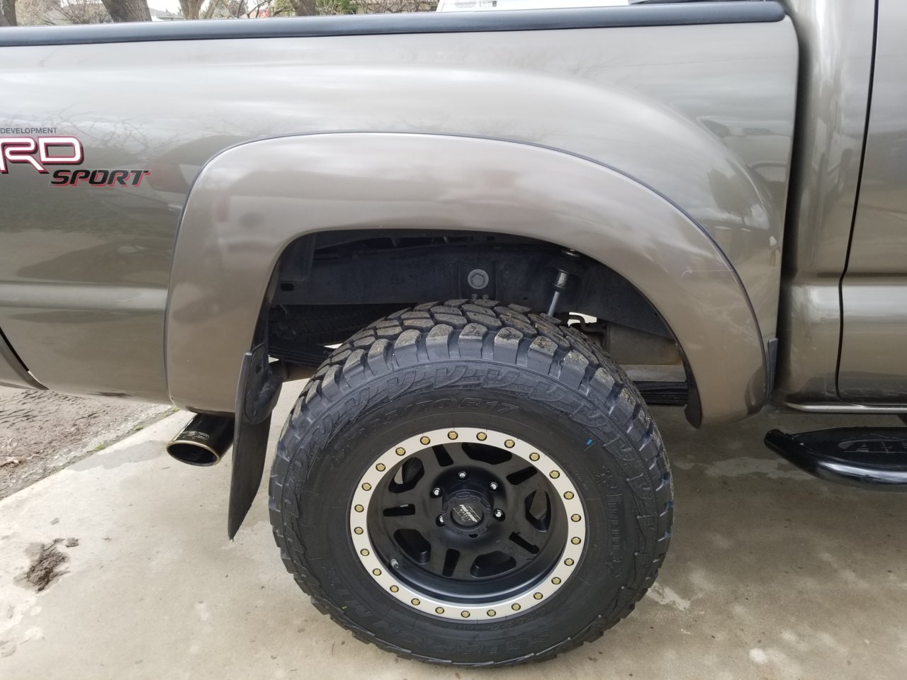

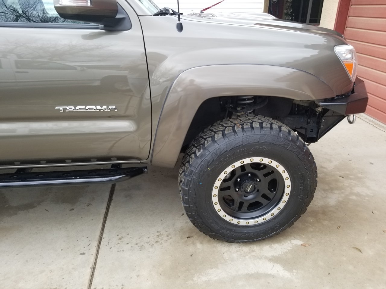

    Gentlemen, the new shoes are on.
    Minor fender trimming. But do need to shave some metal off of the cab mount, it is very very close to working at full lock.
    Now for the novice question; Is it necessary to cut the cab mount or could I just grind it back a little with an angle grinder? (I don’t know how to weld) Only real concern is excessive heat on the cab mount. Any feedback would be much appreciated.

    Brent2014
    Brent2014 Well-Known Member
    Oct 16, 2017
    #233151
    725
    Raleigh
    2020 DCSB TRD SPORT
    I would do the chop. I forget who, but someone sells a pre fabed plate for it. But it’s not super expensive to get someone to cut it and weld it for you. 4wheel parts quoted me $100. I wouldn’t worry about the heat on the cab mount, it seems to be what everyone does.

    nudavinci64
    nudavinci64 Robert @ Holy Horsepower
    Nov 14, 2013
    #116533
    10,145
    Robert
    San Mateo/Cayucos, CA
    13 S/C TRD OffRoad 4x4
    Boosted Money Pit....
    You will new the cab mount chop and some more castor. Maybe even some trimming on liners if you wheel it good.

    JsDCTRD
    JsDCTRD [OP] Well-Known Member
    Nov 27, 2017
    #237074
    48
    Josh
    Houston, Tx
    2012 DCSB TRD
    Pelfreybroke steel front bumper BHLM T4R Trail Wheels Element LED 20” light bar Bilstein 6112/5160 Icon AAL
    @nudavinci64 @Brent2014
    Thank you guys! I will try to get hooked up with 4wheelparts ASAP, unless I catch one my rig welders with a TIG rig on their truck:D. super stoked to wheel it, and will trim any plastic that I need to in order to get more articulation.
