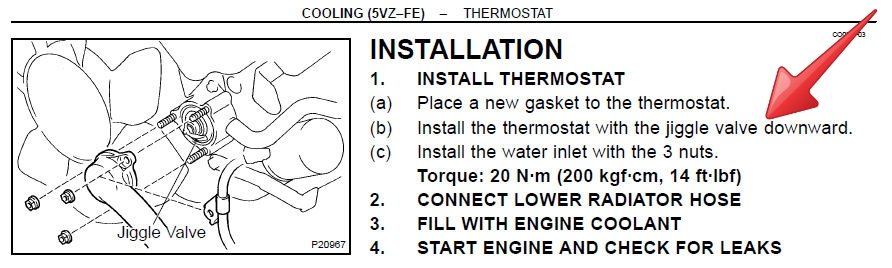

    Which way does the jiggle valve go? I'm seeing conflicting answers, some saying at 12 o clock some saying 6 o clock.

    Alright I've got 3 sources saying the jiggle valve goes in the 12 o clock position for the 2rz-fe engine. Looks like it's 12 o clock for both the 2rz-fe and the 3rz-fe. The 5rz-fe however goes in the 6 o clock position from what I found online. I didn't know this and reinstalled the thermostat in the 6 o clock position. Going to fix the thermostat position , burp it and then take it for a test drive and see how it does.

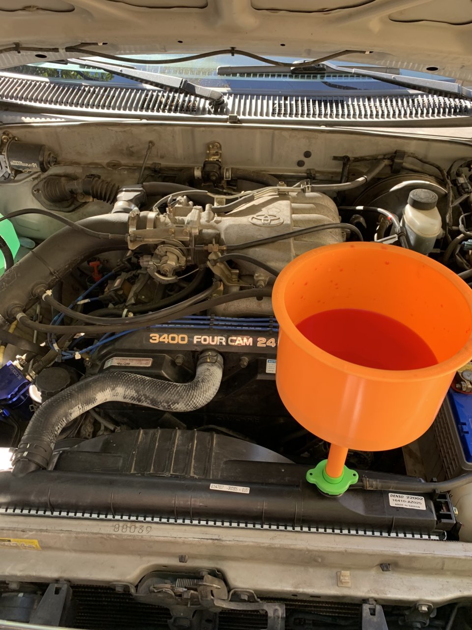

    Did you make sure to turn your climate lever to full heat? You want to circulate coolant through your heater core to ensure as much air as possible is out of the entire system. I’d also park at a slight upward incline so the radiator is highest. And using a kit to fill helps also.

    Tacomahound: the jiggle valve for the 3.4 V-6 is installed downward, at 6 o'clock: the image is copied from another user's thread that I saved a long time back.

    Took your advice and I got it to bleed a little bit more. It still overheats and the needle rises just a little bit past operating temperature. Could a wobbling AC clutch or faulty AC compressor be causing this slight increase in temperature?

    Thanks for that. I got the 2rz-fe so I had to search around for the correct position for that one
