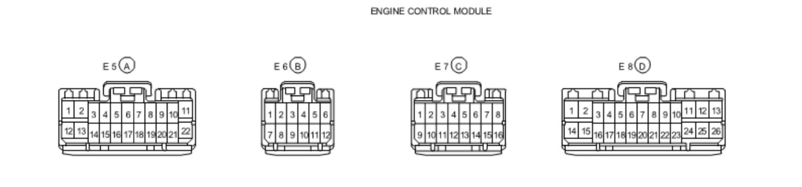

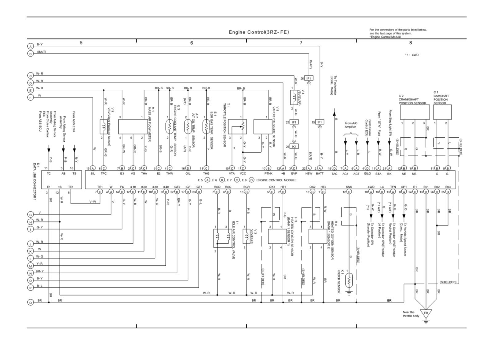

    E5 power to pins 2, and 12
    E8 Ground on 13, 24, 25, and 26
    I might have missed one or 2.
    That’s just a quick glance to get you started.

    Getting power and ground at all those pins. Also applied ground to the pins that are grounds and applied voltage to the ones that should be 12+ volts with my power probe and it made no difference. I can apply ground to the violet wire 4(a) and the check engine light comes on so i do know the light works. Still completely lost on this truck.

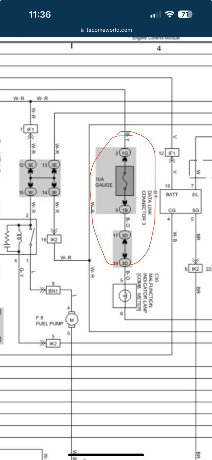

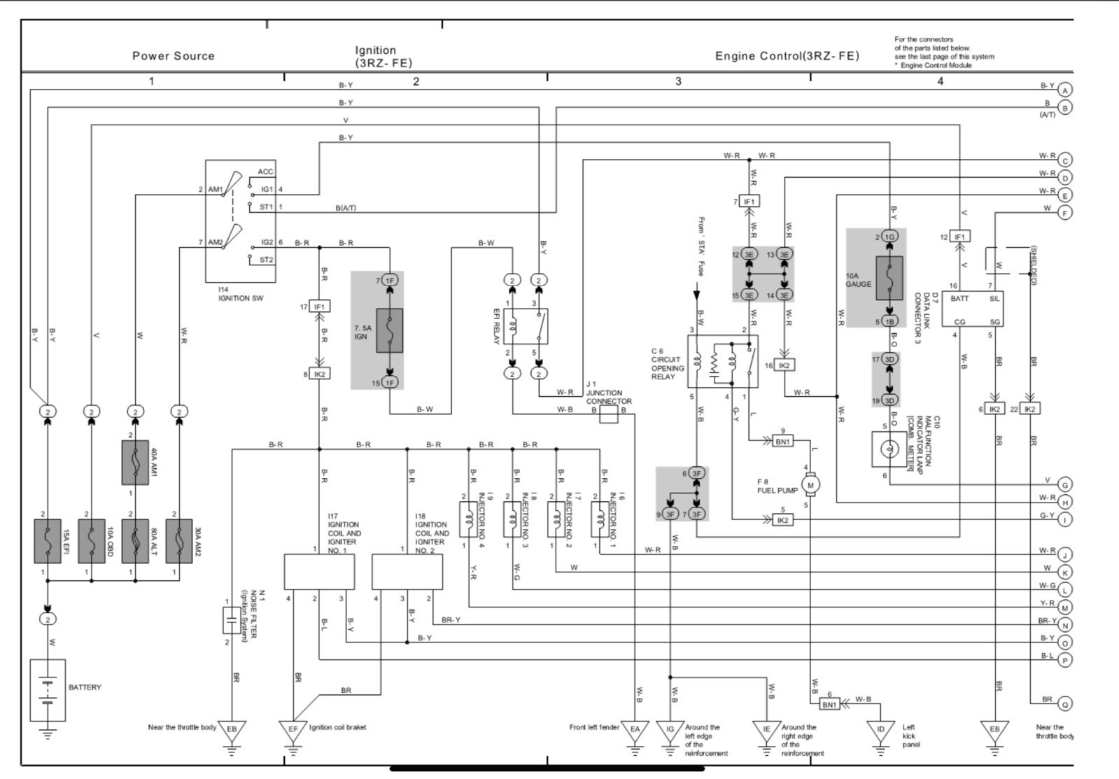

    Could it possibly be a problem with a junction like this i have circled in the screen shot of the diagrams you posted?

    If it were in the junction you circled, you would NOT have power to E5 pin #12 (ECM B+)

    What is this part of the wiring after it passes the 10 amp fuse just before the cel light

    If i apply ground to that violet wire going to cel light it will come on which makes no sense to me considering the violet wire has 12v at the dlc connector

    It is a connector.
    I will see if I have a location and pinout.
