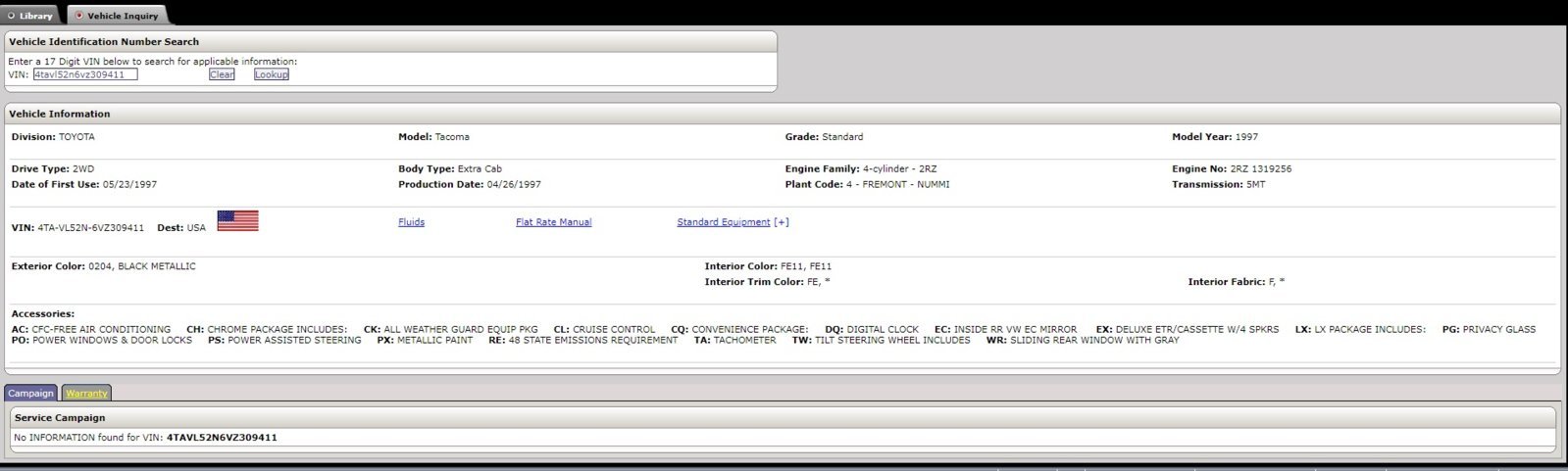

    Ok something screwy is going on here, it's a 97 but it shows to be a 2.4L (2RZ-FE) 2wd truck not a 2.7L (3RZ-FE) 4wd truck.
    I wonder if someone did a swap.

    This is not going how i expected lol i noticed the hood had 2.4 sticker on it where it shows engine info but never thought anything about cause i figured maybe hood was changed

    Everything on that picture describes the truck perfectly but it definitely has a 2.7 the block is stamped 3rz behind alternator

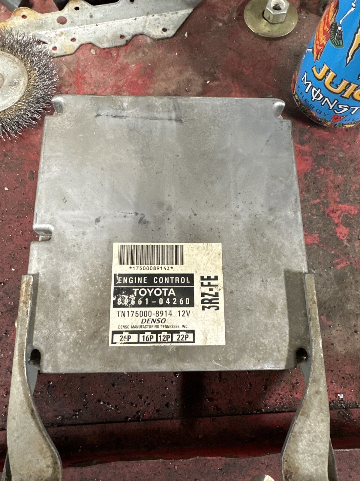

    I do have the old one i will post a picture it has the same exact numbers as the one i purchased

    Old one

    Well the 2.4L PCM has 3 connectors and the 2.7L PCM has 4 connectors so I have to assume they swapped the body harness as well?
