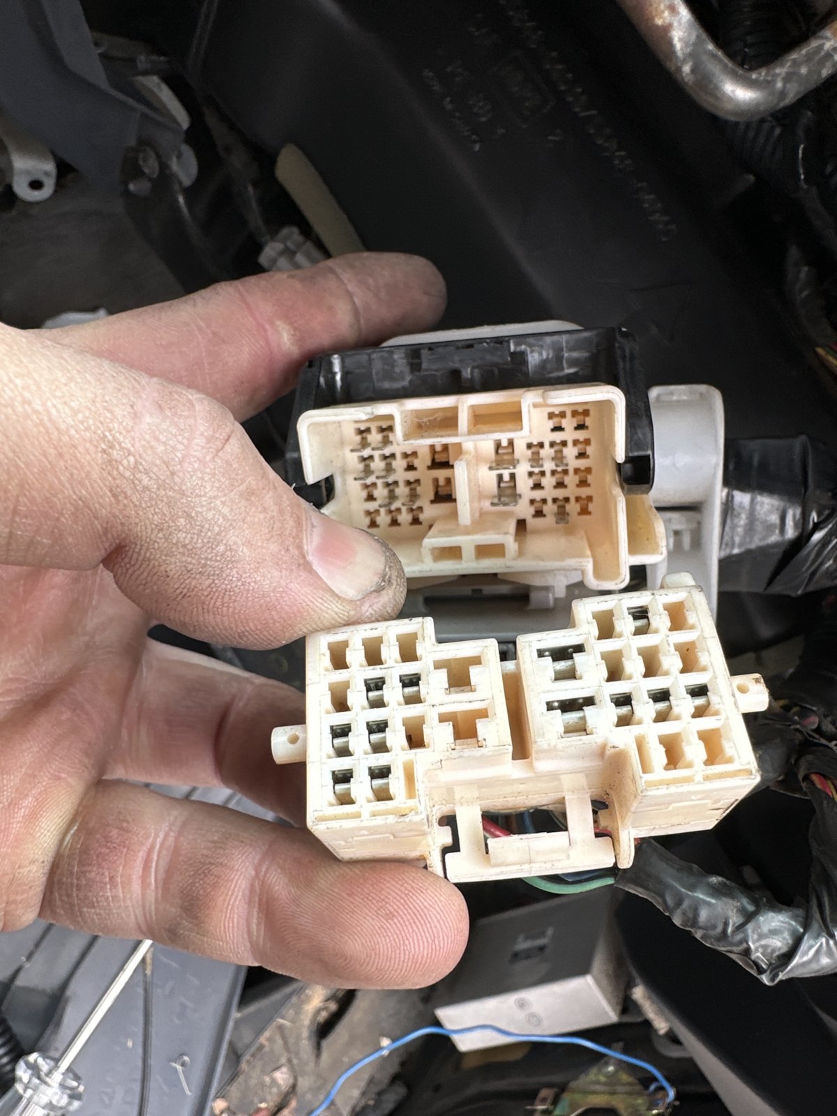

    If your on the correct wire then you have an open in the wire between the PCM and Circuit Opening Relay, there's an intermediate connector (IK2 Pin 5) that you might check.
    Still doesn't explain no CEL and no com though.
  20. Mar 2, 2024 at 10:42 AM
    #120
    Zach3rz
    Zach3rz [OP] Well-Known Member
    Oct 25, 2023
    #436209
    63
    Zach
    1997 toyota tacoma 2.7 3rz
    On the top row of the pins notice there is only 3 pins sticking out and on the plug that goes into it there is 4 and the 4th one happens to be the green and yellow
