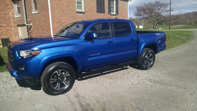

    Well OP...I drove mine today for 10 miles w/out the radio between 35-45 MPH and I didn't hear anything...No wind, No high pitched anything!
    I just picked it up yesterday...TRD Sport 4x2 DC SBIMG_20151105_134123721.jpg
