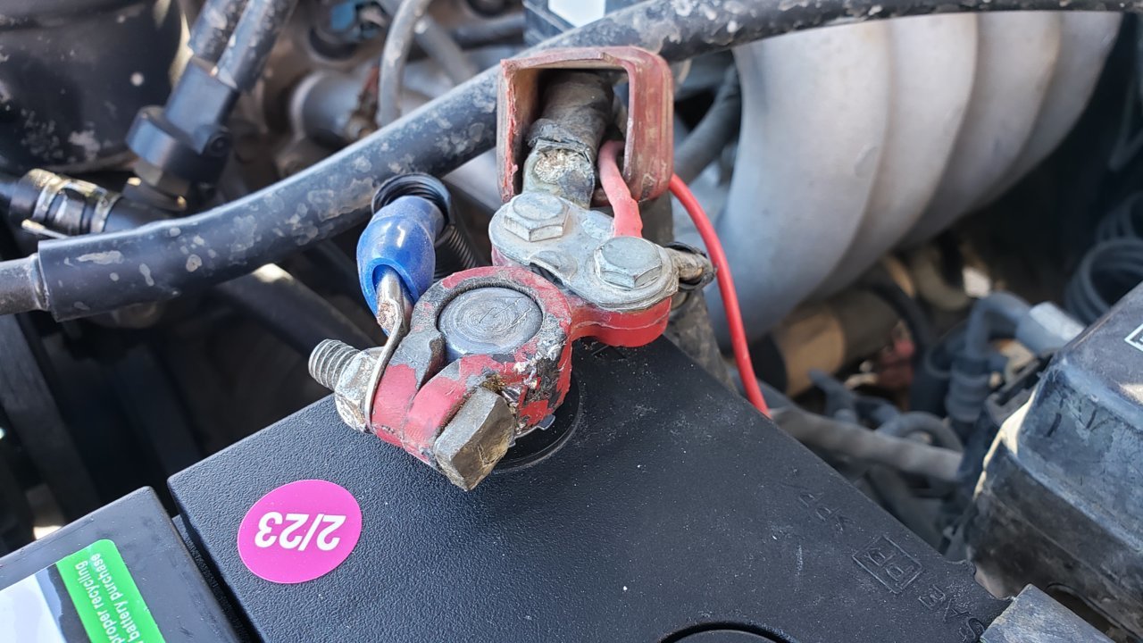

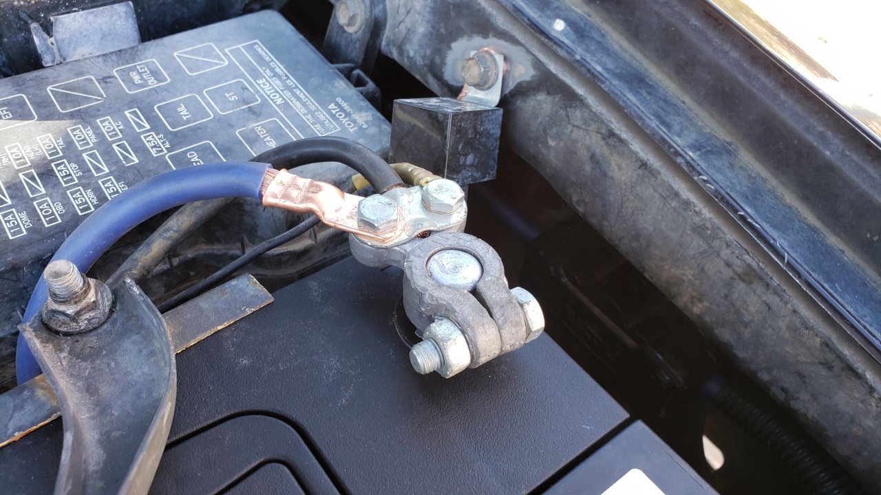

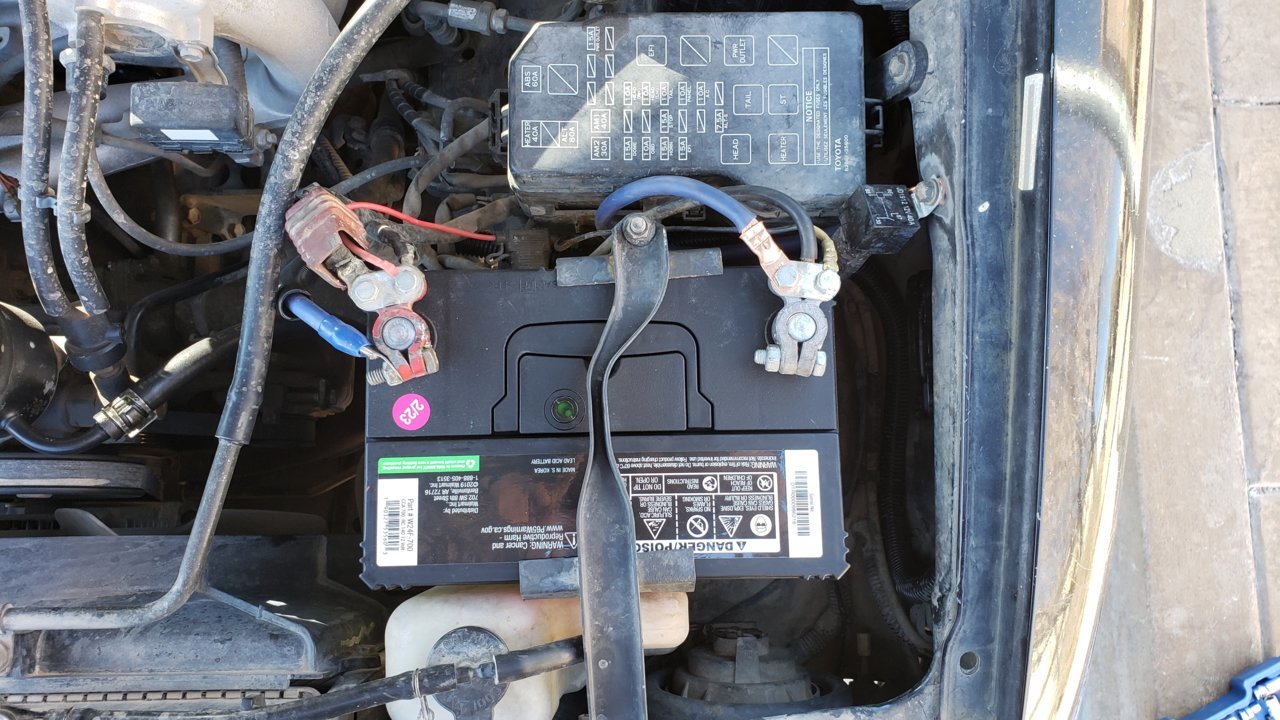

    Hello, I could definitely use some help on this one. Just got home this morning from a weekend trip. The truck started and drove home just fine. A few hours after I got home the truck didn't start.
    At first, the dash lit up as normal. But when I turned the key to the start position, I heard a click, then nothing. No dash activity or any more clicks when I go to crank again. Seemed to be a dead battery so I tried jump-starting it, but no luck... I then replaced the battery with a fresh one and the same exact thing happened.
    Iv checked a few of the grounds, but not all. Could that be it? Terminals are also okay.
    I'm really stuck on this one... any help would be greatly appreciated!

    Sounds like a typical bad battery terminal connection either from the terminal to the battery or from the terminal to the cable.
    Post a pic of your battery terminals.

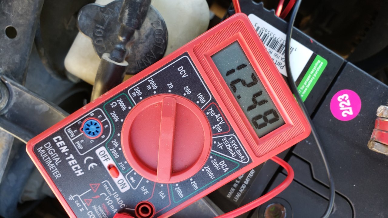

    Though I would double check the swapped in battery voltage as well.
    Then the original battery also.
    I had unseen corrosion on my AGM battery terminals they looked perfect to my eye.
    Pulled the Terminals gave them a good cleaning good to go.

    It was the battery terminals, both loose & corroded. The terminated ends of the +/- cables that connect to the battery terminal were pretty oxidized.
    I took them all apart, gave them a good sanding, and boom, starts like a toyota again!

    Yea those style cable ends are notorious for having bad connections, wouldn't hurt to smear a bit of grease on the connections before you put them together to help keep corrosion out.

    I would swap those terminals for marine Type that have the studs to mount your lugs on.
    Those terminals were always sold for emergencies to get you home and get things fix correct.
    Much to important to go cheap.
