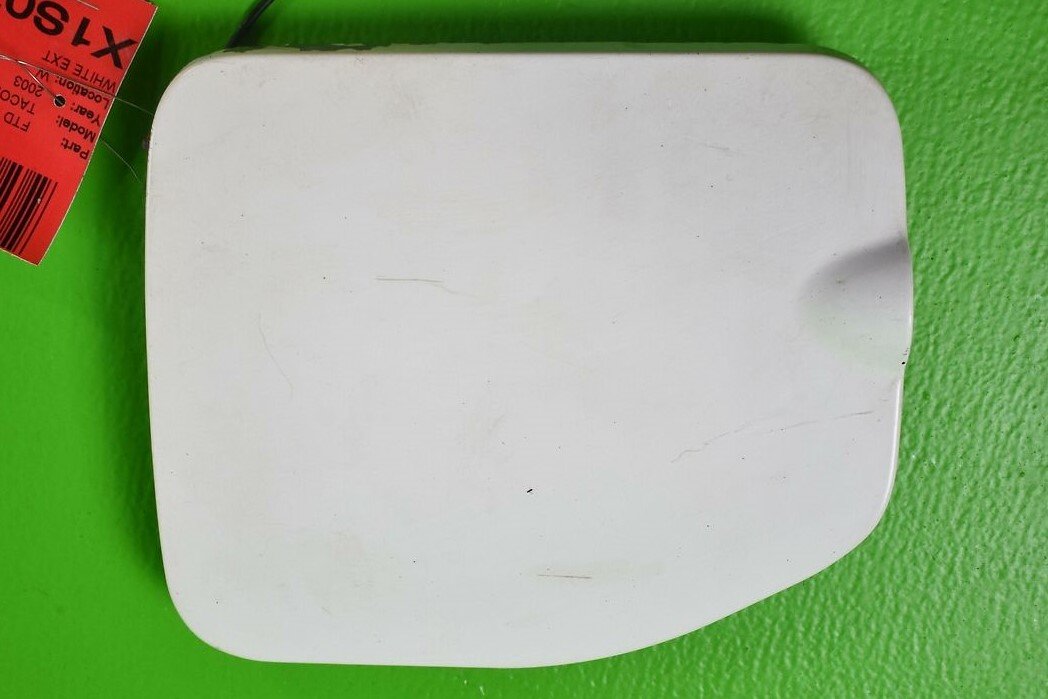

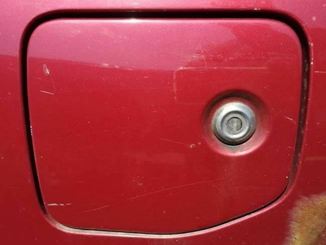

    As the thread title suggests, I'm curious if the size of the 98-00 lockable gas door is the same size as the flip version on the 2001-2004 model? Anyone have a couple to check against?
    I'm not a huge fan of the locking gas cap on the '01 I have, and I was considering swapping it, but didn't want to waste my money. Based on the pictures I've found, I want to say "yes, it is possible" but don't have the two parts handy to physically verify... I'll be around a '98 in about a week, but was hoping to get an answer before then.
    Any help is grateful! Specifically would like it if someone has done this or if they have both vehicle years that they can test?
    Thanks TW!
    98-00 Gas Door (Lock) VS. 01-00 Gas Door (Flip)

    You can swap them, you need the door and the plastic piece behind it.

    you cannot have the lock rekeyed. once you remove the face plate you won't ever get it back on. ask me how I know. I now have a door with a hole in it. The plastic bit broke, so it never locked anyways... would be nice if I could find a regular door in the same color! :)

    Like JKO1998 said above, the 98 locking fuel door won't lock without the appropiate fuel inlet box part# 77290-35020, (it has the catch that the locking lever on the door goes behind), the non locking just has a vertical clamp on the door that presses over a plastic stud. I've matched up the colors, by ordering one from a wrecking yard 1500 miles away, just check their inventory to find the right color truck and ask if its available, or ebay. If it has a scratch, a semi cheap way is use a Mothers PowerBall Mini that attaches to a cordless drill and the appropiate compounds. If you use a big buffer, you might burn through the edges. The fuel inlet box does not come with the small flat nose rubber door stops (Cushions) you might be missing one, it takes 2, part#90541-06058. And if you choose to put one together, the remaining parts and #'s: Fuel Lid 77305-04020 (comes in black), Cylinder Lock and Key Set 69058-35140, it does have the lever on the end, but not the retainer to hold it in the Fuel Lid. Retainer is 69581-13010.

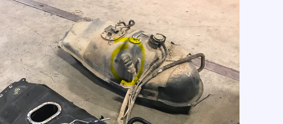

    I needed to drop my gas tank to replace the fuel pump and tried to remove the remaining gas in the tank and after 30 min of trying I gave up. The rubber connecting hose has such a curve and ridges that its impossible to get the hose in the tank it self. Ended up dropping the tank with 3/8 of gas in the tank. Not a fun experience.
