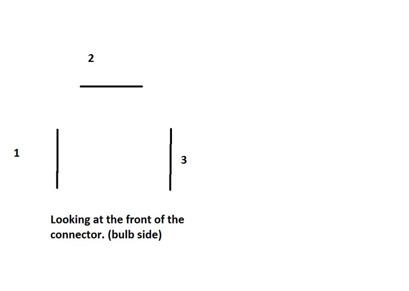

    Ok that's pretty fool proof headlight system. One side of your head lights isn't plugged in correct? I'm referring to the stock wiring harness to the new harness.
    From that unused plug measure the following terminals and post.
    All measurements will be measured like this.
    headlight switch off measure voltage from ground to each terminal and record it
    then repeat with lights on low beam and high beam.
    So you should have 3 sets of numbers.
    then the one or ones that never had any voltage. measure resistance to ground.
    post all those numbers. Yes battery connected.

    both of my headlights are plugged in. Pain in the butt to remove them to plug back in a oem bulb too. I wonder why my high bean option went away when I cut the wires though... I mean at least something happened, but not the desired outcome. the HID's use a single bulb for my low/hi beam, just like stock.

    I can unplug the oem bulb harness from the HID connector. However I don't have the tools or knowledge to measure electrical load from my oem bulb receiver
    Hope I don't come off as rude, it's just that I don't know how to do that. I was hoping not to have to go to a shop and dump even more money...

    Okay. Great going to grab it! What do I exactly do to measure? Stick the red reader into the three prongs on the OEM bulb receiver right? Do I need to do anything with the black reader? Also does the car battery need to be disconnected? I don't want to blow anything up, including me.

    Black lead to neg post of battery. Set meter on 20v dc. For voltage and then to ohms to check resistance. Test original harnesswith red test lead

    Do not set to ohms to check anything with voltage.

    Okay...confused now, sorry to be a pain, but don't know what I'm doing guys. Getting multiple suggestions, and don't want to offend. I also don't want to damage me or my truck further.
    The volt meter should be here by tomorrow night so I will be able to see all the settings and switches.
    Should I splice my wires, that I cut on the DRL Relay harness, back before testing the OEM headlight bulb plug?
