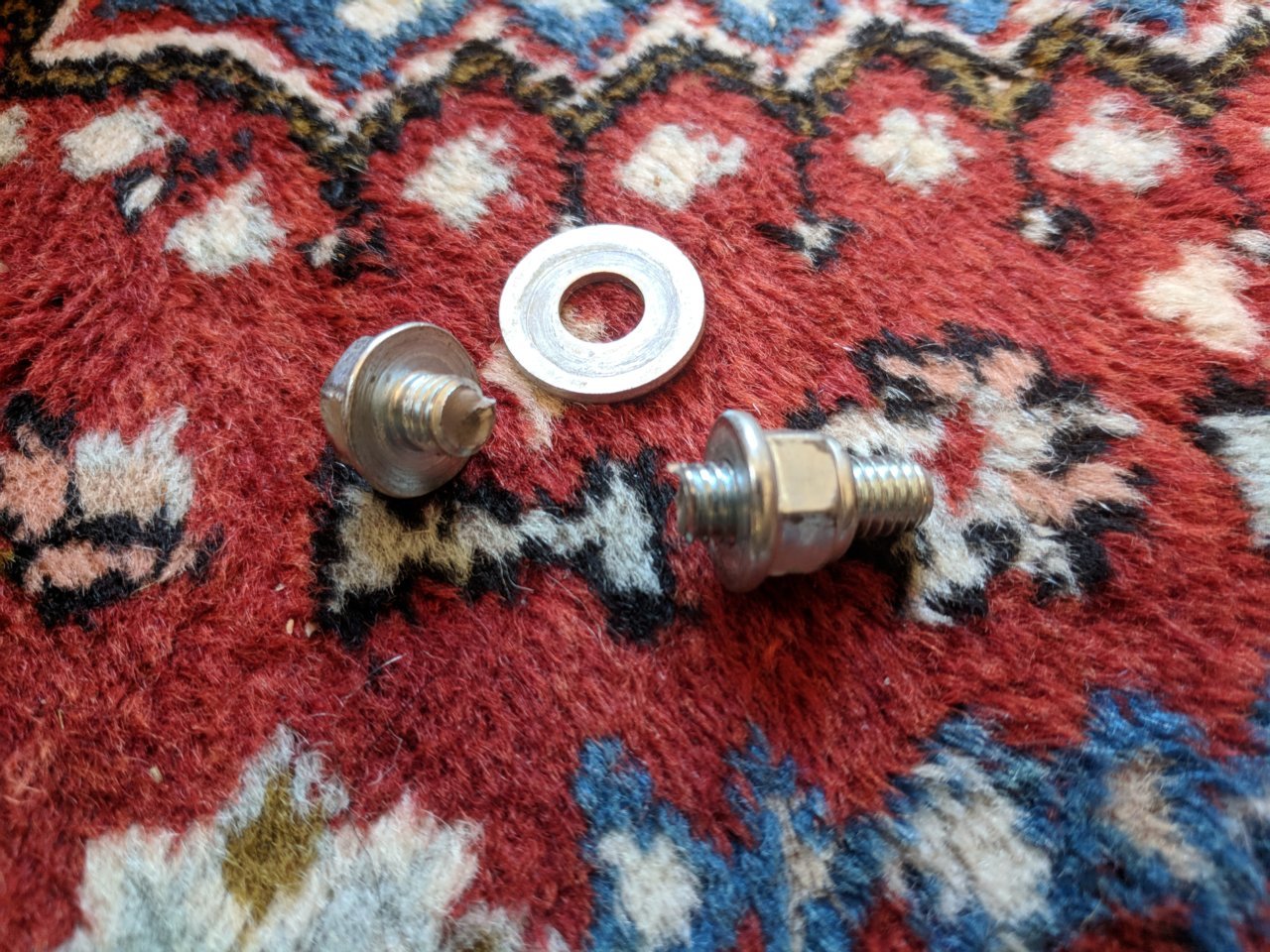

    LCA bolts were a little under the 100ftlb so I tightened them up. They weren't super loose but that could be them.
    However, even though I was extremely skeptical I checked other stuff and lo-and-behold, a cross member I added as support for my transfer case skid plate was a little loose. I tried tightening it down and blew the bolt completely off instead. Apparently it was either not made for 70 ftlb or I was doing something wrong :)
    Anyhow, NOISE GONE after those two things! Thanks guys, I never would have checked the cross members for sure. Really appreciate everybody's help and input, this noise had me a little freaked.
    B.
    P.S. :worthless: so here's the one casualty:

    That little bolt not made for 70 ft lbs, maybe half that.

    That sounds about right

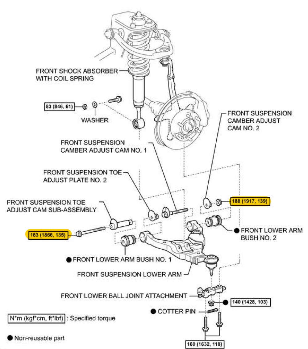

    For future reference for anyone needing to torque lower control arms, they are much higher torque on 3rd gen than 2nd gen. 2nd gen was 100 ftlb, while for 3rd gen it is 135 ftlb for the front bolt and 139 ftlb for the rear.
